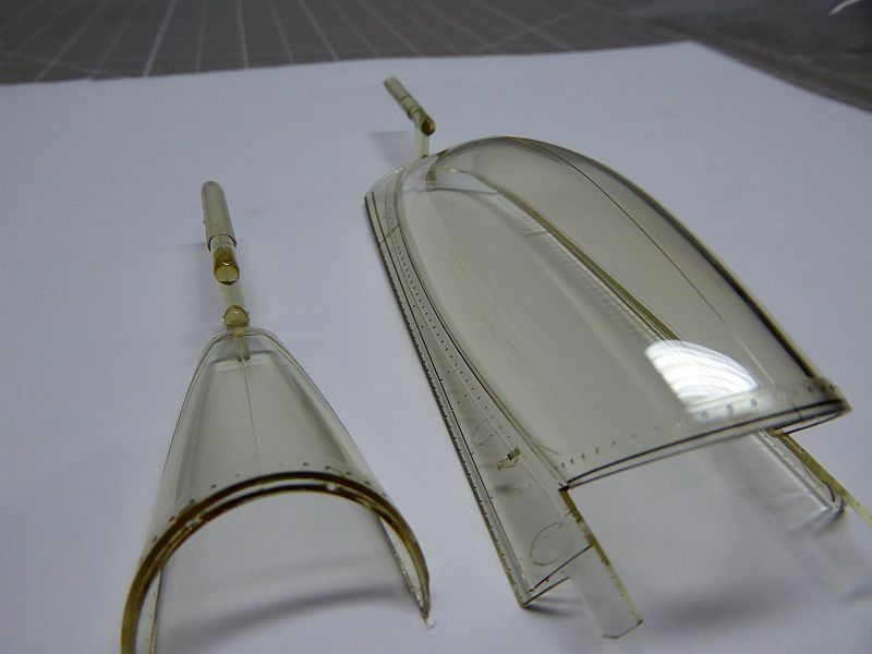

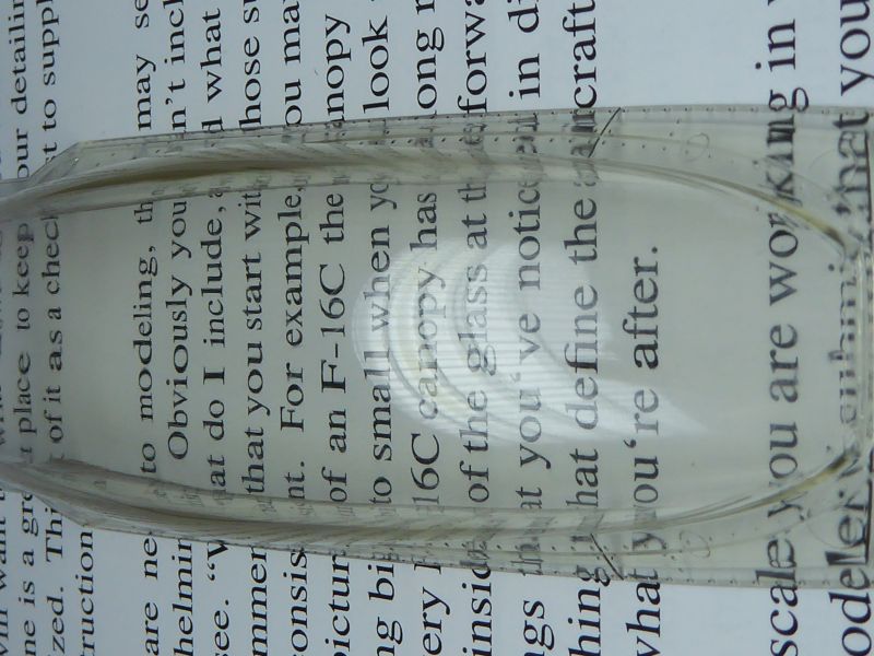

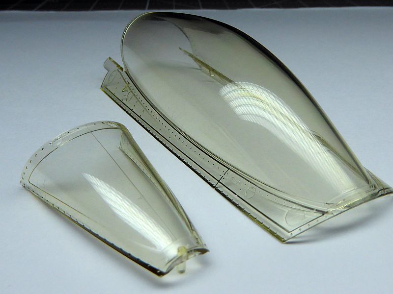

After ordering a set of micromesh pads off of ebay I thought I would start with the cockpit. Throwing caution to wind I went straight in with the tinted cockpit I was going to use BigGrin
So, I kicked off by wet sanding the seem with 3600 grit micromesh and slowly worked my way up to 12000.
I then did a 3 stage polish using Tamiya polishing compounds to finish it off.
I surprised myself with the result, took a lot of time mind you, but absolutely well worth the effort. Just the little rear glass part to do now BigGrin
Some pictures to show the finish, the first picture shows how noticeable the seam actually was. The cockpit glass is the only real niggle I have with this kit so.
Also bear in mind that it hasn't been future'd yet Cool

BigGrin Nice start Dave and the micromesh worked a treatCool
#27 Posted : 15 January 2017 22:26:55
Thanks guys, I was really nervous when I started sanding it, but little by little it smoothed out.
Thanks for that link Tony, I will check out the dip. My gloss coat of choice is Alclad Aqua Gloss, it only comes in a small bottle but it goes a really long way and dries hard as nails.

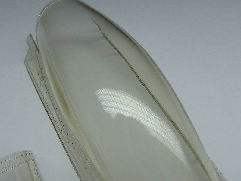

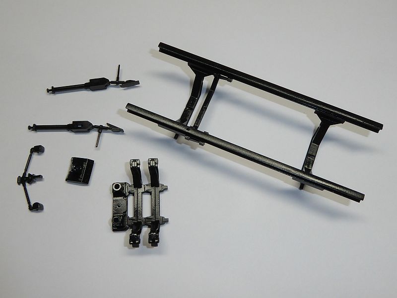

Thanks all for your comments BigGrin That micromesh is amazing. I ordered some AK Interactive Gauzy to dry dipping the cockpits in, now the parts that dried correctly are amazingly clear however there are some areas that have some imperfections where it has dried with a little bubble. Im going to need to gently sand them out. After having tackled the cockpit seams Im now very confident I can sort these bubbles out with no issues, then a quick redip and they should look pretty nice indeed.

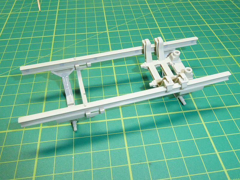

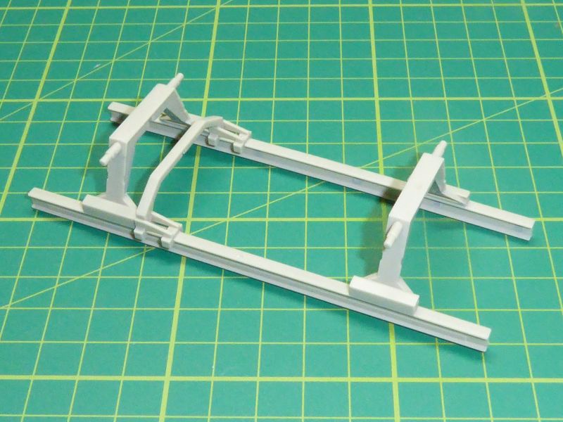

I have progressed onto starting on the dolley that supports the engine. There are lot of parts that make this up. The main colour of the dolley is IJN green however I have undercoated with Vallejo Gloss black primer hoping that it will help the metallic parts really pop.
