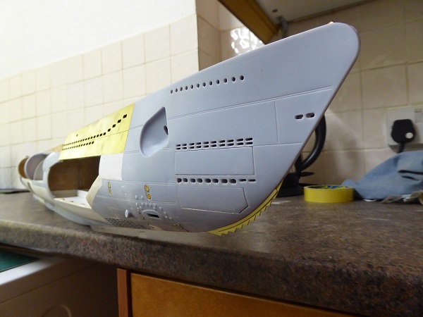

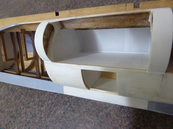

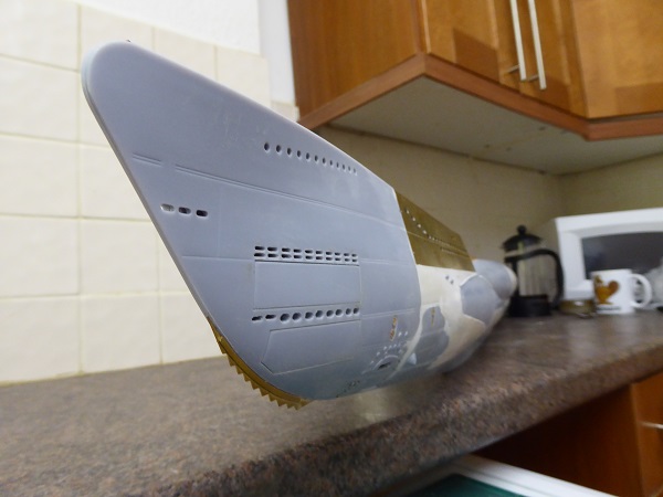

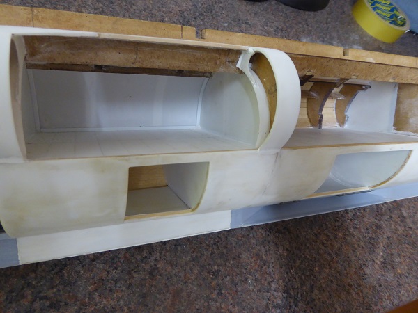

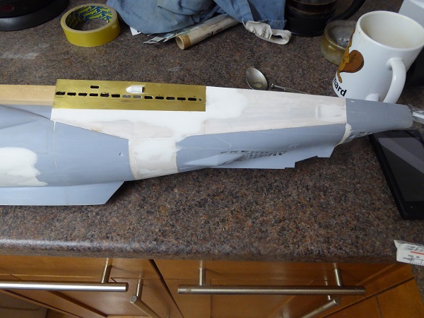

Attached are some pics taken in August showing the bow fixed in place, port side hull and port side stern.
#31 Posted : 09 December 2016 13:34:56

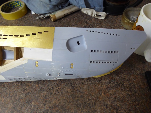

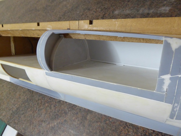

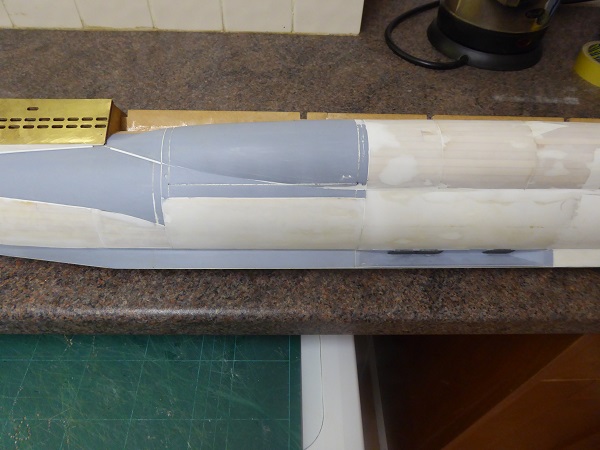

These images show the profile of the starboard saddle tank with 'scalloped' cut-outs.
Regards, Phil W
