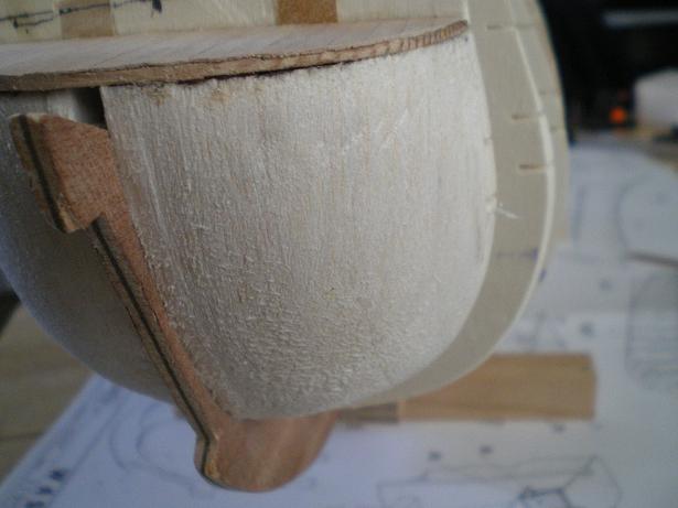

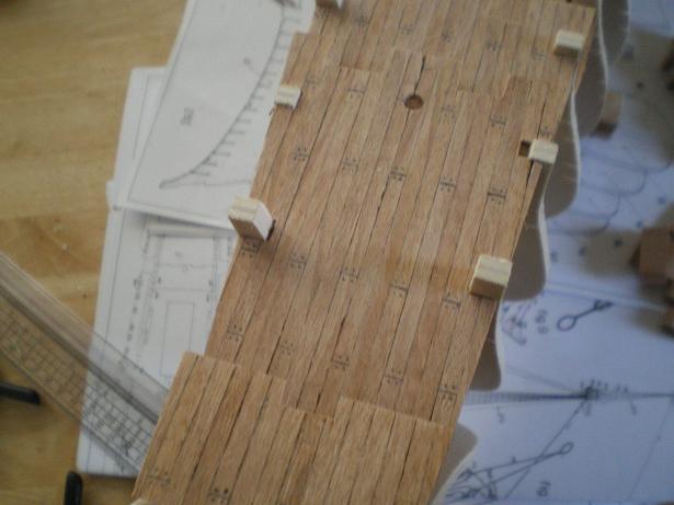

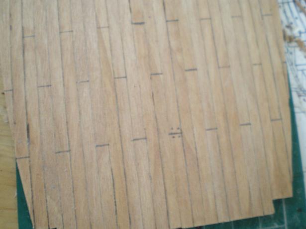

A small update on the Wasa

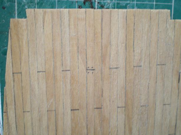

The bow hasn't got bulkhead formers as its made out of a block of wood that needs carving I had a go but it's as hard as rock so I have replaced them with balsa fillers as its easy to cut and sand Cool while they dry I started planking the main deck. Iooking at the reference pictures I have the pattern looks a bit random with a very strange shift Confused it looks like bodgit and scarper has done it LOL it starts off OK but gets a bit confused as it goes towards the stern Confused
I will have to see if it looks ok as in a small scale it might look naf Blushing
BigGrin cheers for looking rgd Martyn

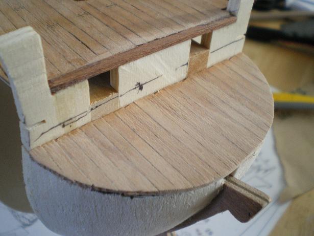

#30 Posted : 25 October 2016 12:23:27
BigGrin Hi all just a small update Cool
I have finished planking all the decks Cool

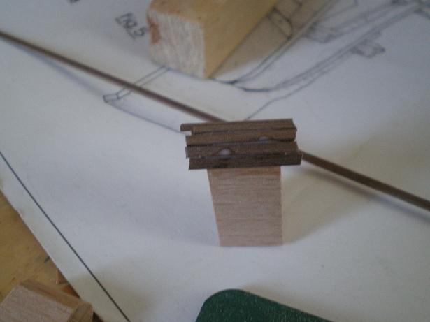

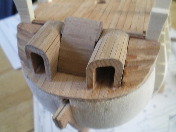

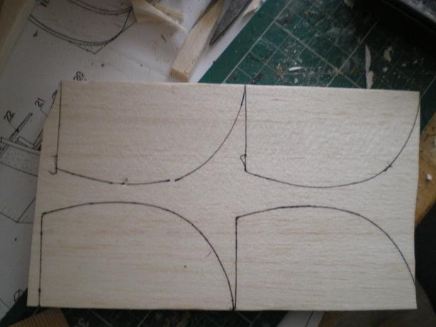

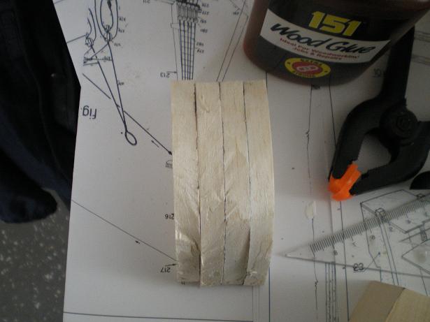

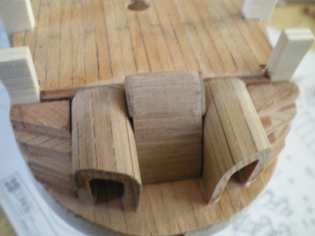

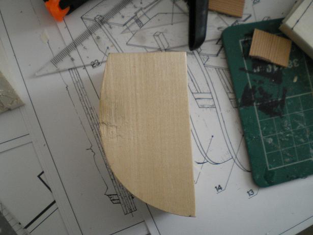

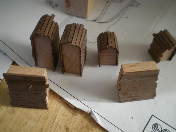

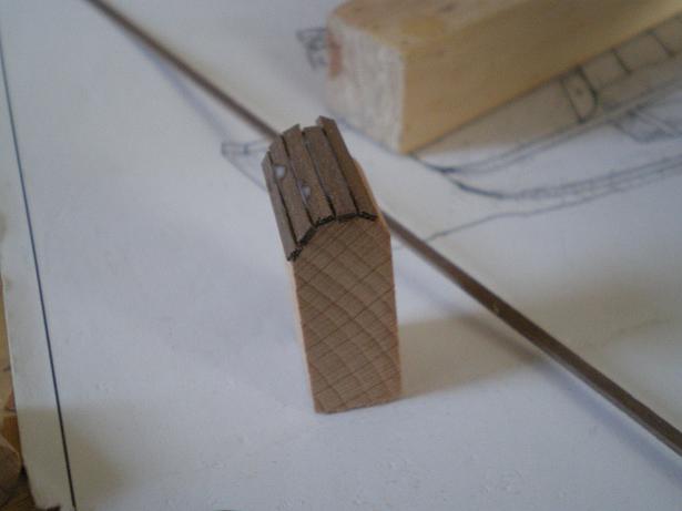

Next step carving the bow fillers to get the right profile I exchange the wooden ones and made ones out of balsa as its a lot easier to carve and sand Cool once finished I made a bow deck out of 1.5mm ply as there wasn't one in the kit . I had to lower the bow formers by the thickness of the bow deck so it stayed the right hight . Once fitted and planked next job the doors and deck furniture.
These are preformed but need sanding and then planked with 1+2mm walnut strip
The ones on the bow where fitted first and while they were drying started planking the other ones for the different decks Cool
Next up trimming and sanding the door fittings Cool
Thanks for looking rgd Martyn

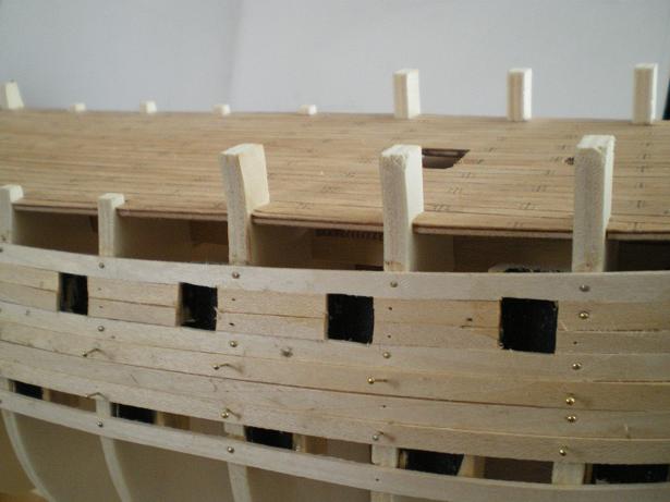

#31 Posted : 08 November 2016 15:48:14
BigGrin A bit more done on the Wasa Cool
I have fitted the cannon supports to the bulkheads these are C shape pieces of wood cut to 20mm to go between the planks . As you can see I have painted them black Cool
More soon

The bulkheads are marked with a notch so you can lineup the planks trouble is that they are not in the proper line for the gunports so I have used the one to one plan for marking them out Cool

Once the gunports are finished its on to planking the rest of the hull then it will definitely look like a ship Cool
Cheers Martyn
