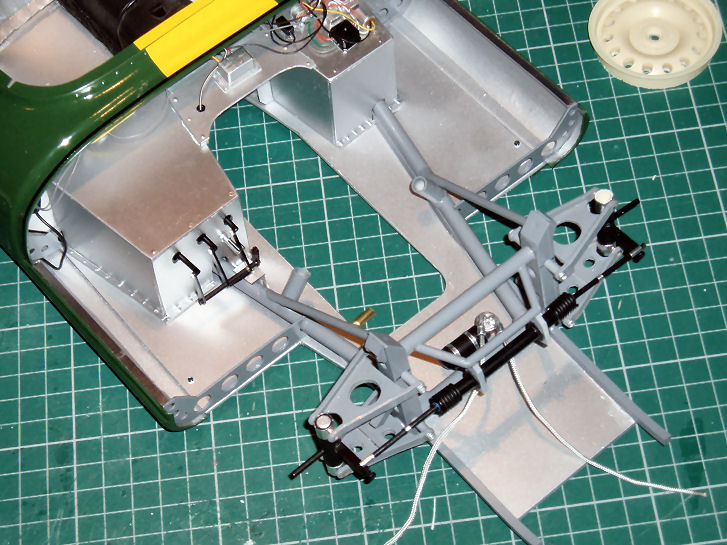

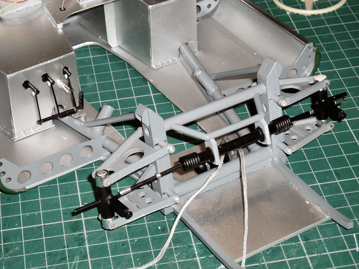

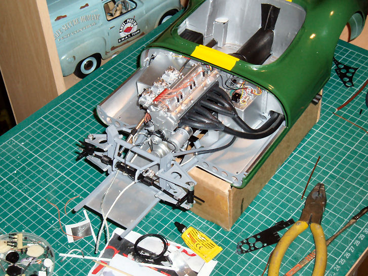

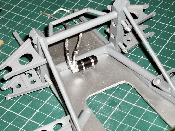

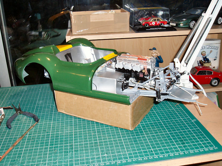

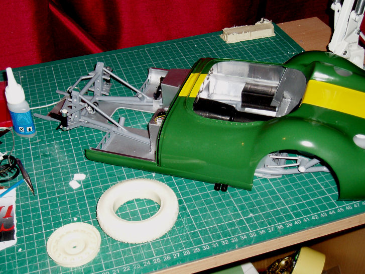

I've built up the oil filter and fitted it at the front and now have added the uprights and steering rack.
The ends aren't attached yet as that will depend on the upright position once the wheels are added.
Also added some wiring to the engine.
Roy.

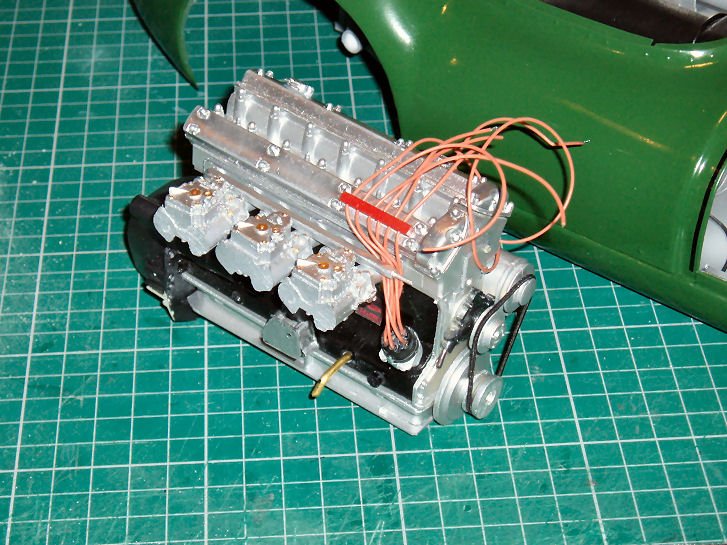

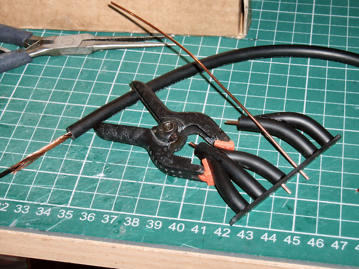

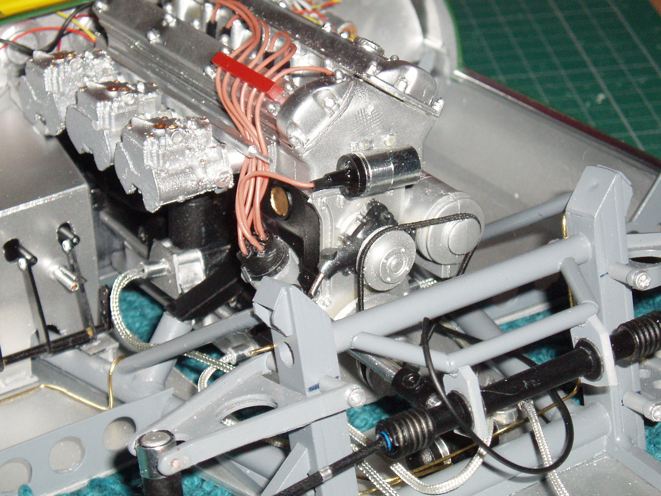

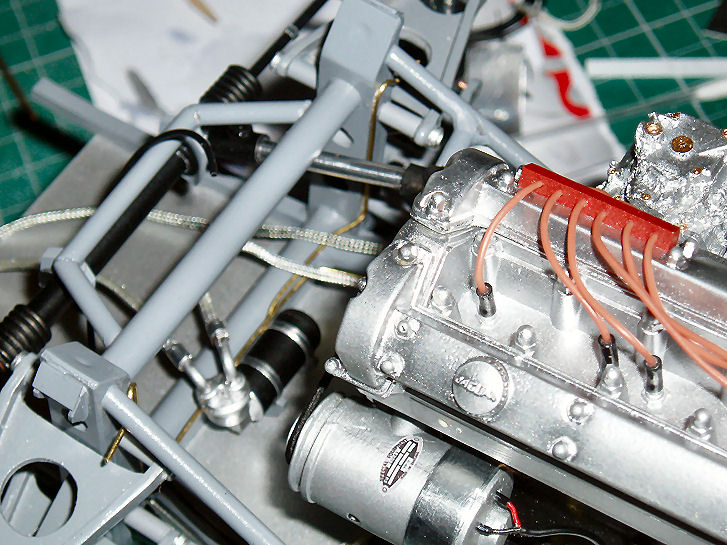

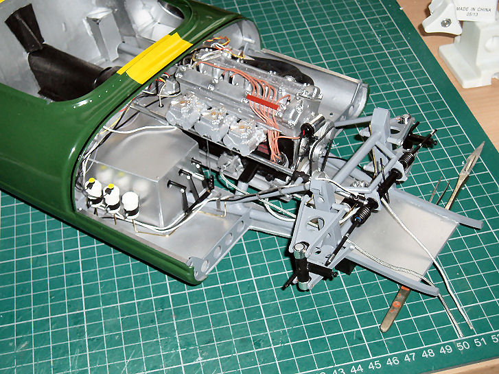

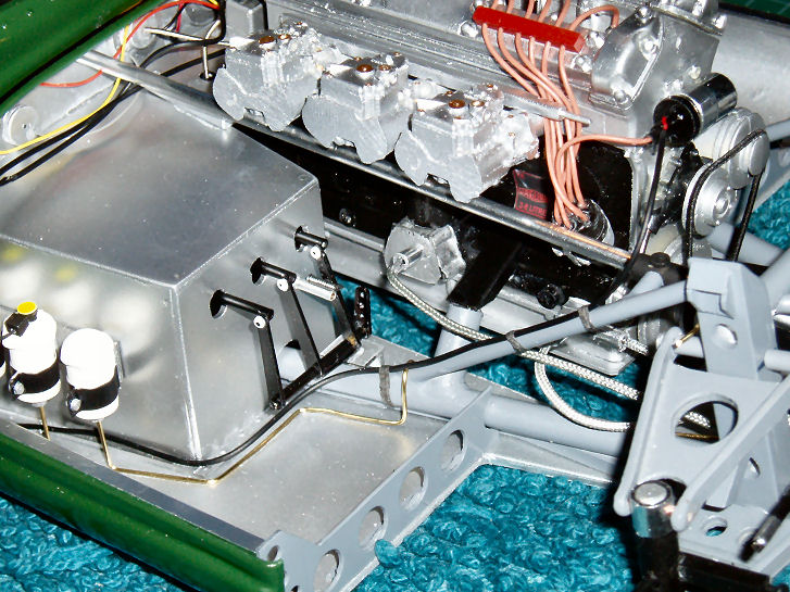

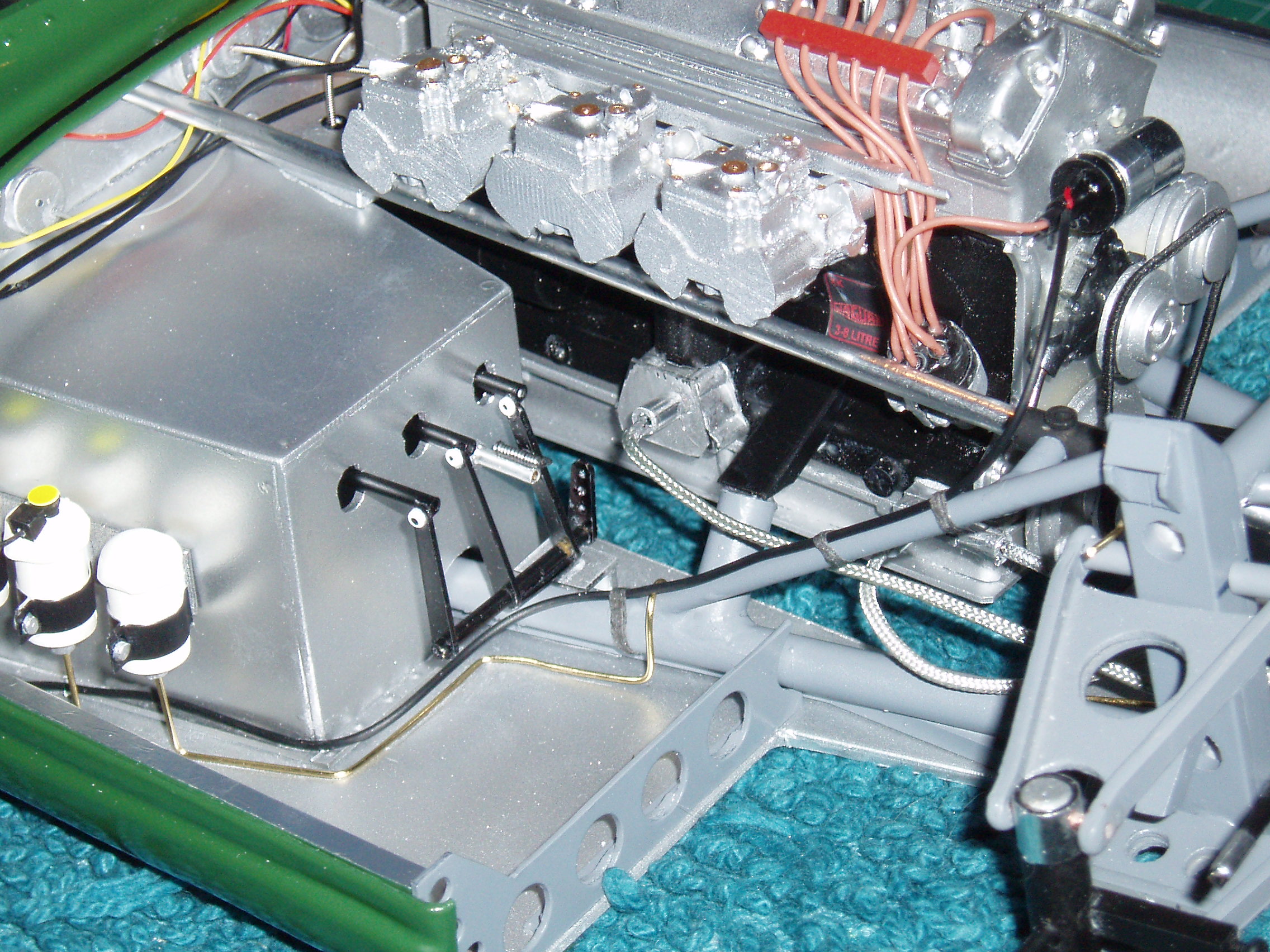

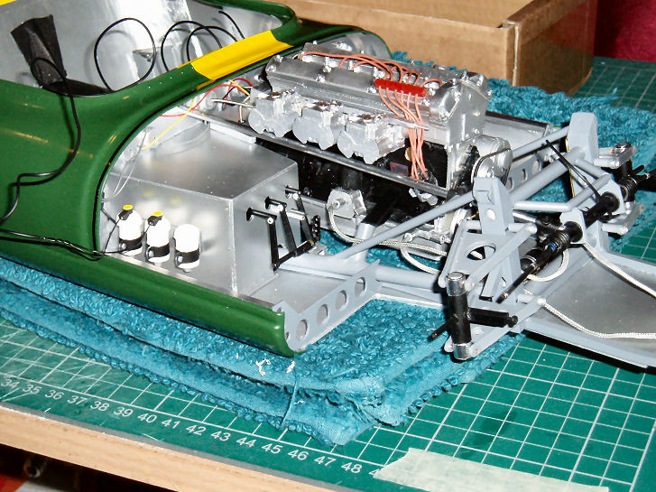

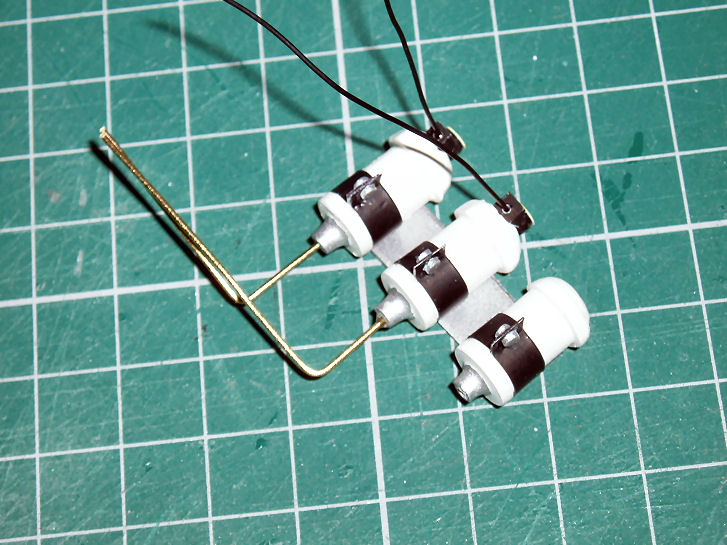

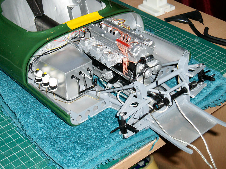

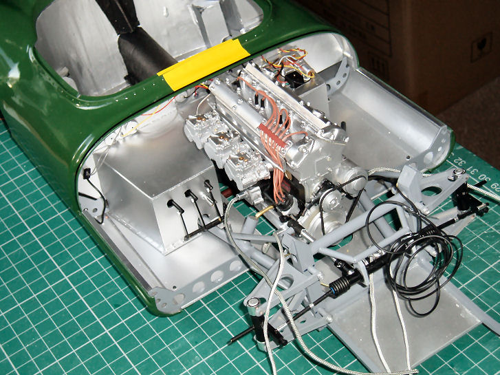

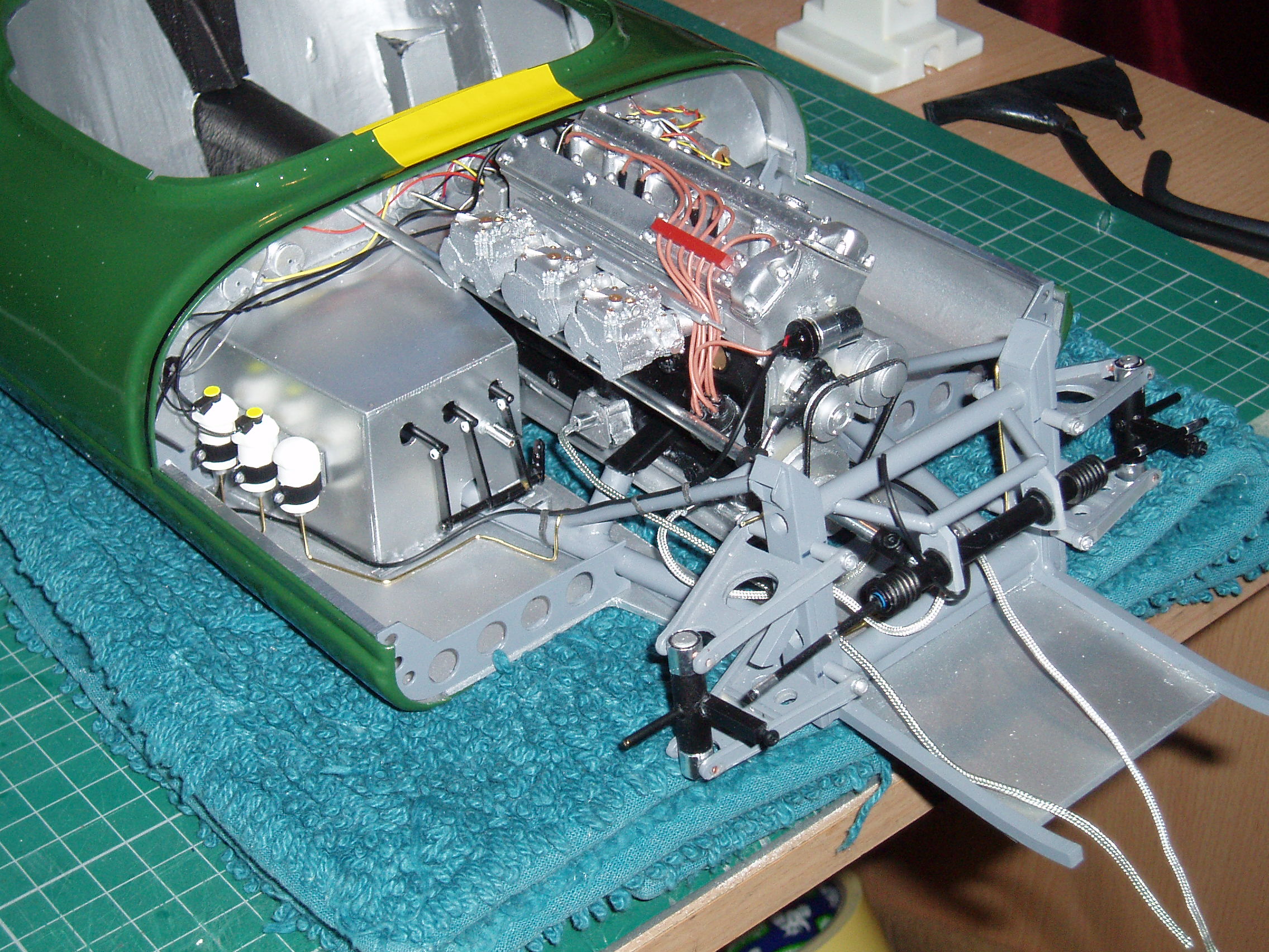

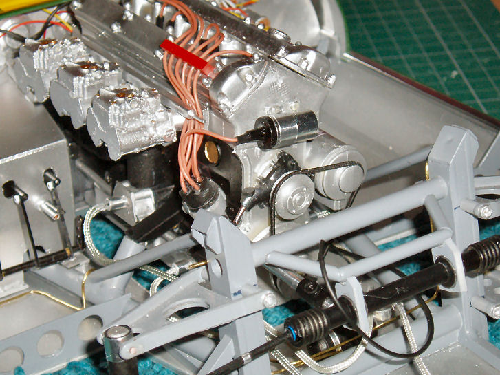

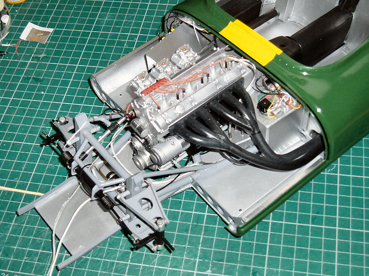

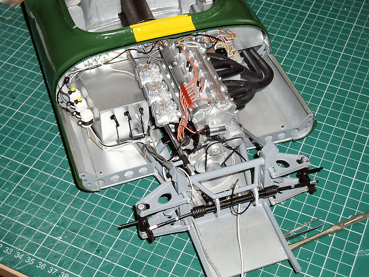

Well, the engine is now in and the exhaust fabricated and fitted.
As with all my scratch cars, the manifold and pipes are made from old microphone cable with copper wire fed into the core.
It can then be cut, glued together with C/A and bent into the shapes required. Quite simple really.
Lots more 'plumbing' now also added and the fluid reservoirs have been made, fitted and connected up.
Radiators next, plus a lot more fiddly stuff on the engine...
Edit... not sure why, but some of my pics are coming up as file attachments???
Roy.

Sorry - a few more pics as I realised why the 'file attachment' ones weren't showing - too big!
Now resized.
Roy.

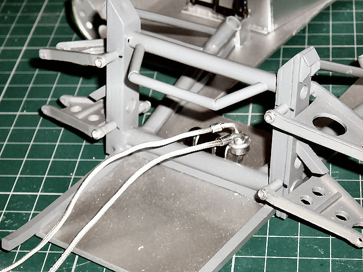

Could i please ask is that braided "cord" you have used in the engine section the tamiya made product?
#34 Posted : 17 November 2016 00:33:48
Posts: 5,058
Points: 15,320

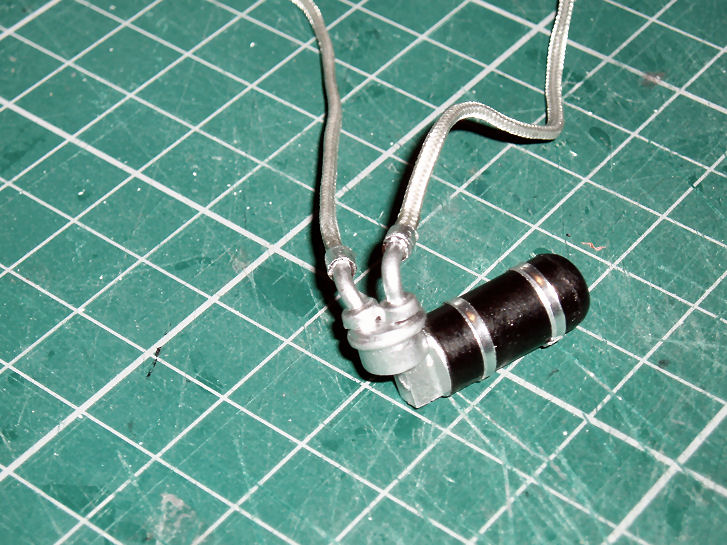

...don't laugh...
The braided lines are just silver Venetian blind cord in thick and thin variations.
Any fabric shop sells it at pence per metre.
Roy.

roymattblack wrote:
...don't laugh...
Roy.
Well that is a surprise. Not sure if the tamiya stuff is new but seems to appear on everything i read or lookup on various model shops.
Your version i would never in a million years have guessed was blinds cord. Its looks very good indeed.

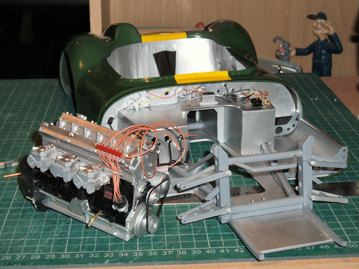

Many thanks all you guys.

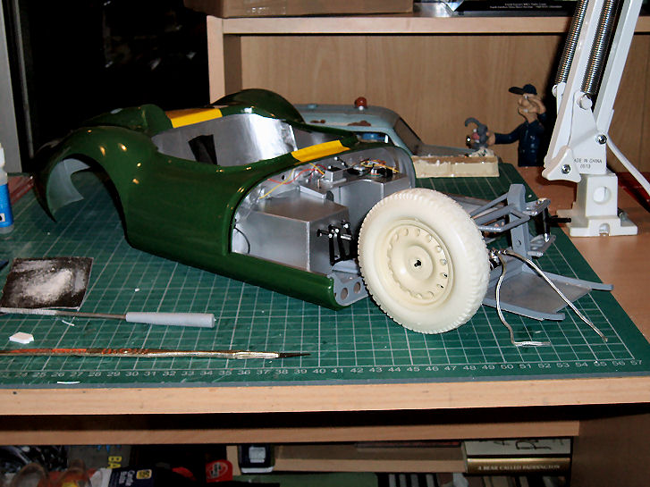

The engine area is getting there.
Radiators, header tank and plumbing, carb linkages and fuel lines, then front wheels, shocks/springs, torsion bars...
On we go.
Roy.

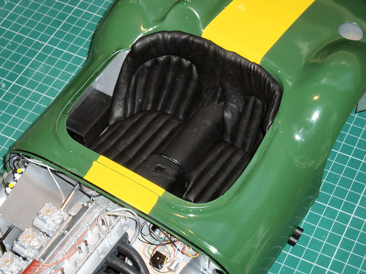

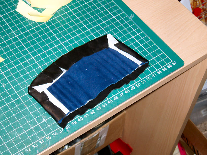

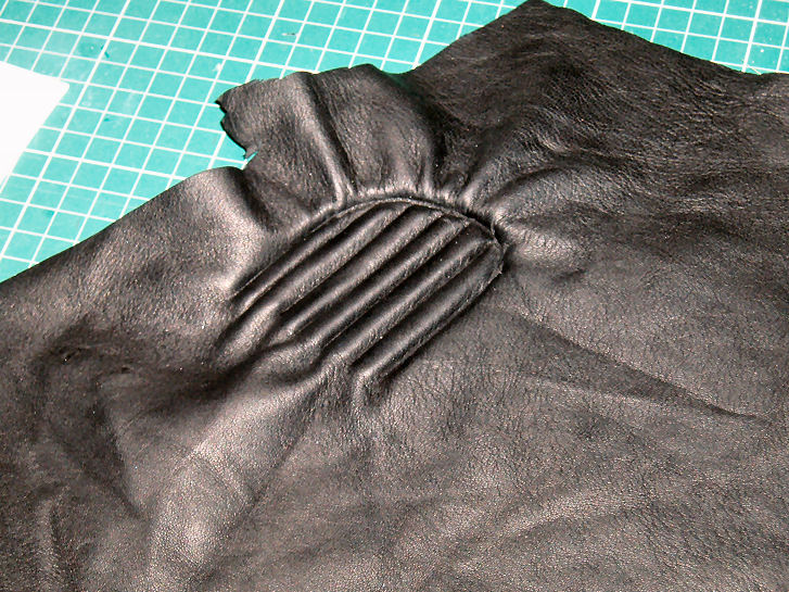

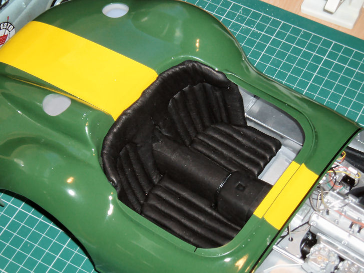

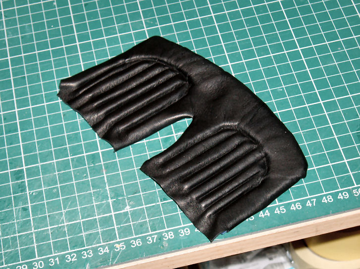

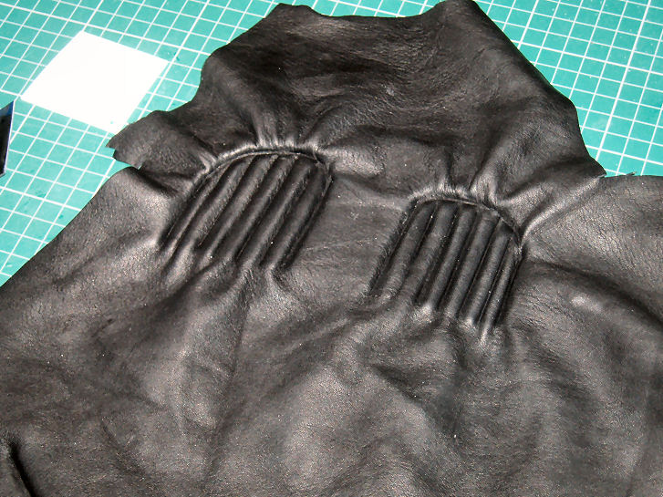

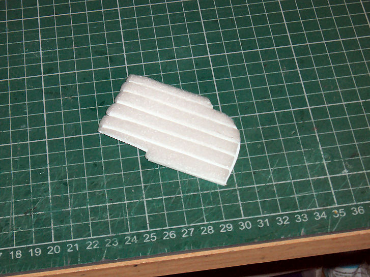

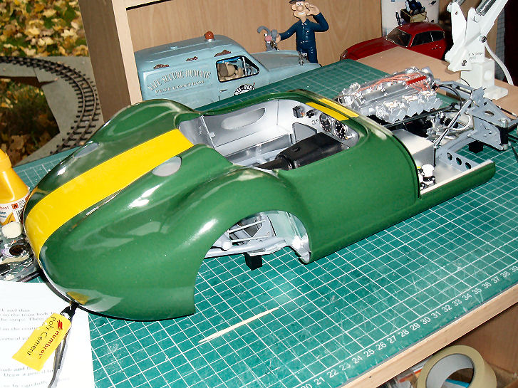

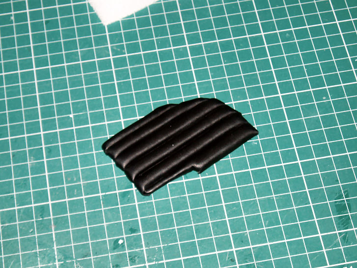

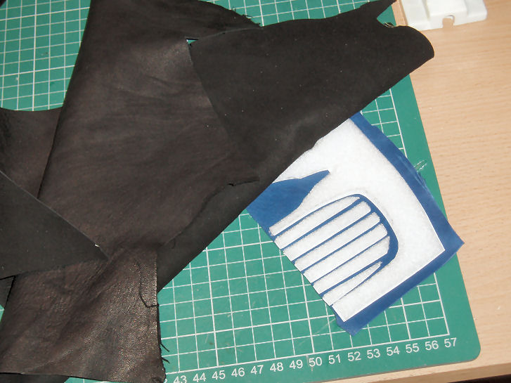

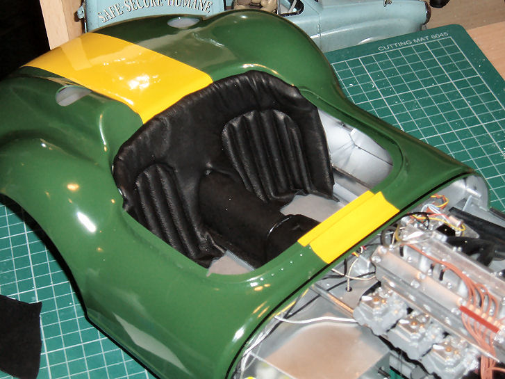

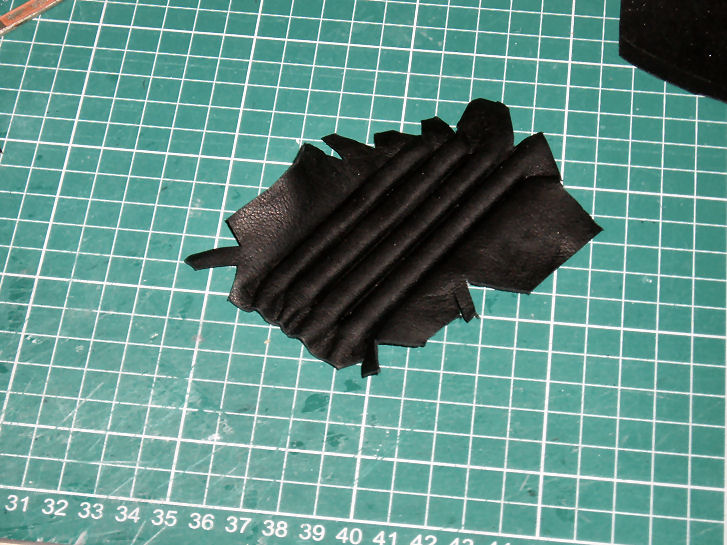

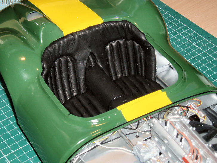

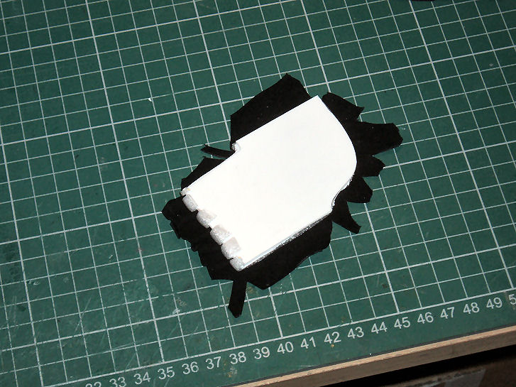

Well, the car now has seats.
They do look pretty odd, but they are the same as those in the car I'm basing the model on which is currently awaiting delivery at the Lister factory.
All good fun so far.
Any questions - please ask.
Roy.
#39 Posted : 19 November 2016 20:35:11
Lovely work on the seats RoyThumpUp
#40 Posted : 19 November 2016 20:48:01
Seats look really good, nicely done!BigGrin
