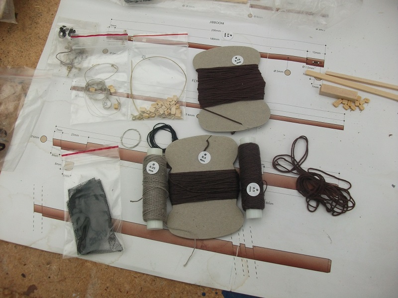

hi folks, could any body tell which is which in these rope sizes in issue 88/89 the labels fell off and i sort of gauged these. I want to finish off the bowsprit and just wanted to make sure the rope is right.
thanks for any input
rob

Hi Rob, very difficult to tell by the photos but I would say the black thread on the spool looks thinner than 0.5, the top black thread on the cardboard looks thicker than 0.15. Natural looks right at 0.25.... Having a look at the Official Video Build at the two stages you mentioned may also help you identify the correct threads...
Hope this helps

The little sticky labels do tend to fall off best to write the sizes on with a felt pen as you get them.
You can probably work them out using a ruler especially if it has half MM. Increments

Good tip Jase, have done the same myself using a ruler and you can work it out.....

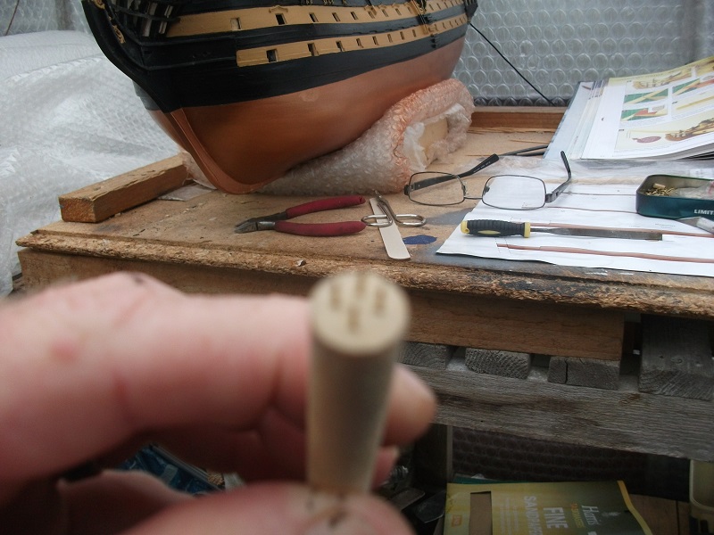

Hi folks!.

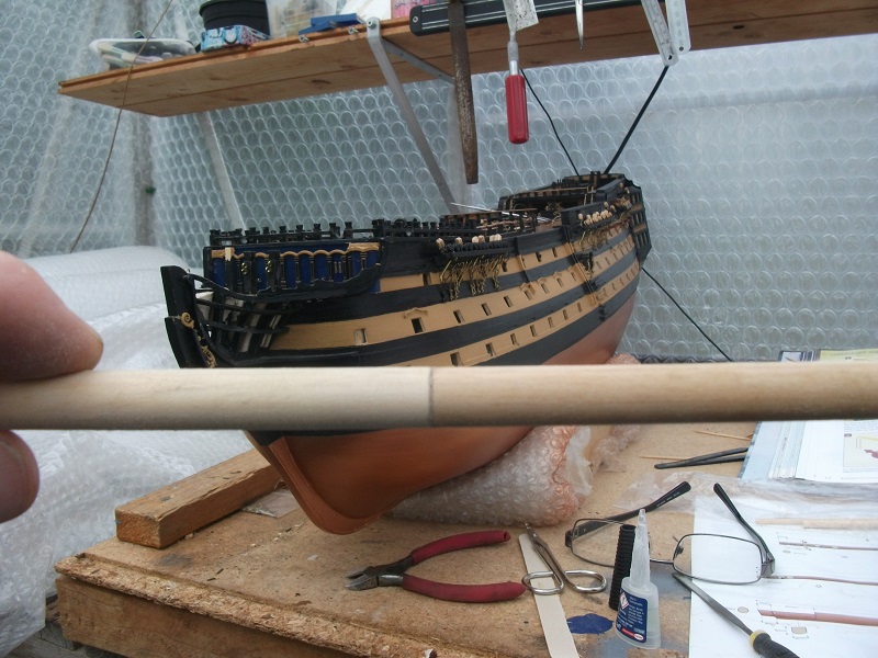

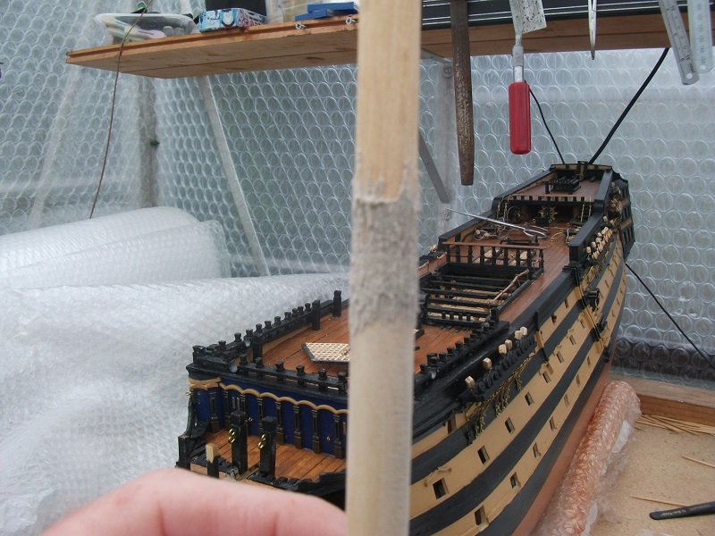

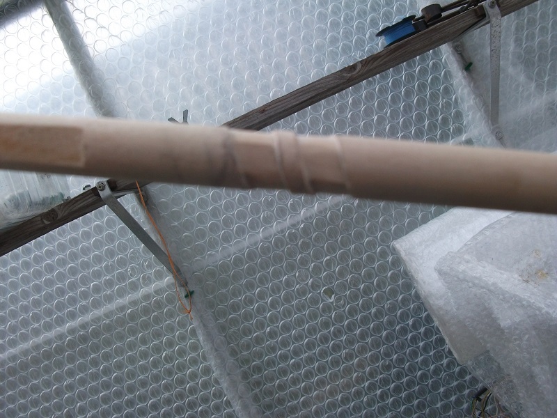

Made a mess of things on the bowsprit, I spiralled the cut as you can see(numpty)
to save me ordering a back issue I just used the small one used for testing in previous issues,nailed and glued it together, it was a strange one to get the cut line straight.
Anyway has anybody used beeswax for the shrouding instead of pva to cover it or does it not work as it should, just curious.

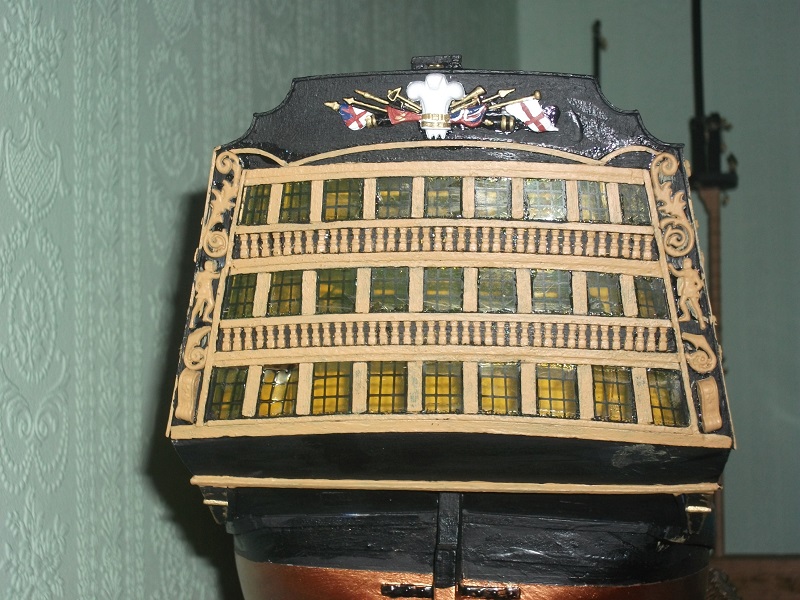

latest pic of painting aft,needs another coat but getting there,not sure about the black centre line though.
cheers for now
rob

Excellent fix you have cone up with there.
Its all looking very nice indeed.

Well done Rob. I shall remember that in case I need it. Thanks.

Good work on the bowsprit, once painted the join shouldn't be noticeable. As for beeswax, I use this on all my rigging lines. Run the line through a block of wax a couple of times and then run the line between your thumb and forefinger. The heat of your fingers softens the was so in penetrates the rigging line. You will then find the rigging line to be less hairy and a lot stiffer, easier to work with... I still apply diluted PVA to seal any of the knots though.

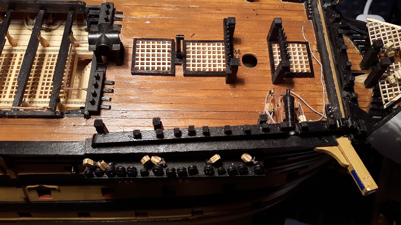

confused again, going to put the cranes for the hammock nets but the cranes seemed too big on the fore deck for my build. photo enclosed. how on earth do i fit the cranes when the ledge is only about 4 mm on my ship and the cranes are 7mm,do I extend the platform making it wider?????.
please help.
cheers
rob

Hi Rob, looking very nice indeed. The cranes actually do sit beyond the edge of the ledge so what you have is correct.
