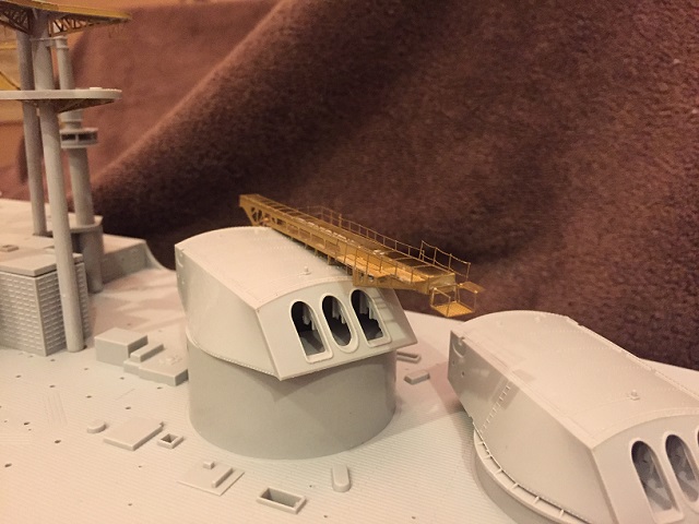

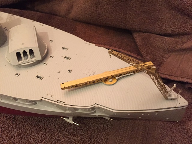

The kit.
Both of the catapults were quite nicely molded in plastic, but were a bit thick and seemed out of scale so I used the photoetched parts. The catapult on the stern was relatively easy to build, but the one on top on the 15 inch gun was much more complex.The photoetched parts were very delicate, but once it was assembled it was a surprisingly strong assembly.
SO here are some better pictures of the finished catapults.
There are tiny trucks that sit on the catapults that I will attach to the planes and then to the painted catapults at the end of the build.

Looking good Carl, really coming together nicely.... Love the PE, really adds to the build.

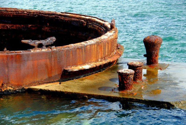

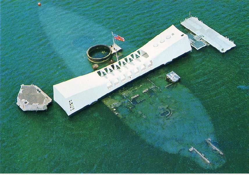

An interesting aerial view of the USS Arizona Memorial, showing the wreck, oil continues to seep from the ship's bunkers..

I'm not really into ships myself - more of an aviation fan - but I have to say, you have got my interest with this build and your work is first class, well done.
An interesting piece on the catapult firing system and very intriguing to learn about how the ship created a calm pool of water on the leeward side for the aircraft to land in - very interesting stuff, I wasn't aware of that so thanks for enlightening me!!
Hope the poor old pilot wasn't sitting and waiting in his plane on the catapult atop the 15 inch guns when they were being fired, imagine the noise!!

Nice photos of the wreck Tom.

Fantastic build, love the PE extras the crane on the bow looks awesome.

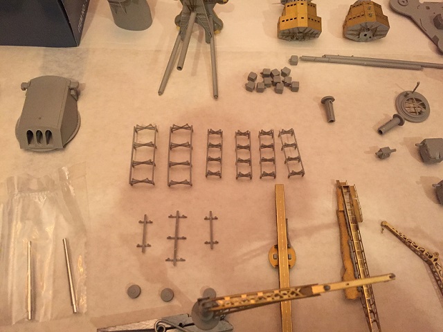

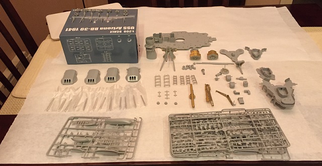

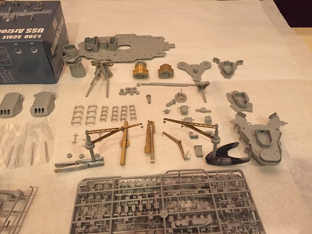

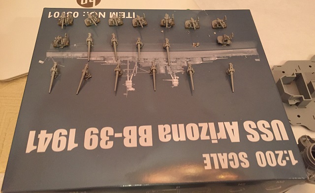

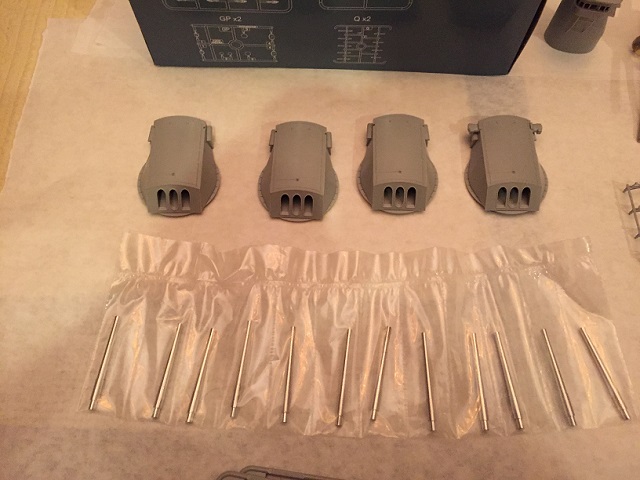

An update on the USS Arizona
Most of the sub assemblies have been completed now.Here are some photos of the parts so far.
The motorboats and the 14 inch guns are going to be painted first and then assembled so I dont have to do any masking.The temperature is finally dropping a bit here so hopefully I can start painting soon.
There are dozens of small detail parts that will go on the main deck I will paint these on the sprues before I attach them to the deck.
#34 Posted : 11 July 2016 20:14:03
Here is a close up of the fire control towers.The photetch armor looks much more in scale than the molded detail and the braces underneath were replaced with photoetched parts.There are some additional details to add, but they are very fragile so I will wait until the towers are mounted to add them.

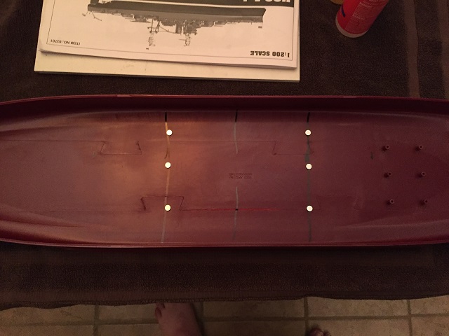

The kit does not come with a stand.The bottom of the hull is pretty flat so it does sit quite nicely without a stand.However, I am concerned it may tip if it is nudged so I glued some magnets to the inside of the bottom hull piece so I can either make a stand or embed the magnets in the display base to prevent it tipping over.
