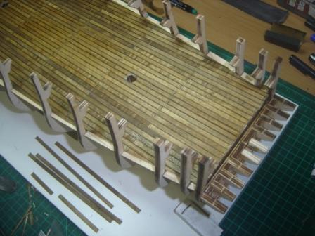

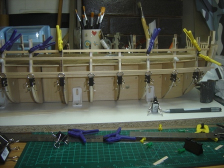

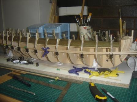

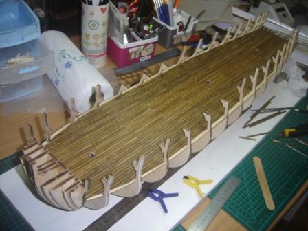

Thank you for the encouragement gentlemen, managed to get the lower deck planking completed today but I was getting a bit anxious towards the end as I only had 4 spare planks left over...no room for errors here.
There are a couple of areas on the deck plate edges at the edges between former's 14 and 18 which require a little trimming on both sides, not a big problem will tackle that tomorrow..

#25 Posted : 26 May 2016 22:38:55
Very nice work on the deck Barry, lovely colour.....
#26 Posted : 27 May 2016 00:11:44
You've done a great job on the planking, it looks fantastic Cool

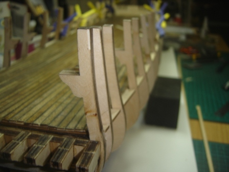

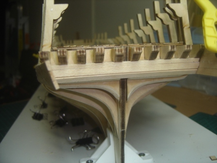

Whilst checking out the former alignment i couldn't help but notice that former 23 at the rear is an odd shape and doesn't line up with 22 & 24 in fact it is straight rather than curved inwards, is this correct as the planking at this point will be a bit hectic???

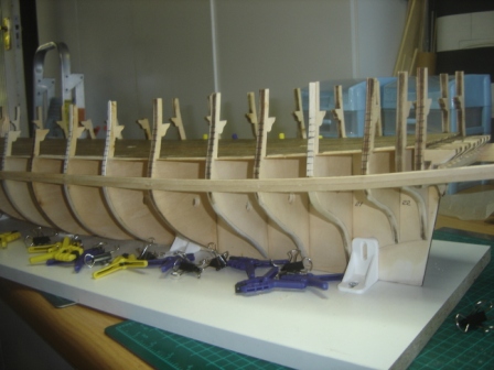

Still grappling with the former alignment, done with the RHS (Starboard?)and temporarily fitted some planks (no glue yet) look's like it's going to work out o/k just got to measure the exact location of the planks onto the former's and then check it again then do the same back to the stern from former 16.

#31 Posted : 28 May 2016 20:36:03
Hi Barry.
Yes the rib is that shape. Once planked all is ok. Plus the admirals room is there so some of that is cut out.
Setting up the first run of planks is one of the hardest things. You will get there.
Looking great the, doing a grand job.

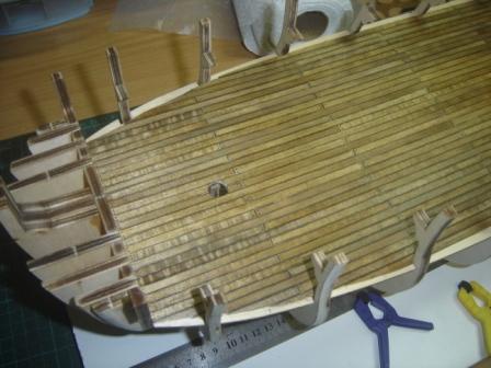

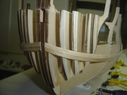

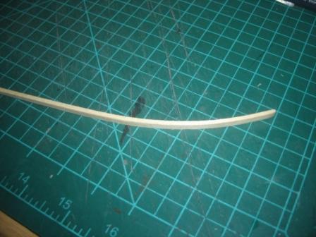

Thank's Chris, I've already shaved a bit off those former's think it will be o/k though. The planking thing for a first timer seems a daunting task, as you say where to start, bending and getting them to sit right!!
Joncal sent me some detailed pics and description on how to start, now feeling a lot happier about it, I've marked the former's where the planks need to fit and test laid a couple (still no glue yet) using the Deag recommended 25mm from the bottom of the lower deck to the bottom of the first plank for the whole length of the hull....even did a bend test...time to break open the glue..

#33 Posted : 31 May 2016 18:56:42
Joined: 18/04/2016
Posts: 134
Points: 402

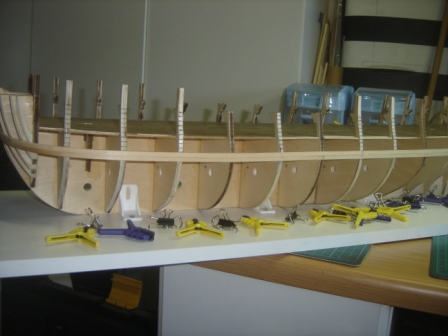

Phew, eventually got all the former's to line up (I think) Got the glue ready, I'm going to use thick viscosity cyano (super glue) to fix the planks to the former's about 4 at a time, this gives me time (about 10-15 sec) to ensure the plank is is the correct place before it sets and then white wood glue between the planks. I used this method on a couple of RC aircraft I scratch built and it worked a treat.
The first couple of planks fitted as per Deag instructions and help from the forum 25mm below the lower deck plate for the entire length of the model.

#34 Posted : 31 May 2016 19:52:17
That looks like a sweet start to your planking.
Always well worth spending some time at this stage as it sets the course for the rest of the planks.
Well Done.

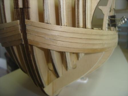

Chris...Don't have the luxury down here to get hold of materials easily so I have to make do with what I have or "make a plan" I used the short planks supplied and if you look real close you'll see the joints.
Trying out your method without using nails seems to be holding up o/k, got to say I'm a little nervous....

#39 Posted : 01 June 2016 16:22:04
As long as you clamp and shape the planks and use plenty wood glue you will be fine. Just remember to clean off the excess glue from the planks. Oh and plenty dry time.
Your doing a top job on her.
