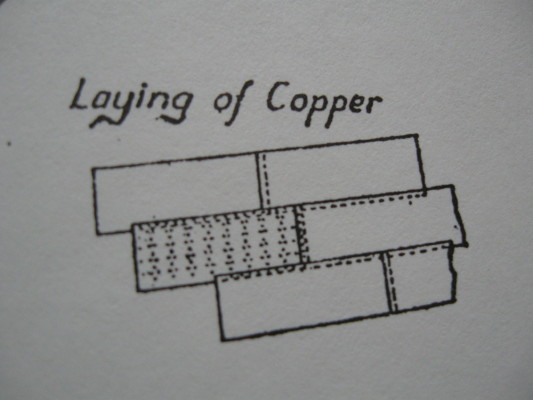

Just a small authenticity detail, if you want authentic then the plates should be overlapped rather than butted, where in reality the tile perimieter nails run in a single line along the overlap, rather than having a double nailed line which is created if you butt the tiles.

Also if you look at Tomick's sketch the lengthwise overlap between rows is less than 50%.
I am currently building the Caldercraft Victory and my only raised eyebrow so far, is that they show the copper plating arranged with a 50% overlap like a brick pattern. However, I have a long way to go before I get to that stage.
I have also discussed with Yotika what effect overlapping the edges has on the number of plates required. I have been told that about an additional 50% may be needed i.e. 3000 instead of 2000! in the case of Victory. However all that is to come in the future, I'm still first planking.

A quick one about the overlapping copper plates, on tommick's sketch the bottom plates overlap the ones above, I would have thought top should overlap those below (like 'clinker build') but looking at photo's I took of the 'Trincmalee' at Hartlepool you can see Tomick is right although the overlap is barely discernable, so it would possibly be a bit OTT to bother with the overlap on a model of this scale??

The drawing is actually from Longridge who has studied Victory inside out.
Plating on a model is a very time consuming task in its own right let alone attending to overlap detail, very much a case of how much time you want to throw at it, where in the main the majority of model builder's/kits go the butt route, including for practical purposes the Caldercraft Victory.

Longridge also points out that overlapping the bottom plates over the top is a characteristic of ships of war. Commercial vessels were coppered with the top plates overlapping the lower ones!
I take Tomick's point about butting versus overlap, I just hope when I get to that stage I will have the incentive and patience to do the longer job. It's up to individual choice in the end!

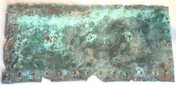

#30 Posted : 06 February 2011 11:24:45
And if you want to go for the 'weathered' look the below photo is of an actual Victory sheathing plate
