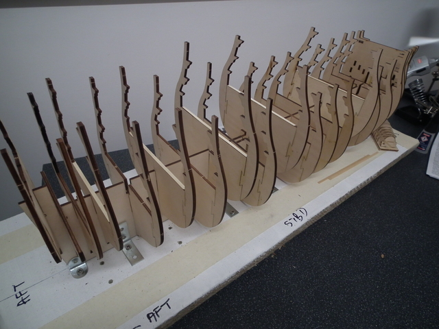

Been too busy to make any progress today (other than one more plank on the launch) so here is a photo of the frames (partly lifted out) that have been fitted with a strip of wood packing. I will then sand them back down to the correct size when I level them all off against the keel. Frame 15 still needs the slot increasing and packing fitted.

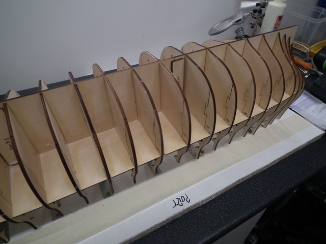

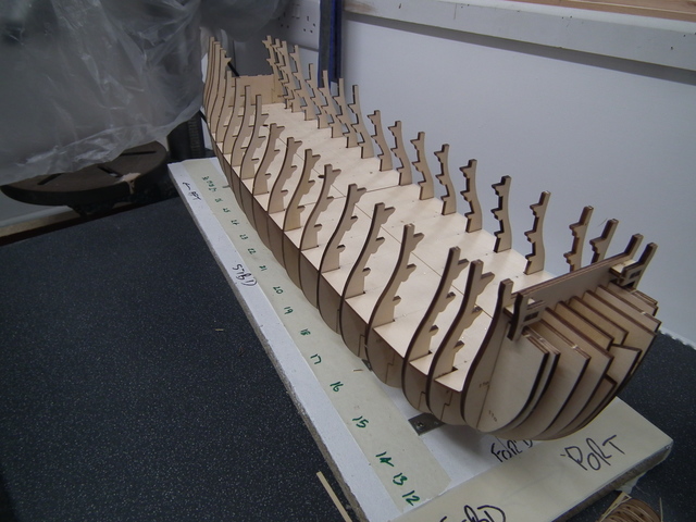

Having nailed down the four parts of the lower gun deck and glued the underside of all the joints (see pics) I decided tonight to fit the beams along the edge of the gundeck. I was really too tired but went ahead anyway.
I sawed the wood part way through to make it bend and sanded the end to make it fit - okay so far. Then, having applied glue where appropriate I set about nailing the beam to the ribs and in doing so managed to break one of the ribsAngry. I was trying so hard to get the nail in properly I forgot my hand was very close to the opposite ribs.
I have now glued it and splinted it so it should be okay.
However, when I checked the deck edge beam it is not in contact with all of the ribs because it needs more cutting to make it flexible. Why didn't I check the fit before starting with glue and nails? Impatient, me?
Well I removed the beam, cleaned off the glue and will start it again when I have time to do it properly.
Lesson learned!

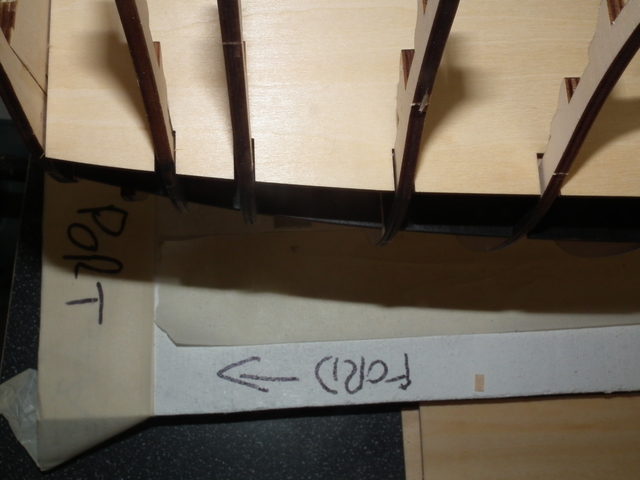

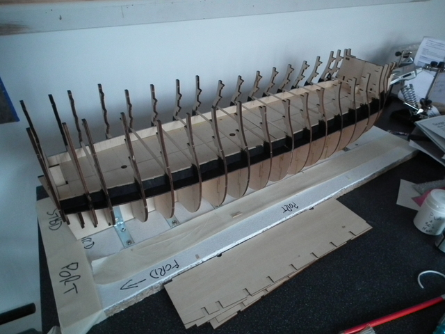

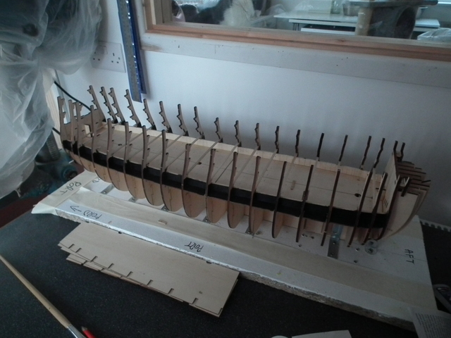

Well the lower gun deck is now complete and I have started on the middle gun deck. To avoid the sort of accident I had with my first attempt I have not nailed the after deck edge beams on the lower gun deck but the glue is doing a grand job!
One thing I've noticed about the middle gun deck is that when dry fitted the deck panels actually overhang the ribs at the aft corners (third photo). I am assuming this won't be a problem because it will be picked up during fairing.
Also, I have just noticed that if you look at my Victory I have managed to put her back on her jig backwards - oopsBlushing

Looking good Gary you're doing a grand job.....Cool Cool .. The deck overhang isn't a problem as you rightly point out, it will be taken care of when you get to the fairing stage......Cool Cool .. Keep up the good work....
