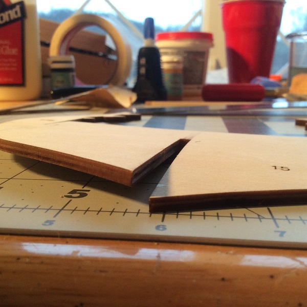

Here's Bulkhead 15. I think I need a replacement, yes?

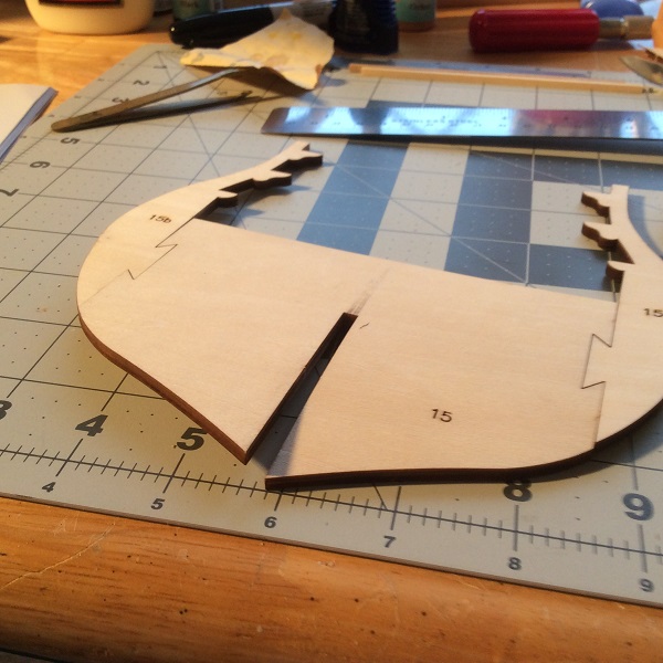

Another photo.

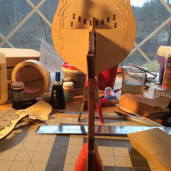

Here is the second section of the frame. The bottom of this is pretty straight. From what I can tell from the instructions, only the deck will sit on top of this, so I am not certain this needs to be corrected.
The end, which shows the worst warping, should be fixed when I glue the next piece of the frame....I hope.

BigGrin Yep I think frame 15 definitely needs replacing Blink brilliant job on the rest of the build Cool

Hi, great to see you have the picture problem resolved. You can of course post more than one picture per post, this would save you having to create separate posts for each pic....Cool Cool .. Vic is coming along very nicely but would highly recommend you put her in a jig to help ensure the keel is kept perfectly straight. The rigors of the early planking stage can pull the keel out of alignment creating bigger problems later in the build.....Cool Cool .. Look forward to seeing your next update....

Doing a great job. I second Alan's comment of putting her in a jig as the keel may have a tendency to twist.

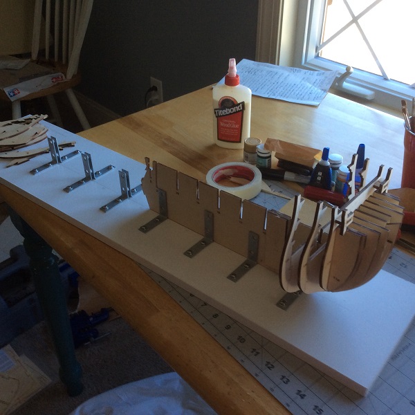

Thanks for all the comments and recommendations for a jig.
Making one is my project for today. Headed to the local Lowe's in a couple of hours.

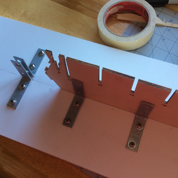

Jig completed. Very simple, actually.

#32 Posted : 28 February 2016 20:24:03
Hi, BigGrin
Looking good, shame about that rib 15 but I`m sure you`ll get the problem resolved with a replacement.
Congrats on your "Blue" medal for producing a build diary. Cool
#33 Posted : 28 February 2016 20:28:56
Looking good.Your replacement part should arrive soon.Good job on the building jig-that will keep your Victory nice and straight!!
