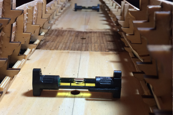

After a 30 minute bath, I pulled the Victory who was now nice and clean from the tub and remounted her to the level board. Still 1mm out of alignment, so I used some scraps of planking and some .41mm wire and pulled the Victory into shape, tying the wire off to screws on the leveling board. When all was said and done the Victory was in near perfect shape. The pic is from the stern, the bow is level and the stern is juuuuuuuuuust slightly out of level...good enough for me. There were a few victims of the effort, but these can be easily reattached once the Victory has dried in her new, perfect form.

BigGrin Wow that was brave but it seems to have payed off well done Cool hopefully the foremast and mizzenmast will line up if not they can be adjusted by filing out the holes a little bit Cool Looking forward to the next update

Hi Troy, think soaking in the bath was an exceptionally brave thing to do but great to see things look to be working out for you, certainly a braver man than I am...Blushing Blushing. Keep checking the alignment as time goes on just to ensure the old girl doesn't slowly return to her previous state as she dries out fully. Keep up the good work, will be following your progress all the way. Should you need further guidance then simply shout and someone will answer. Good luck with her.....Cool Cool

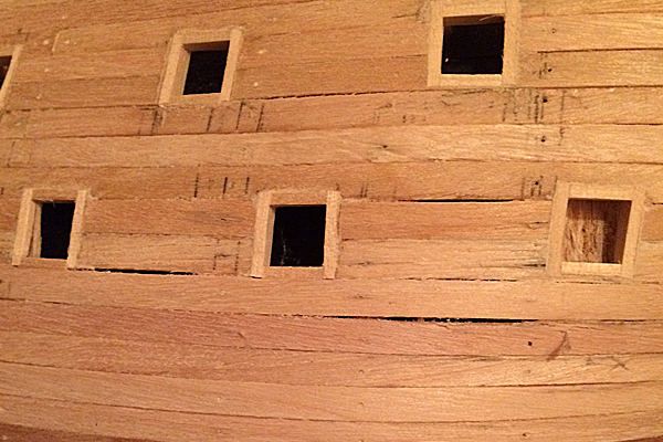

So the bath and dry dock did pull the Victory into the proper shape, but it wasn't without consequences. I did have a few planks come loose during the soaking and bending process and thought that may be the worst of it. However, as the drying continued throughout the next couple days gaps began to appear in areas where there weren't ones before. On the port side, these gaps were so extreme and disjointed that there was no choice but to remove all the planking. It was dreadful. Really dreadful. Here's her port side now...

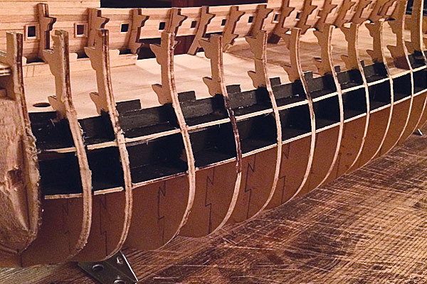

The starboard side seemed to turn out ok aside from a few gaps opening up. These I don't think will be a problem.

So it's a good thing that I really enjoy the planking process. However, now I will need more planking. Anyone suggestions on a good supplier? I have lots of extra planking that came with the packs, but I am sure it won't be enough. At least I can get started on re-planking while waiting for the new boards to arrive. Also, this time around the Victory will be confined to a secure dry dock while I plank and I will be sure to check alignment down the center line very, very, very often.

Hi Troy, unfortunately there is always the danger of something like this happening, gaps appearing and strips coming away as she fully dries out. On the positive side you are now in a position to be able to ensure your hull is straight and true, and I'm sure you'll look back on this and think the effort was all worth while, plus you'll have gained valuable experience. Cool Cool. You should also be able to use a good proportion of the planks that came away. Cool Angry
