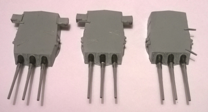

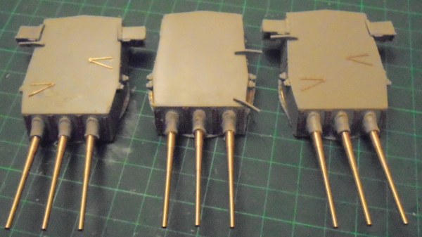

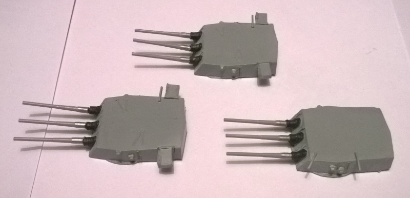

Guns
The final two guns were assembled, I first attempted to base coat the part using the air brush but I was unsuccessful in getting anything resembling a consistent coat. The air brush was replaced with a can of Citadel Corax White from games workshop, then painted with Revell aqua colour paints

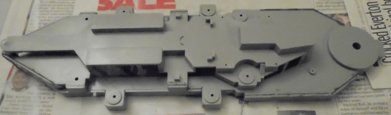

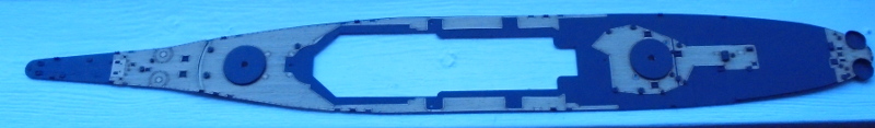

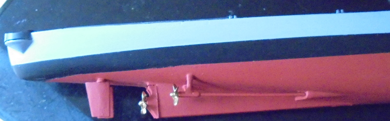

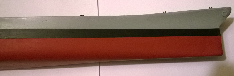

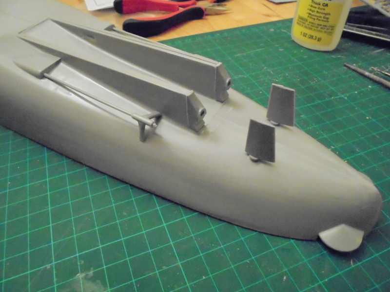

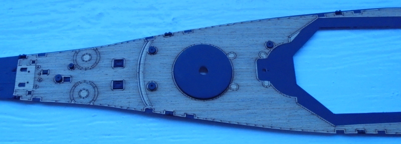

Hull and deck
The rudders and propeller shafts were added to the hull and primed white. The hull was painted with multiple thinned down layers. I had difficulty getting a straight line when using masking tape as the paint kept bleeding through in several areas. The solution I found (on a random imgur post) was to paint over the masking tape with the paint colour it is protecting.
Picture 1-3

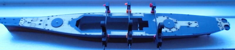

The deck was painted and then the stick on deck components were added
Picture 4-6
The deck was then glued in place and the propellers painted and added.
Picture 7-8

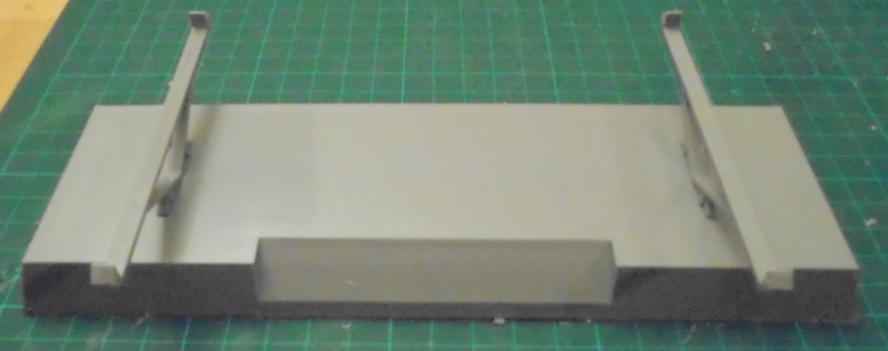

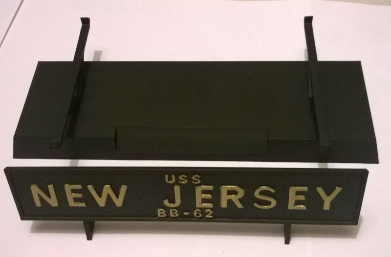

Display Stand
The provided stand was assembled and painted. I may replace this later depending on how happy I am with the finished product.
michael.rolph attached the following image(s):

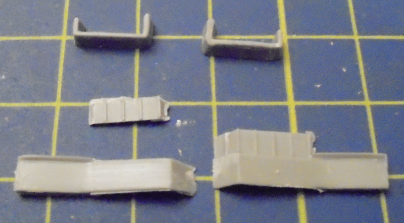

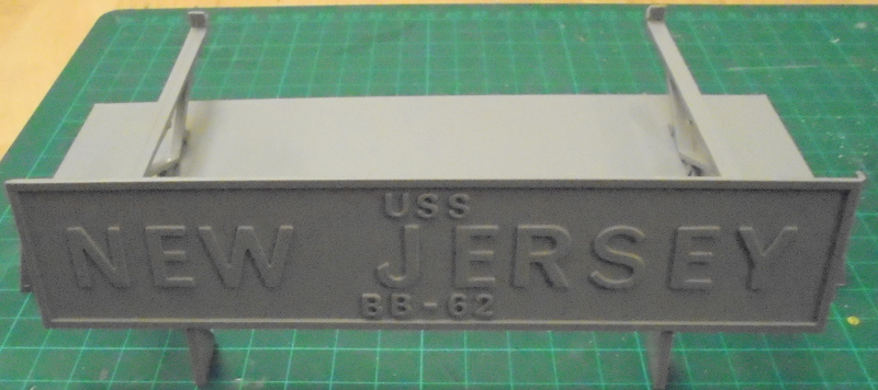

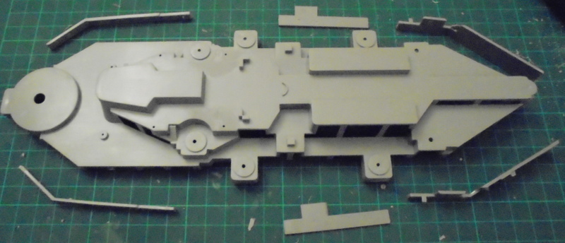

Super structure base
The componets of the superstructure base were cleaned up and assembled. I used liquid green stuff from Games Workshop to fill in small gaps between the pieces.
Picture 1-3
Some parts had to be removed to make way for some PE parts.
Picture 4
Once base coated and painted the stick on deck pieces were applied.
Picture 5

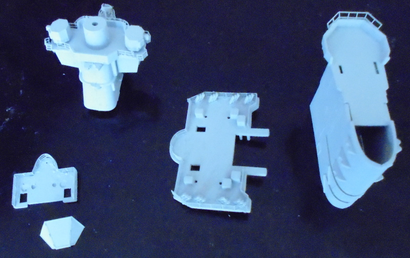

Tower
The sections of the tower have been assembled and primed.

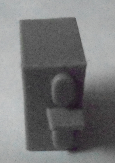

michael.rolph
#38 Posted : 15 August 2016 19:46:54
Joined: 14/04/2015
Posts: 238
Points: 716
Location: Newcastle
Hi everyone, it's been a while since my last update. I've just finished moving house so everything’s been a bit hectic.
The following updates are for work I did before my move, hopefully I'll be able to start modelling again this week.

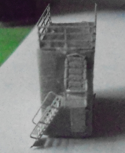

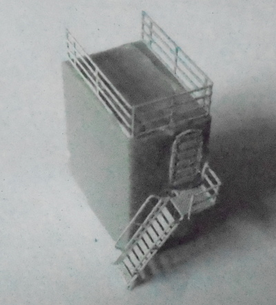

Entrance
This section sits just behind the bridge. The plastic doors and platform were removed and replaced with PE.
michael.rolph

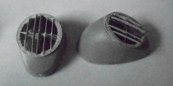

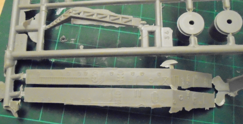

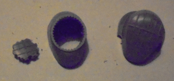

Funnel tops
Both pieces were removed and the unwanted platforms around the back and sides were removed. Multiple holes were drilled around the circumference of the funnel and the centre section removed.
Picture 1-2
The PE sections were added, this was the most difficult PE to add so far as the pieces didn't fit together easily. Two pieces of etch formed cross shape that should have dropped into the top of the funnel but it was slightly too large and required a lot of work to get to fit.
Picture 3

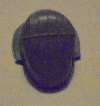

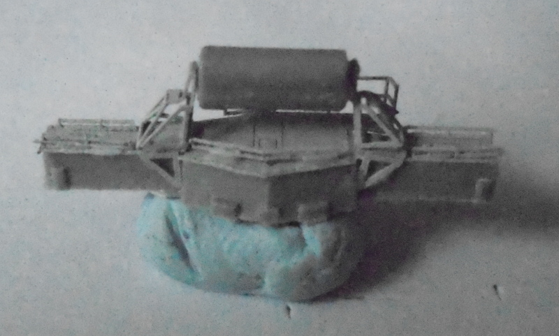

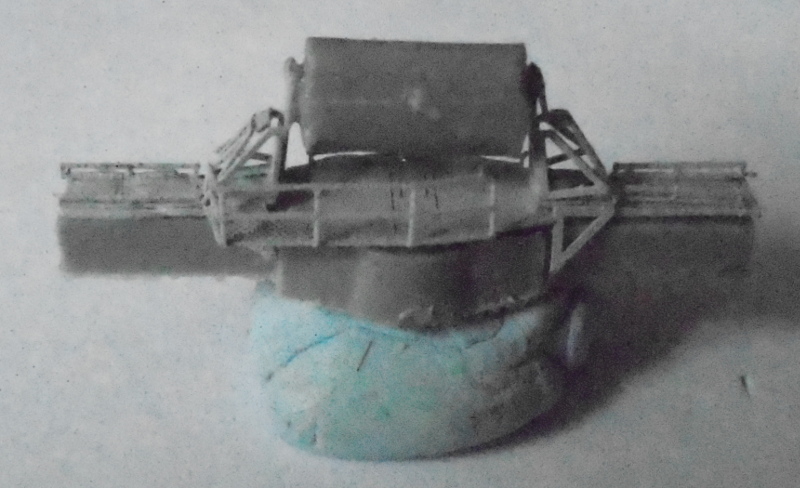

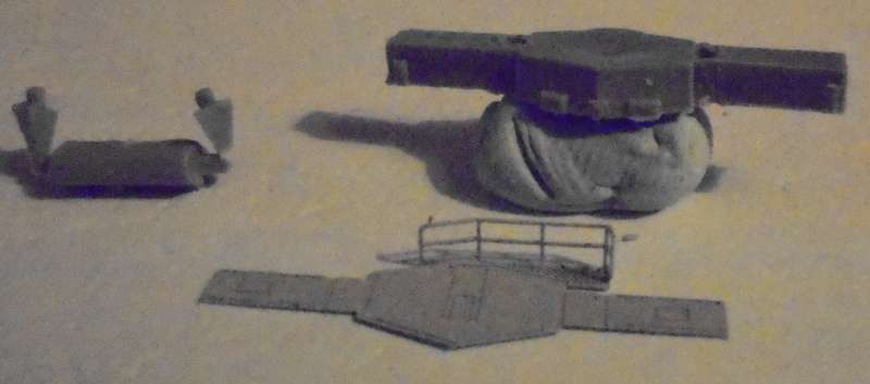

Main Gun Detector
The pieces and PE were removed. The plastic supports for the detector were removed. The replacement PE supports were added and some PE railing glued in place. The instructions called for holes to be drilled into either side of the detector and for it to be held in place with PE pins, these pins were too small to pick up and position correctly so the detector was glued in place.
