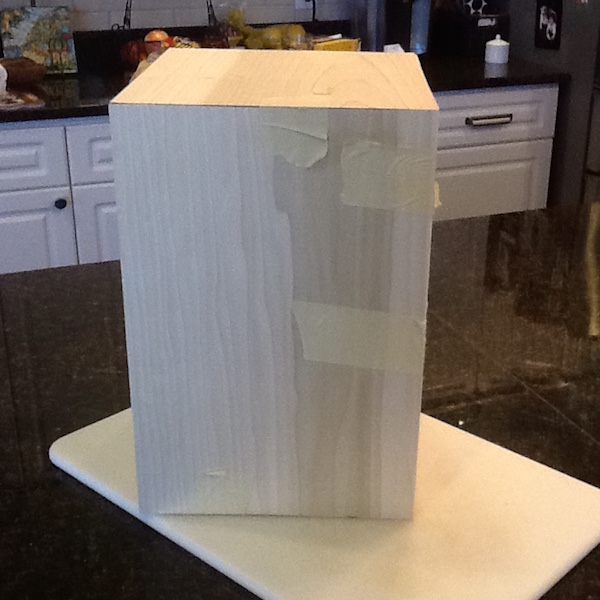

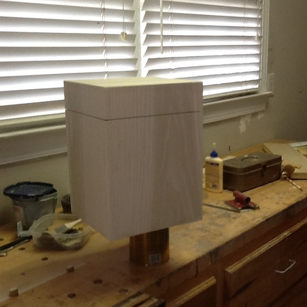

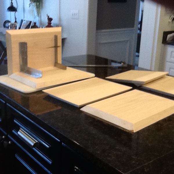

As I am in the break time, here are some pics of what may be my display stand rather than the cardboard box. This base does not open, it is what is is. Long ways to go and most applicable hardware comes from the UK. I have been researching on the WEB and a lot of examples are there. I will need some help on the emblems, the Date mons is very complicated. Lots of time to do this.....

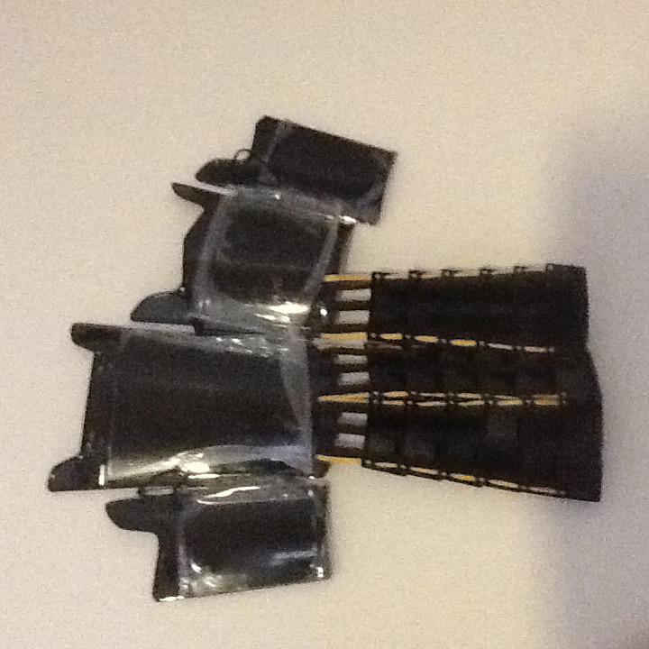

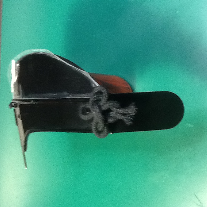

Pack 3 Half Time Report: Tassets are Tassets, no problems and they do go faster and easier - still take up most of my time.Mellow Assembly of the metal parts is straight forward, just follow the instructions. The shoulder plates joint nicely if you bend the the hinge pin to match the curve of the plates.
My challenge in this step has been the shoulder plate knot. The problem was mine and not the kit's. There is not a lot of extra cord provided so be careful. I found the basic knot diagram to be very good as a guide, better than the pictures. I ended up making the knot too big and when I finished and trimmed it, it looked like crap IMHO. So... I needed more cord. After visiting a few fabric shops, not my favorite chore, I found cord of the same weave and diameter but it was black, not the ink blue provided. Oh well, the two shoulder knots will be black but if you don't tell, I won't either. Bought 3 yards to backup more probable errors.BigGrin The bitter ends were cut a bit longer and then whipped with thread and the last cm was shredded. Picture shows this.
17.5 man-hours so far, not counting shopping for cord. Really fun and relaxing build.

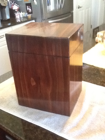

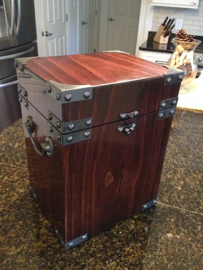

I decided to finish the display storage box before moving on the the last step in Pack 3.
The box was finished with four coats of red mahogany stain and then lightly sanded. I decided to use a satin lacquer finish and started with three coats brushed on, well sanded between coats to prevent build up, as a base. Then one and a half spray cans were used in 12 light coats. Light sanding with 320 grit paper and 400 and 600 grit wet paper was used at the end. The finish was rubbed out with furniture polishing compound. N to quite a piano finish but close.
Solid brass fittings were used except for the tacks and ball latches which were only brass plated. I removed the bright protective coating with furniture stripping liquid. Just soaked everything for 20 minutes and applied a tooth brush, water rinse and towel and air dry. All were blackened with a model railroad weathering agent. Again 20 minutes in the bath, rinsed and dried. Once dry I gently rubbed each piece with a cotton rag gently to get the desired finish.
Before you ask, there are exactly 80 brass tacks in the box. I have no idea how authentic this ended up but I thought the ball catches used to hold the lid down was a neat thought and not modern. Fun to do and my wife already has a small plant on it in our living room.

Drool Love Drool Love That is a seriously gorgeous looking box, fantastic skills!!

Yep that certainly is one very nice box you have built and with the fittings you have used its got that kind of "Japanese" feel to it and will make a great addition to the armour.

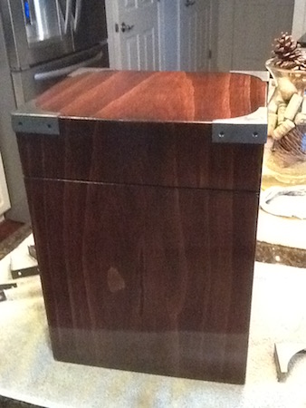

I launched into the stand right away. All wood was excellent and with my replacement base ( Thanks again Model Space) all i had to do was apply some lacquer sanding seal and finish. Looks good.

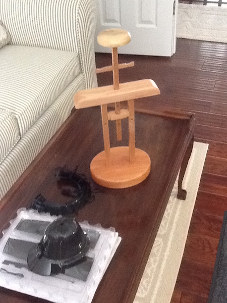

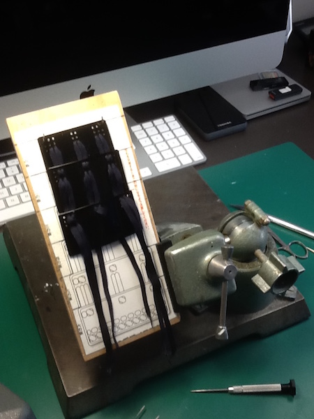

Helmet rings went in as advertised and am now back to the never ending tassets. The picture will show my jig in a vise. What a difference this made! Both hands are completely free to lace the plates and be sure mountains and valleys are maintained and spacing between plates is correct. I had to removed and reweave two lacings here just to please my anal brain and discovered that if you slightly wet the laces and press them flat all original impression will relax. Easy to adjust the laces with tweezers and to pull them into position with the jig in the vice. Something good to know as redos are always present.Cool
I hope this picture of my base will also properly show. I adjusted pixel size and dropped resolution, let's see if it works.
tnequette attached the following image(s):
