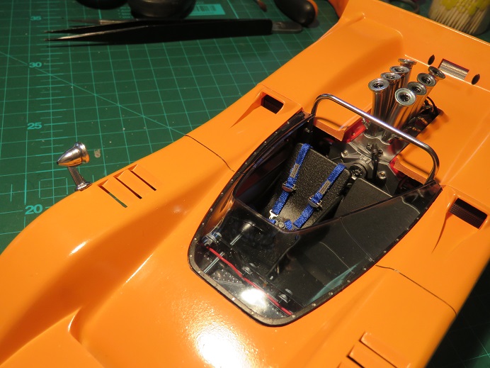

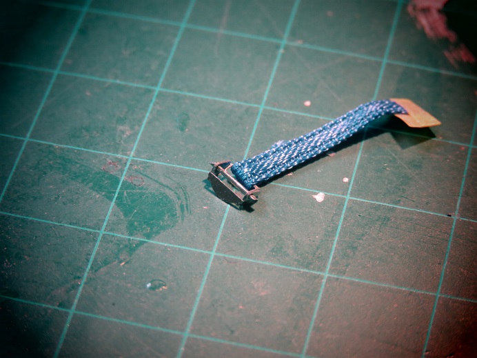

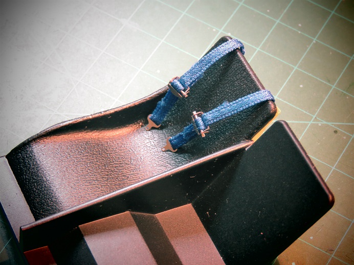

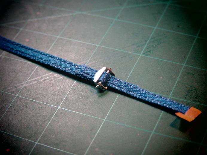

#27 Posted : 21 February 2016 15:27:46
Tried my hand at a 1/20 scale seat belt set. Tricky little PE parts but happy with the result.BigGrin

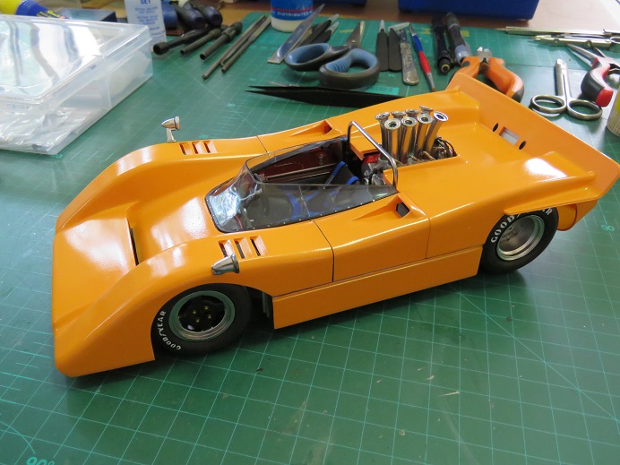

Most of the underbody stuff done now.

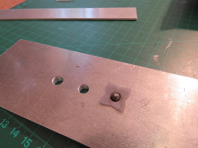

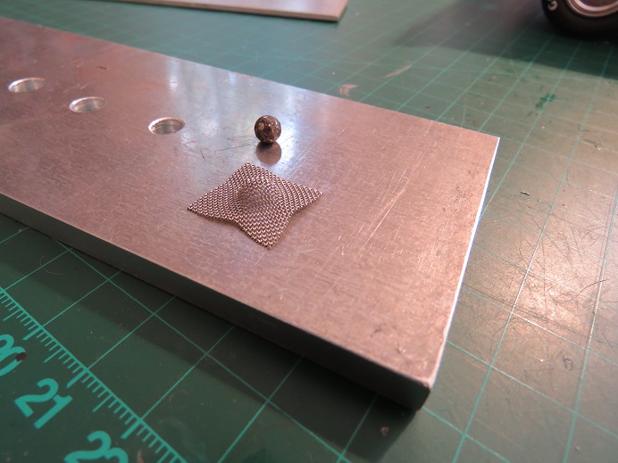

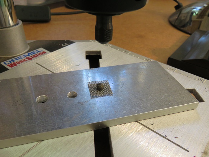

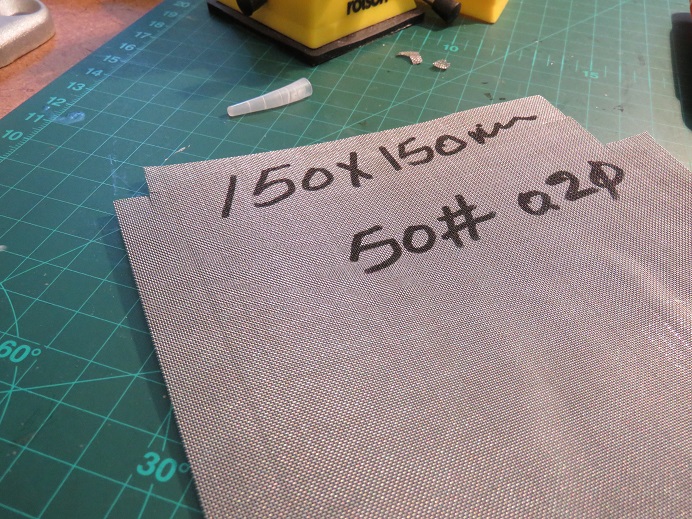

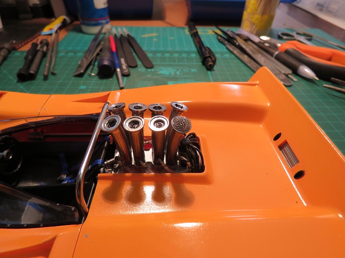

Further to Kev's suggestion about making the stone guards on top of the inlet pipes I found a local company that supplies wire mesh and got a couple of offcuts to play with.
I drilled a 6mm hole in an aluminium plate and used a 5mm ball ( could only find a rusty one ) to press the mesh into a dome.
The hard part was cutting the final size with snips. I need to get a 5.5mm hole punch to get consistency with the finished size.
Anyway one is doneBigGrin

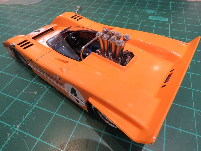

#30 Posted : 06 March 2016 15:15:26
#31 Posted : 06 March 2016 16:01:45
Now that is very neat and well thought out. Makes a massive difference to have the dust guards in place.
#32 Posted : 06 March 2016 21:58:53
This has turned out very nice Malc, the stone guards really add that extra ThumpUp
kpnuts

Very nice work Malc, she's looking good and I'm glad that the making of the mesh covers worked out well for you?! They certainly make all the difference to the appearance of the induction trumpets!!
Top job my friend - well done!! Drool Cool ThumpUp

Great work on the mesh covers!BigGrin

Thanks for all the encouraging comments guys.
I'm still looking for a suitable hole punch to make the rest of the covers.BigGrin

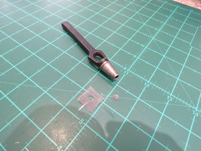

#37 Posted : 12 March 2016 14:50:40

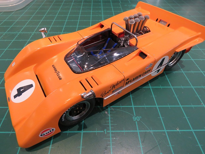

Found that 5,5mm hole punch BigGrin BigGrin
#38 Posted : 12 March 2016 14:58:19
Finished !! BigGrin BigGrin
Not a bad little model but would benefit from some underbody detail.
A nice addition of an early Mclaren for my collection.
#39 Posted : 12 March 2016 15:09:04
Shelf space is being negotiatedCool
#40 Posted : 12 March 2016 15:45:05
I learned a few more things about Mclaren cars and modelling with this build so very worthwhile.
More in the finished gallery.
