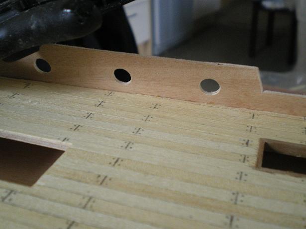

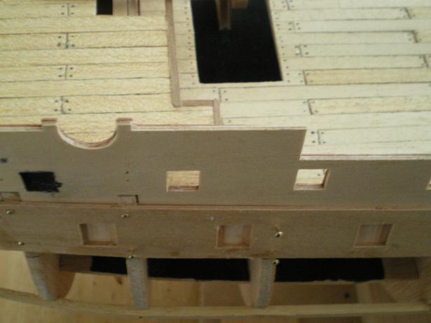

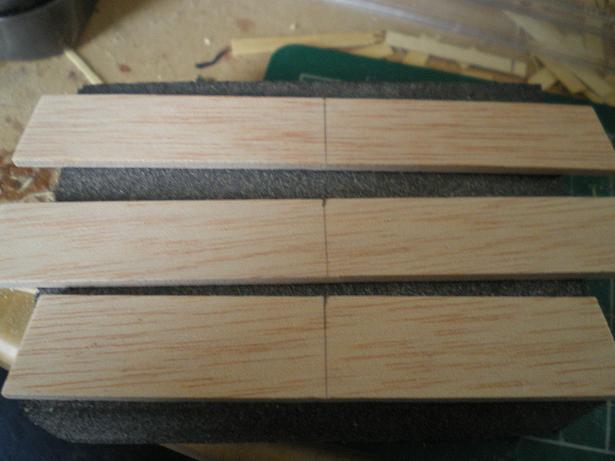

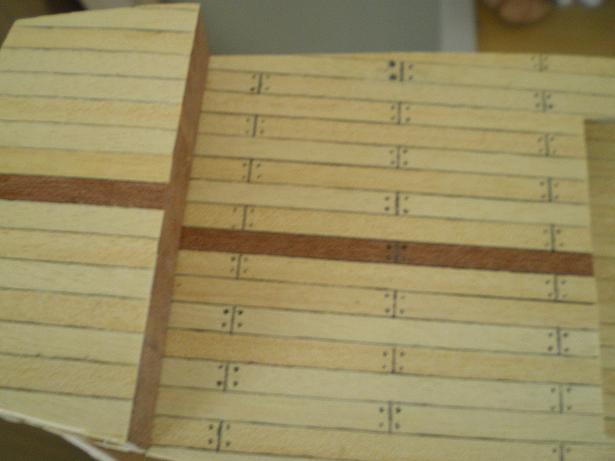

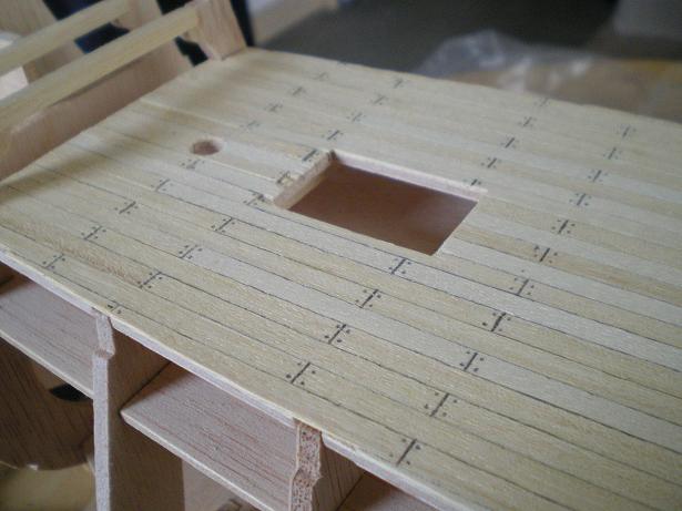

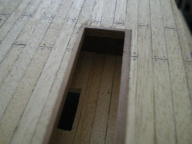

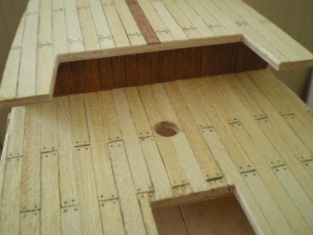

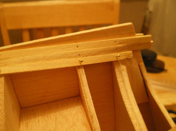

A bit more done on the build Cool
I heve planked all of the decks and bulkheads and sanded them down BigGrin
Next job is fitting the walnut strips to the edge of the decks they where cut to size and glued into place with PVA and left to dry . Then they where sanded down to deck level Cool
The instructions say to fit the bulwarks to the side of the ship . I have deviated from the instructions and will fit them after I have flared the frames on the hull as I think they could get broken when the ship is up side down Blink . On checking the run of the planks I found that they fell into the gap of the bow so I have filled them with balsa and cut and sanded to shape and on a bluff bow it will help with the run of the planks Cool
Thanks for looking rgd Martyn

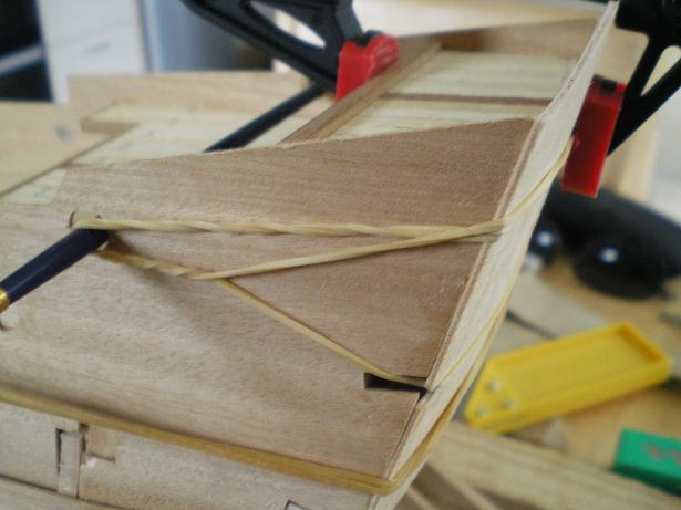

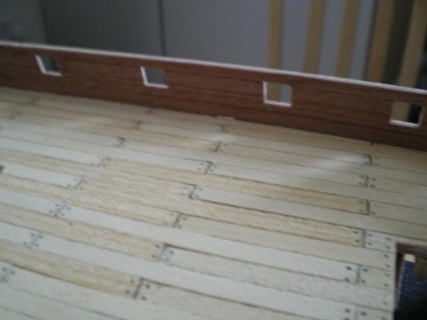

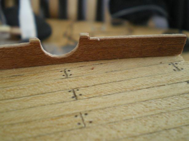

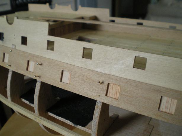

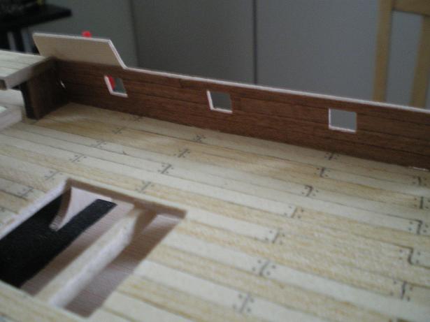

Just a small update on the build . After a lot of sanding to flar the hullI have fitted the upper bulwarks . The instructions say to stain the sides but I have planked them with some planks left over from the SoTs as I want a all wood finish Cool
Thanks for looking in rgd Martyn

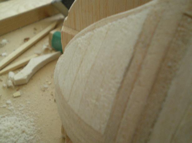

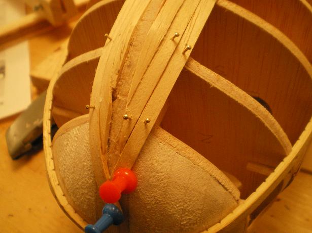

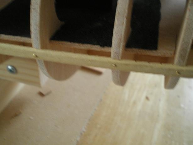

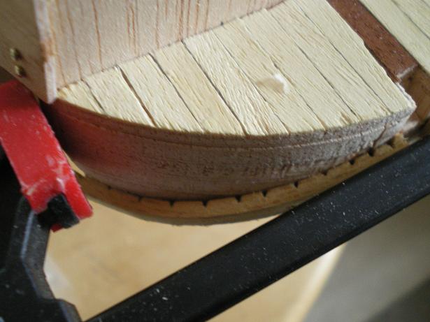

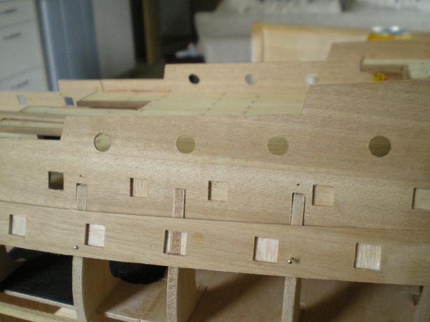

A bit more done on the San Felipe Cool

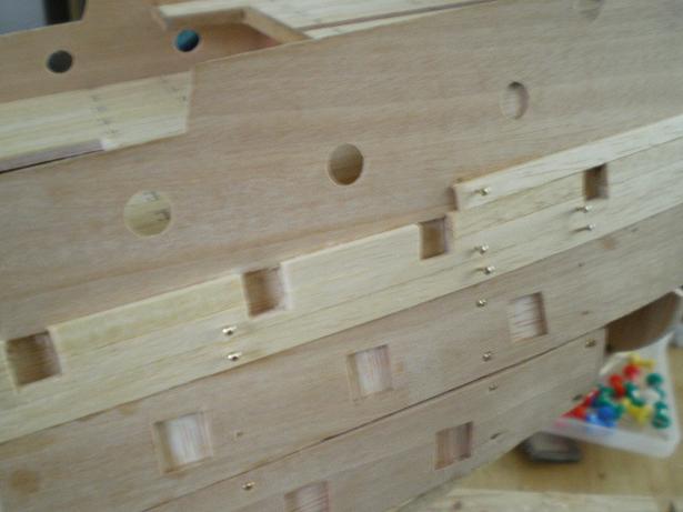

I have fitted the middle gunport bulwarks and glued the first planks to the side of the hull . The problem with the planks is they are very thick and hard to bend even after soaking in hot water and even my plank bender was having trouble so I had a thought and came up with a cunning plan Cool The tip is to cut a grove across the plank at approximately every 5mm along the length that you want to bend then soak in very hot water for 15 minutes or so then they bend without braking Cool

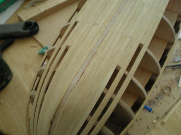

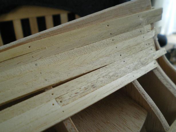

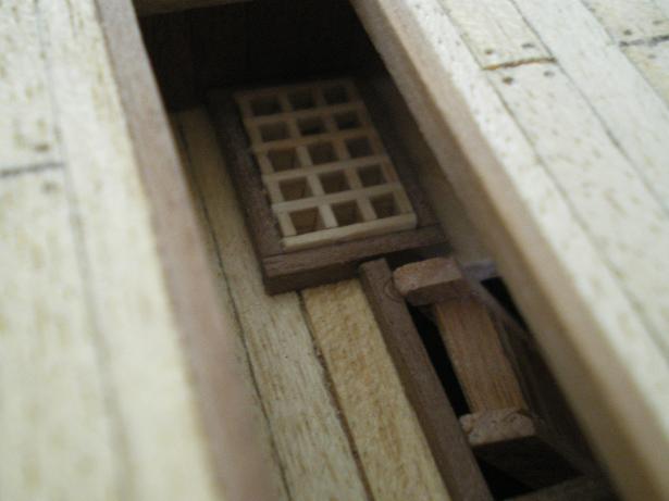

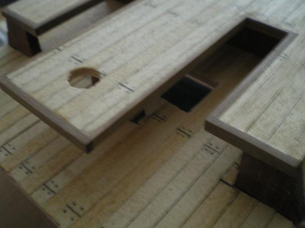

I have started the first planking of the hull the stripes are a lot thinner than the first ones and bend a lot easier Cool
The first plank that butts up against the keel is the most important as its the one that helps keep all the other planks in line Blink Once done the next planks are soaked in hot water to increase their flexibility and butted up against the first one . I always glue the edge of the plank to the next one as this helps strengthen the hull ThumpUp
As you can see by the pictures I haven't shown all the planks being put down BigGrin
I don't know if I am getting better at planking but this has got to be the easiest one I have done as the instructions are very easy to follow Cool

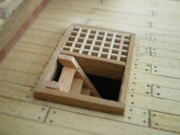

To brake up the planking I have built the gratings and ladders Cool
Thanks for following rgd Martyn
