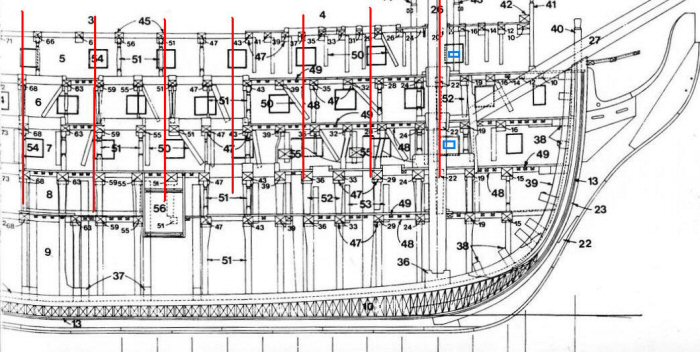

I actully thought everything was goining fine untill i marked out the upper row of gun ports and that infamous rib 15 finally struck for me. I knew it was slightly out of shape but not as much as when i marked the 2 gun ports nearest the bow and found them well out.
Without ripping the whole of the planking off, which i dont want to do do you think it will look wrong to cut the ports out slightl;y forward of the lower ones or is there another way rond this which does not involve starting again.
Any help is much appreciated.

My solution was to steam the rib joints on both sides free from the planking from the deck up and gently force the rib into the correct position and re-glue using clamps to hold until dry.
I was then able to position the gun port correctly although I had to slightly cut into the side of the rib to achieve this.
I hope this is of some help to you.

Hi fozy, move it forward cos thats where it should be, the lower deck gun ports are not in line on the real victory with the top ones, there isn`t a lot of difference between them but never the less they are not in line, and luckily the one thats the most out is the one you need to move it scales in at about 3 mm forward of the bottom one.without drawings of this build I cant say if it will affect anything else, but cant see what could go wrong.
The drawing shows the gun ports, the red line shows the difference, but only alter the one you have to, and stick as close to the tomicks build as possible
