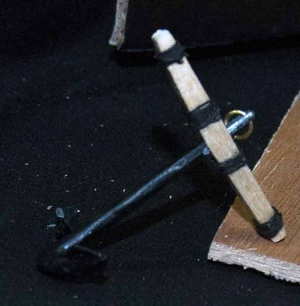

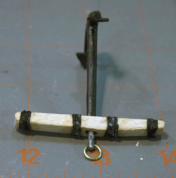

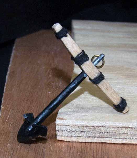

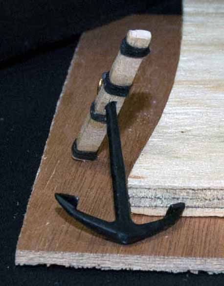

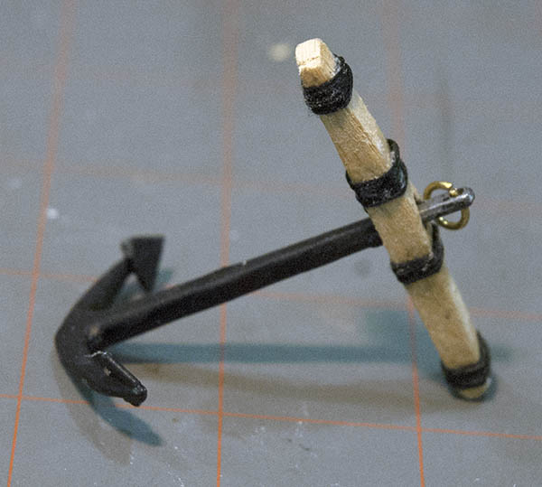

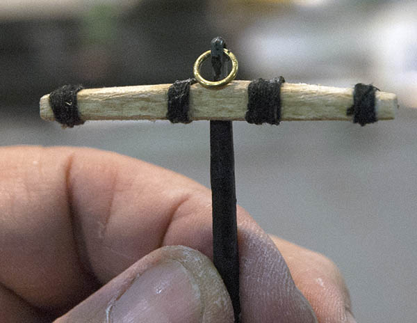

Here is the corrected anchorBlushing
4niertsr attached the following image(s):
#23 Posted : 18 September 2015 18:56:34
BigGrin Hi Tom good work on the anchor but the stock is upside down check out MrT s official build . Hope this helps

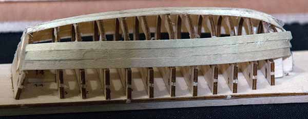

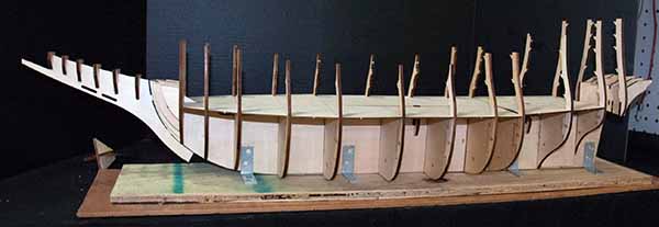

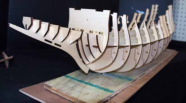

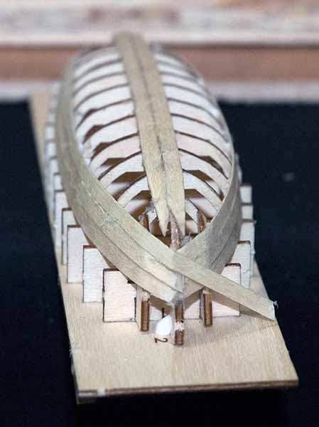

I fixed the anchor and continued building the false keel and supports. I also started to plank the launch.

BigGrin Looking good, but I would change that piece of plywood your using as a dry dock and replace it with a piece of melamine or something more substantial as it already looks like it is lifting at the front and you dont want a banana boatCool
#26 Posted : 20 September 2015 00:16:37
Much better with the anchor so well done.... Coming along nicely and I agree with Andy, swop the build board for something more substantial, MDF works well as does a piece of shelving. Problem with plywood is it is too easily warped....Cool Cool .. Keep the pics coming, look forward to your next update.....
#27 Posted : 20 September 2015 08:19:59
BigGrin Well done with the anchor looking good Tom Cool

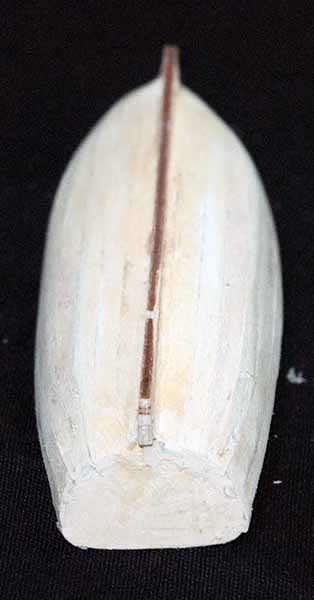

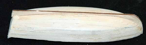

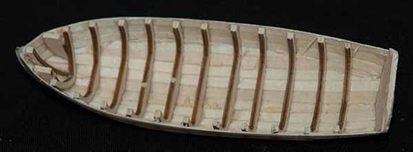

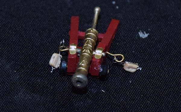

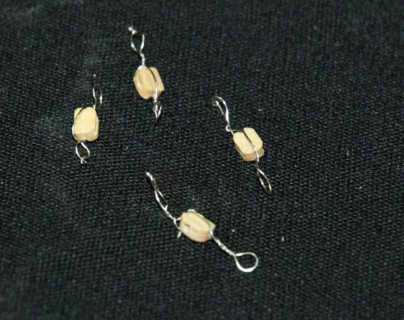

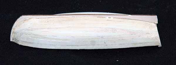

Todays build was a slow one with only small pieces worked on. I finished fairing the launch, finished the blocks and added blocked to cannon.

BigGrin well done on your first bit of planking the launch looks very nice Cool
#30 Posted : 21 September 2015 08:58:04
Coming along nicely, well done on the launch and should look fine with a light sanding. You will need to sand back a little the keel at the stern otherwise you'll have problems trying to fit the rudder later in the build....Cool Cool .. Keep the pics coming...

For my build board I used a thick pine shelf that I picked up cheaply at a large DIY store, they were selling it cheap as the brakets and screws were missing, perfect for my needs BigGrin

Things are still going well I am anxiously awaiting the second delivery for the next build. In themean time I replaced the plywood base with a solid pine shelf.

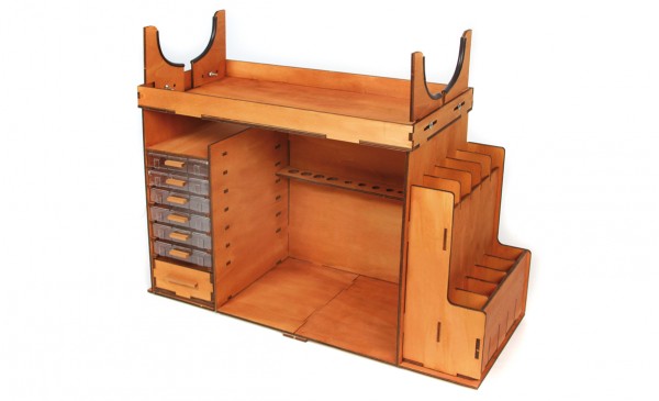

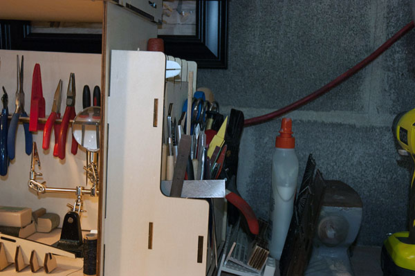

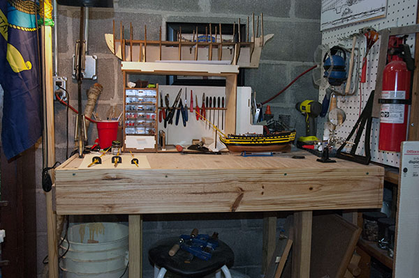

I found a piece of equipment that looks like it could help with keeping me organized
#36 Posted : 03 October 2015 08:31:08

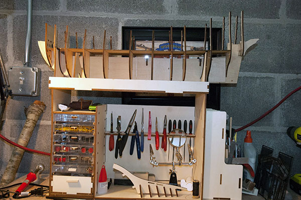

BigGrin Hi Tom the build station will definitely help quite a few builders on the forum have them and think they are the best thing since sliced bread Laugh
#37 Posted : 03 October 2015 09:21:23
Hi Tom, a number of members have bought this item and all have been positive on it to date, don't think you will be disappointed as it's an excellent item to have for your builds. You may also find this excellent diary on the kit done by ARPuchase very useful too..... Hope this helps...Cool Cool
http://forum.model-space...aspx?g=posts&t=8873
#38 Posted : 03 October 2015 09:55:55
BigGrin Hi Tom
Like Alan I can totally recommend the above station, If you are a living room table builder it keeps everything stored away and is easy to move about if needed. One thing I would add if your moving it about a lot is maybe some carrying handles at the sides.

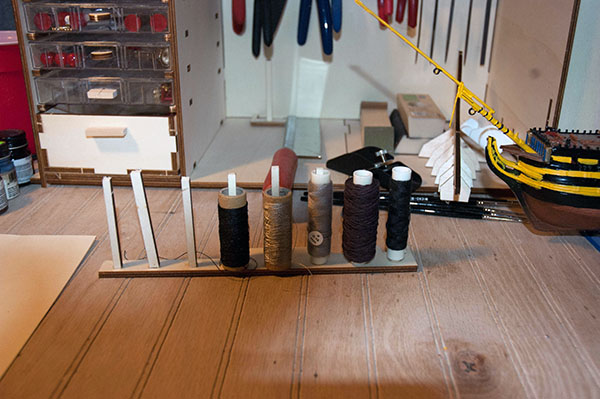

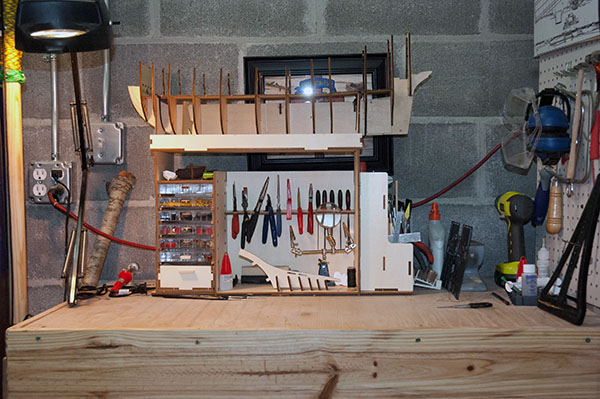

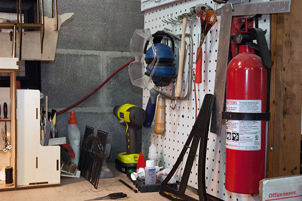

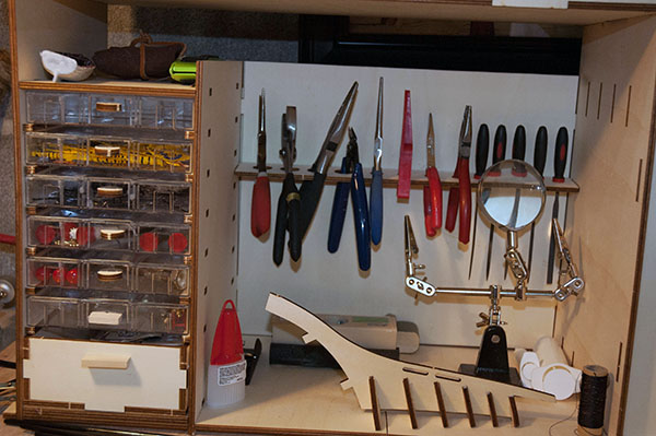

Here are a few pictures of my new work station. I really enjoy it and have everything in order and close at hand
