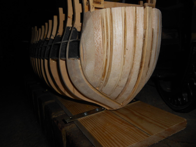

Finishing up the bow infill. I'm hoping someone with more experience can take a look. I'm wondering if I've sanded it down far enough. It "feels" symmetrical. I sanded it with the contour of the bulkhead, but that leaves the bow formers somewhat inset. Hopefully you can see what I mean in the pic below.
Also, the voids in there are from my really poor notching of the balsa. I'm assuming that they aren't really going to hurt anything once both layers of planks are added. If they are, I think I can fill them easily enough... :P
Thanks in advance.

In my limited experience it looks to me like the top of your bow section looks fine because you have sanded down to the frames, but the bottom of the bow section could do with a bit more, you wont truly know until you get it on the false keel with a few ribs on and run a plank around it to see how it sits, i can only put a picture up of what i've done recently to give you a comparison.

Thanks for the input Paul. BigGrin I was thinking that I should do what you suggested. It just made me nervous as it would require sanding a bit off of the bottom of the bulkhead.
I like the idea of trying a plank on it, just to see. All I have are the strakes for the launch. I'm not sure if they are similar to the planks for the hull though. I tried one of the strakes out, and it did seem to lie nicely on the bow, as far as I could tell. Heheh.
I see that you also filled the section immediately behind the bow. Did you do that to play it safe, or was there a more specific reason for it? Just curious. :)

Hi Broven, I have to agree with Gibbo and wait until all the ribs have been fitted before taking any more off. Then you can fair all all the frames at the same time to get a nice flowing curve.

Thanks nightwisher. I have sat here staring at it for an hour now, and I think I agree as well. I need to view the bow as part of the whole and not as an independent piece. It makes me think that the bow of each build is probably as unique as a fingerprint. Hehehe. I don't see how anyone could do it exactly the same as someone else. ;)

Hi Tim, good progress to say the least.... Agree with what's already been said, you do need to continue to shape the bow some more however, I wouldn't do any more just yet until you are ready to start the planking phase. When you get to that stage you will be fairing all of the hull so you will be able to see clearer how the shapes of the bow and the stern will be. A look at the same stage here on my build should give you clearer idea.....Cool Cool ..

Just to play it safe mate, had a bit left over so just chucked it in.
