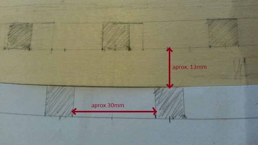

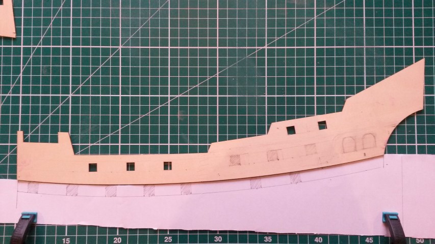

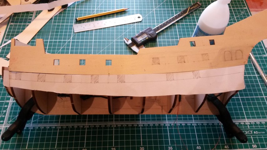

Hi all, need help from someone who finished this build.
I'am working now on gun-ports position.Confused Confused
To make sure where to place support beams or boxes for my dummy cannons I've made some kind of template taking measurements from overall plan.Blushing
As this is very important for my build can any one who finished SF can confirm my measurements shown on the photo below? Most important is the distance between lower and upper row.

Hi Arek, yes all the ports look in the correct position. Just comparing with the side of mine and looks pretty much.
I do like you idea of the dummy cannons.
Chris.

Hi Chris,
Thank you so much for taking your time to check measurement on your model.
So when I have that confirmed should start building some supports for cannons during the weekend.BigGrin BigGrin
