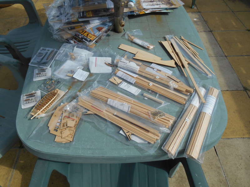

Well it's finally here, i started out by checking what was there and to see if anything was missing, after unpacking and laying everything out it seems the only thing missing is magazine no. 9, as far as i can tell its all there up to issue No. 80.

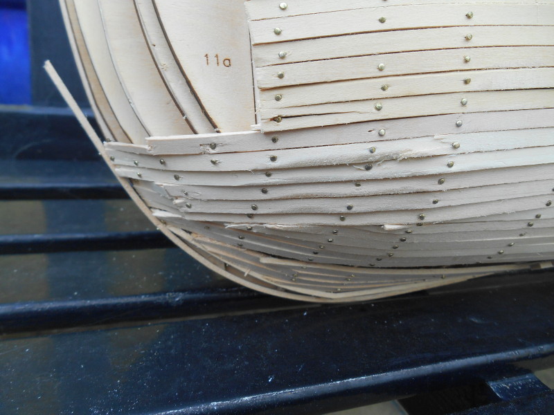

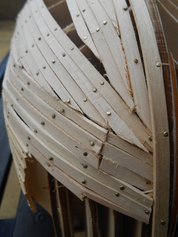

The ship itself on much closer inspection needs to be completely dismantled and started from scratch, i dont know how they did it but they managed to put most of it together without using hardly any glue, this is how it arrived to me.

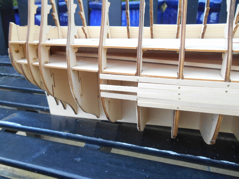

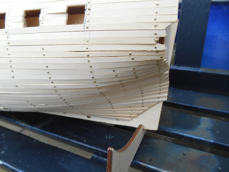

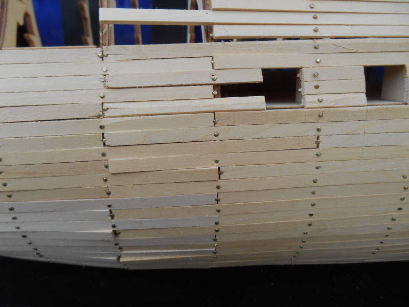

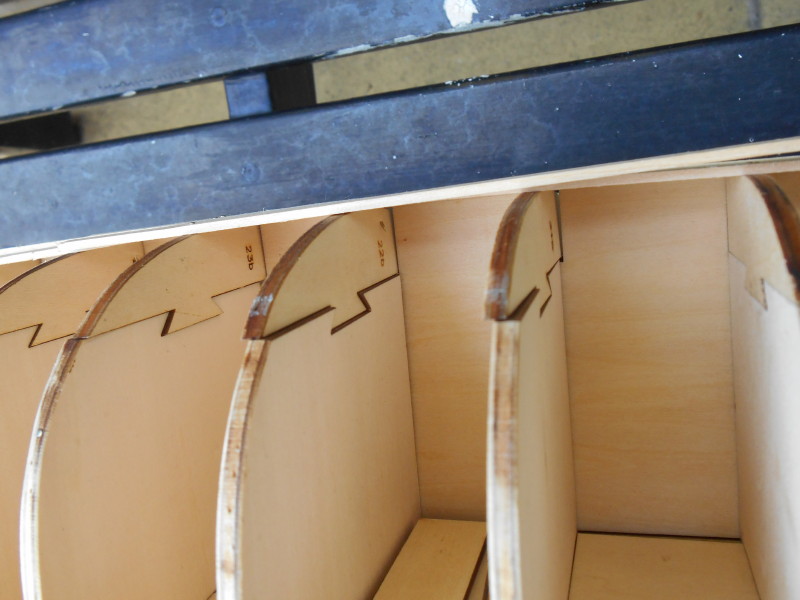

As you can see the ribs are coming away from their centres, there just isn't any glue, the only things holding them are the pinned planks, the decks are the same.

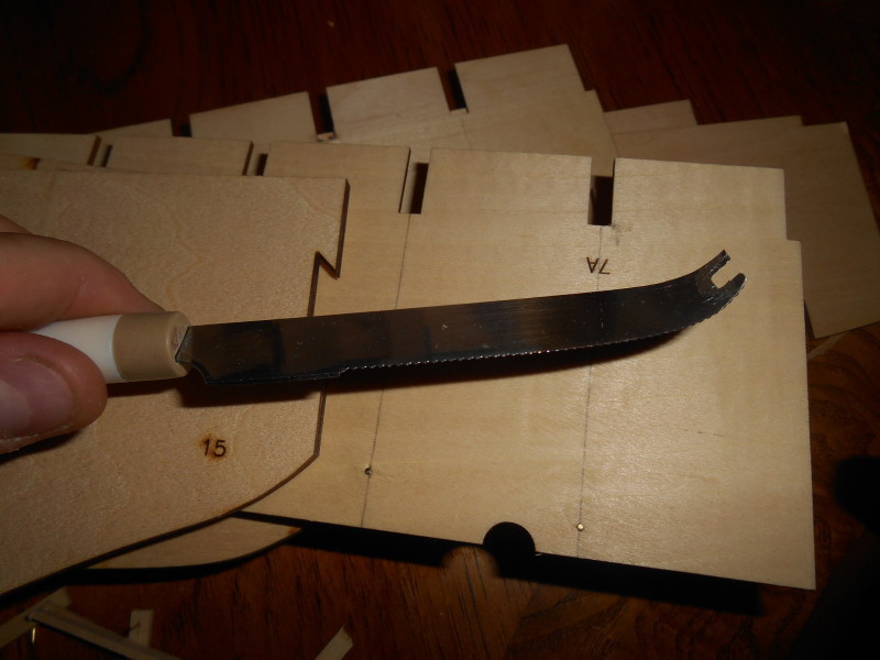

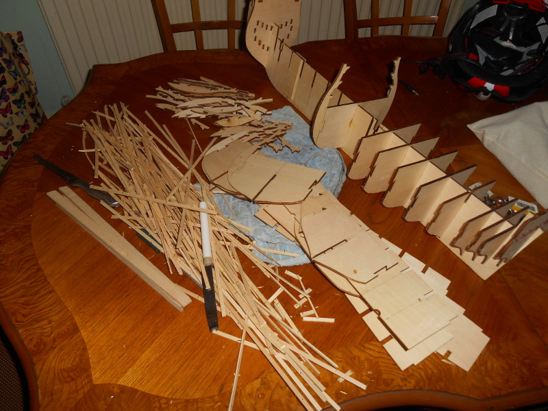

I took an old knife out of the drawer, heated it up and bent it then cut a groove the width of the ribs and used this as a mini crowbar to prise the planks off and keep as many intact as possible.

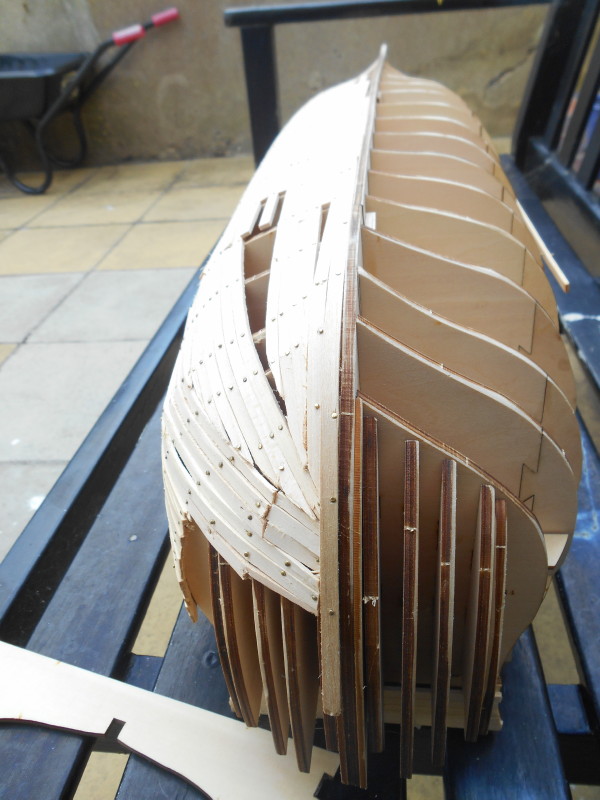

after taking the planks off most of the boat just came apart without any problems, no soaking in hot water or steaming ( so far ), to get it to this stage took around an hour and a half, thank god for the lack of glue, this could have been a right pain.

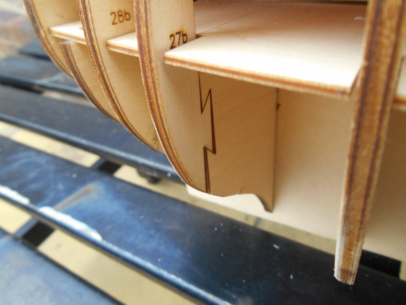

It got even easier Mick, i thought the centre part of the ribs were glued onto the keel so i got one of those steamers that you clean your house with to soften the glue, and even they were not glued they were just wedged in there really tight and not all the way in, i realised this after doing a couple because they were getting tighter with the steam, i couldn't have got luckier with this ThumpUp
