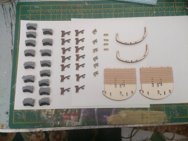

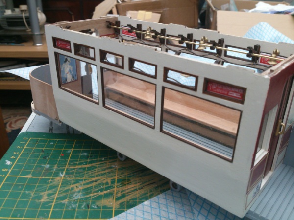

Hi bin good day on this, other side wall fitted and lower panels to main cab.steps assembled, and being painted at mo.handrail brackets stained and eye bolts fitted.bumpers started.lower platforms planked as far as I'm gonna go for now, incase need to make ajustments to slots for stairs.lamps painted.the gold is real powdered gold mixed with varnish.then painted on.cheers and happy moddelling mick. BigGrin BigGrin

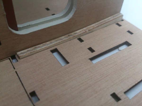

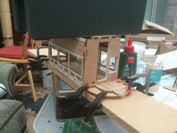

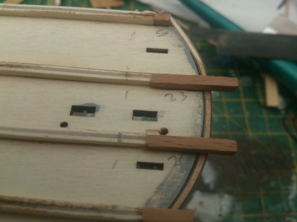

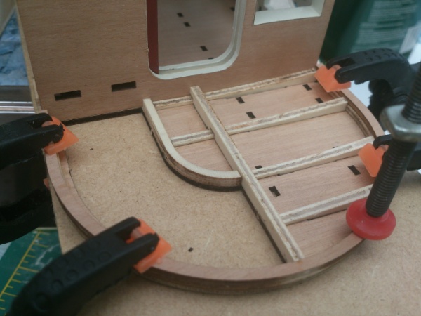

Hi just a small update.this is where roof not going to fit if you just glue parts in slots provided.and not check the fit first.as can see the slot next to the cab end wall is half a width out 1.5mm each end.so ya roof would not go on by 3.0mm overall, because support beam would prevent this.anyway easy fix just sand slot till can get this beam in next to end wall.all the other bits will need to be made to fit after, because this alters the spacing.but it easy to do.I choose to clamp it all on board with cab fitted to roof to keep all flat as glue dried.because the ends are very springy.I'm enjoying this build.just need to check before ya glue.cheers and happy moddelling mick. BigGrin BigGrin

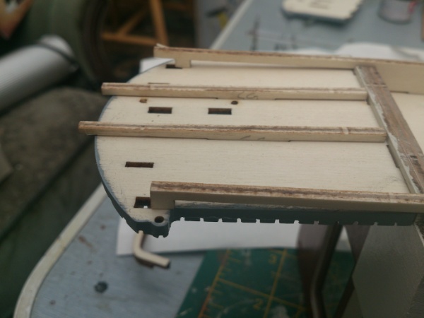

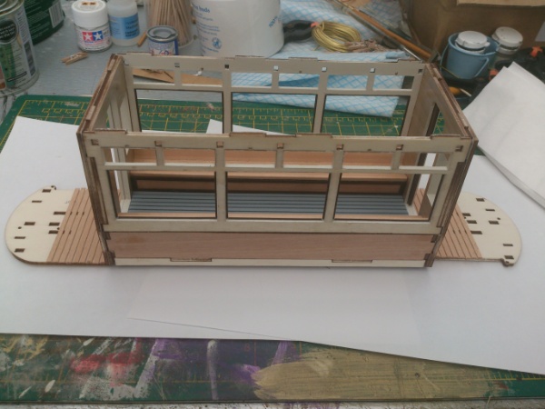

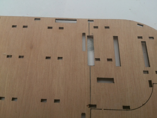

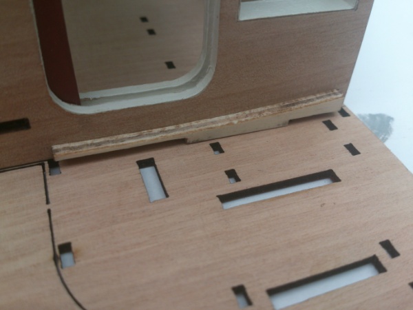

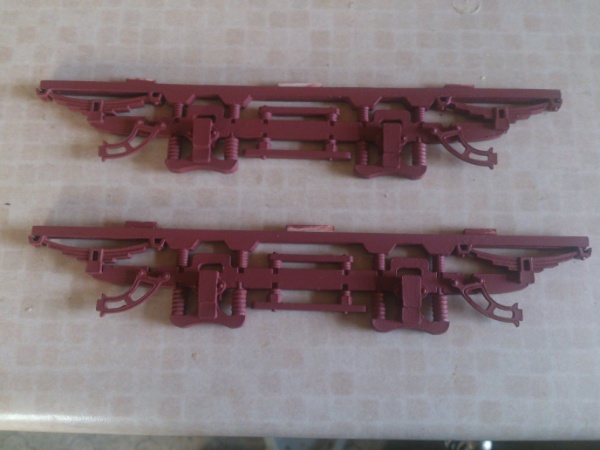

Hi well progressing slowly.more fit issues I'm afraid.had to alter the platform supports to fit. Curved the wall to fit this, was 3mm to short, so added strip to this.the bumper supports are 5mm to short.so had to put new bits in to increase length. To get gap between wall and bumper that suppose to be there.the suspension fitted well but the cross beams and wheel guard supports are to short and will need to be replaced.not done this yet so will post pics next time.bit more done to inside.and few posters added.I have reprinted mine on photo glossy paper. As look better than the paper ones.bin using border adhesive, type ya use for wallpaper, to glue these.ill make a decent model of this if it kills me.cause I'm not impressed with this kit at all.think ya got more chance of seeing a ufo, piloted by a yettee, landing on top of the loch Ness monster.than much of this fitting.I must express any opinions on this kit are purely personal. Hope anyone taking it on goes better than mine.cheers and happy moddelling mick. BigGrin BigGrin

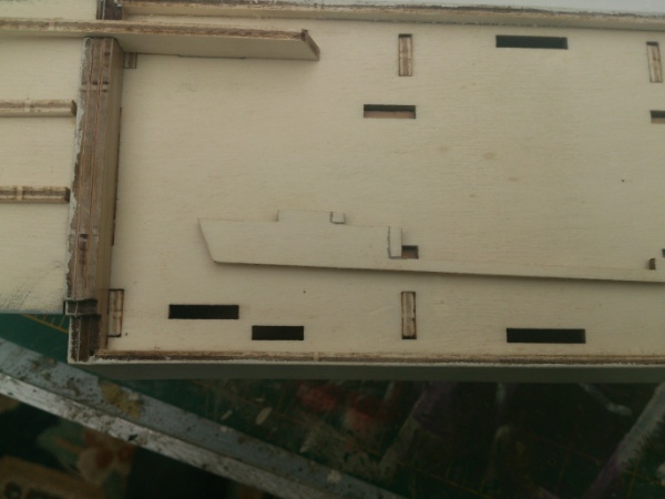

Hi one other thing I should mention.is the length of the base an benches, the instructions say 191mm for these, and this is what I made them to.but the sides are 189.5mm long.it is best to get these the same, ie 189.5 in my case.as I not realised the fit issues at this point.this dimension suits the roof.and will allow ends to sit square.was to late for me as would have meant ripping it apart to start again.so measure the base and sides.to see if you have any difference like mine.cheers and happy moddelling mick. BigGrin BigGrin

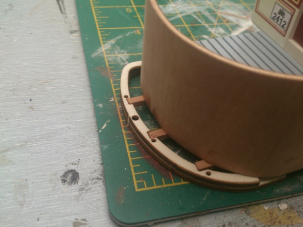

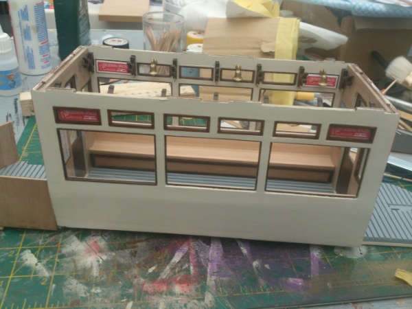

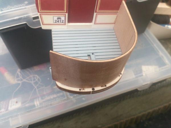

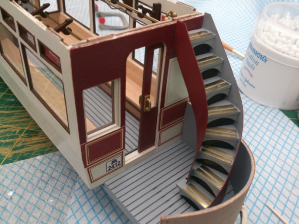

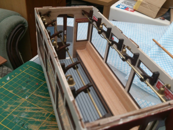

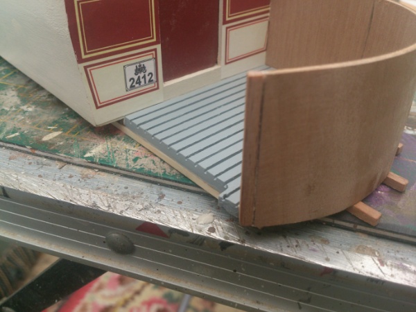

Hi first of all thanks for your kind comments much appreciated. The windows are now all in. 48 bits of window frame just for the 6 large windows alone.but time we'll spent me thinks, as no frames for these in kit.the inside now finished.the stairs I could not get there skins to fit, so made me own.they supply brass strip for treads.then paint them grey, I decided to leave them brass.the 2mm veneered ply round front took 5 hrs of soaking in water before it take that bend.clamped to model overnight to dry out.retained it's shape well for gluing. Cheers and happy moddelling mick. BigGrin BigGrin
