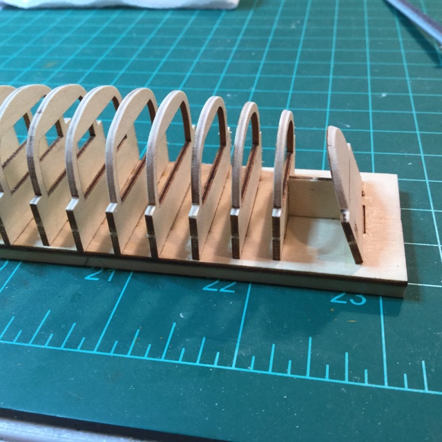

Ok, I completed the planking jig for the first of the ship's boats today. It all came out nice and square and is looking good. I am waiting for the CA to fully cure before I sand down the frames to fair it. I test fitted a plank to the jig and it seems as if the shoulders on frames 9 and 12 are a little high by about 1 mm to 1.5 mm. When I put the plank on it sits on the ledge of those two formers (both sides) and is up off of the others by the difference in height. I assume I should level those two with the others as part of the fairing process, is that correct?

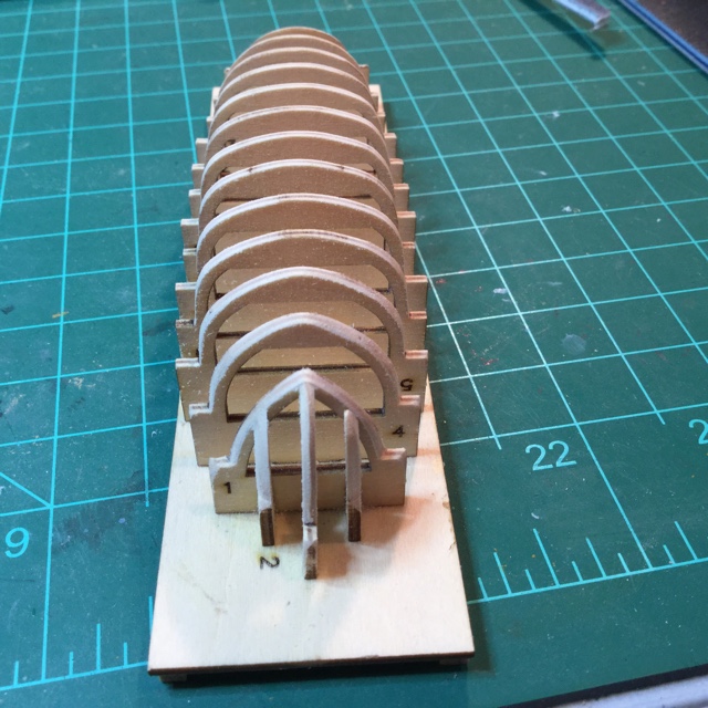

And here's the top view.
Now on to the cannon while this dries.

Hi Dominick, I would reduce the shoulder height on both those ribs to bring the first planking row into line. When you do this and when you fair the ribs, do this very gently as the ribs are very fragile. Take your time with it... Cool Cool

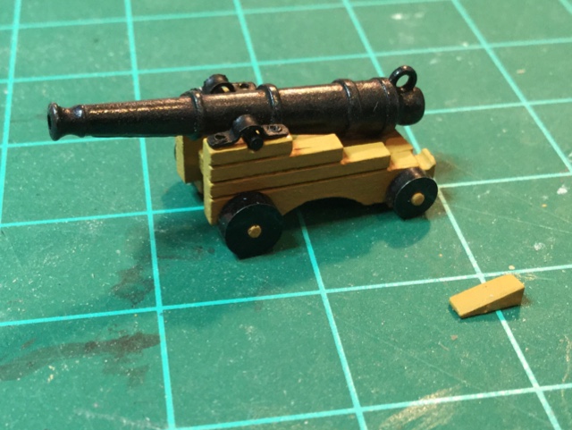

I started on the first of the ship's guns - a cannon. I notice in the official build diary that these get pinned to the deck later on. Given that, is it best to drill the holes for the pins now, when pinning them, or perhaps to glue them with a little CA instead of using pins? Also, how far in should the wedge be inserted - basically, at what angle to horizontal should the gun be to properly/realistically align with the gun ports?

First of what I expect will be many cannons completed in Trafalgar colors.

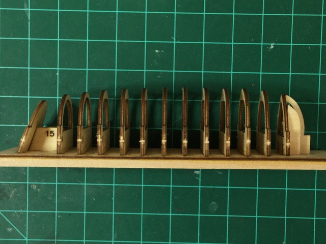

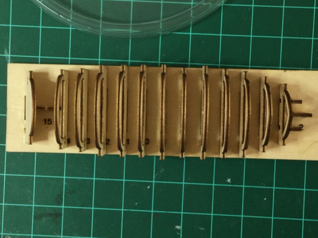

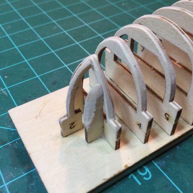

Frames for the ship's boat faired. I hope to apply the first of the planks this afternoon.

Some nice work thereBigGrin I used CA glue to fit my cannons rather than pins, just semed easier.
The wedge / gun angle on mine puts the gun barrell practically horizontal, this seems to match my gunport lower edge just right, btw there are 16 fully rigged cannons plus 2 stowed at the bowBigGrin

I think I will glue them as well. Seems silly to risk damaging them by drilling holes and pushing in pins. I imagine each wedge may come out slightly different so I may store them all with the cannons and glue them in as the cannons are mounted on the deck. This way I can probably keep them all consistent.
I hand painted this one, not too bad, but I think in the future I may wait until I have a few and airbrush them in a batch.

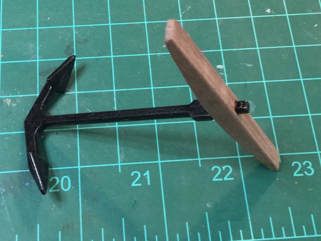

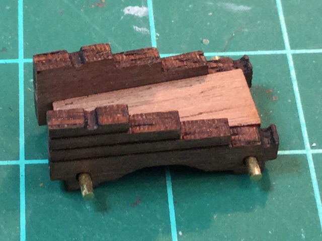

I made a little more progress today. Cut the channel in the anchor stock and glued the halves together and eased the corners. I still need to round the ends as shown in the official build log.
Right now the anchor isn't glued in it's just press fit. I figure it will be easier to complete the stock first and then glue the anchor in. I plan to go the heavy paper route as I think it will look more like iron banding than the thread. We have some nice heavy stock at work and a wheel type paper cutter that will give some nice, thin, even strips.
Even though the stock was painted black at Trafalgar, I just think the walnut looks way too nice contrasted with the black - so the walnut stays. BigGrin
More to come
