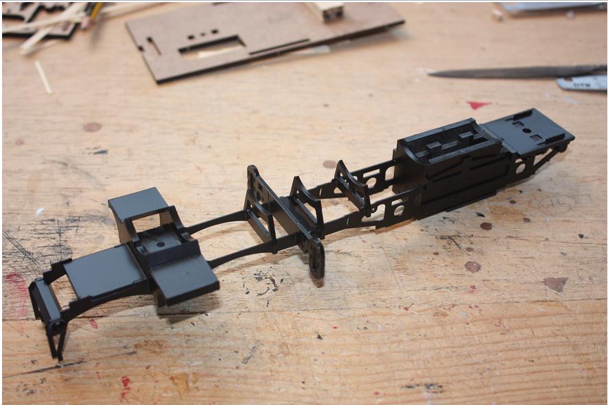

Whilst waiting for glue to dry I have sprayed the chassis of the engine
Decided on a Black Satin finish as I think this will look better with the other colours rather than a flat black

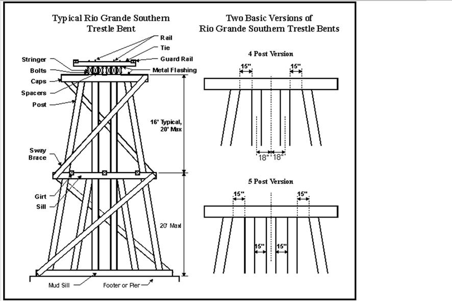

I liked (so have "borrowed") your idea of a trestle to act as a display stand for this Engine.
Found a reference to a "Typical Rio Grande Southern Trestle" and have used that for a template.

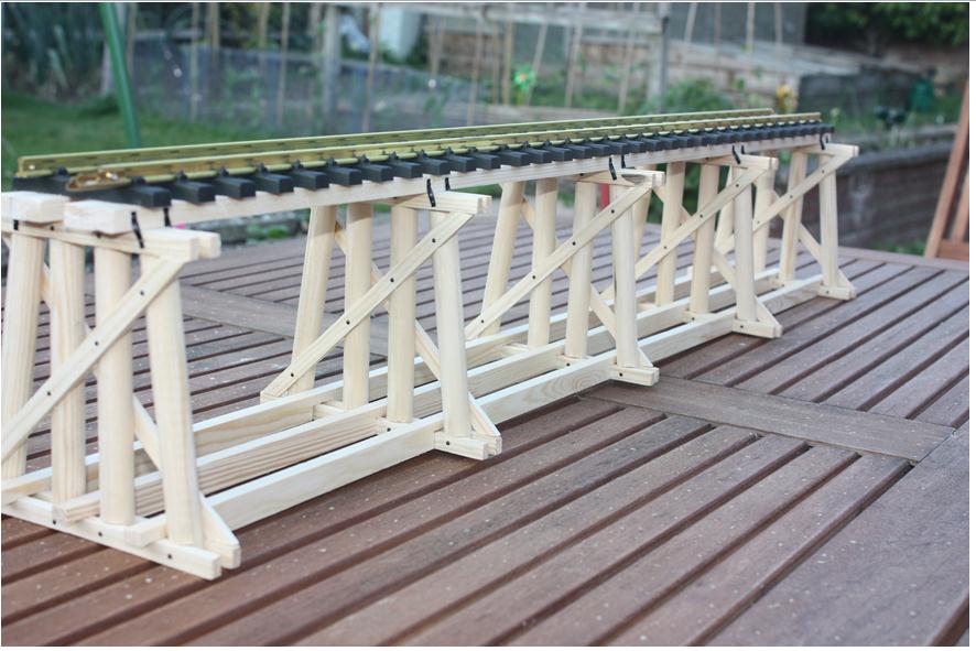

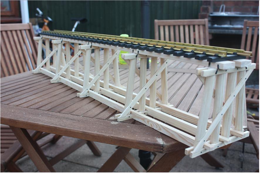

GilShapley
#30 Posted : 26 May 2015 21:40:33
Joined: 10/10/2010
Posts: 689
Points: 2,130
Location: Dorset
The Trestle is just about complete only now need to decide on the colour. What is the best way to "age" the wood ?
Its size is governed by the size of the model and the space I am going to display it.
The bridge is 36" long and 7" to the top of the rails. I used the plans I posted earlier as a guide plus looking on the web and the various pictures of trestle bridges. Rather than buy a kit this build is made from wood I had in my garage. The only thing I had to buy was the track. I assumed this would be 00 gauge but no, it is G gauge
Now I can get on with the actual model
BigGrin BigGrin BigGrin BigGrin BigGrin BigGrin BigGrin BigGrin

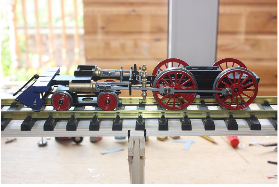

Having completed the Trestle Bridge I have now returned to the actual Jupiter Build
Attached is the chassis so far. Fitting the wheels to the axles was "fun" . The suggested method of a small hammer did not work for me and I will have some repair work to do to the paint. In the end I used one of the many clamps I have accumulated. The one I chose has plastic jaws which are quite large and I was therefore able to apply a steady pressure and ease the wheels on gradually. The clamp also has a racket which would normally allow the clamp to hold two items together without slipping. I was able to use this to gradually reduce the distance between the wheels until required size was reached.
1st of no doubt several cock-ups. There are two types of drive wheels. the front drive wheels have a counter weight the rear do not and yes you guessed it, I mixed them up. In order to remove the wheels I had to construct a mini puller so that I could remove the wheels without breaking them (They are a tight fit)
One of the advantages of being a senior citizen and keen D.I.Yer/Modeller is that you accumulate a lot of "bits and pieces" that you store because "they might be useful later" so I was able to cobble together a Heath Robinson device
The Boiler is next. Have already constructed the wooden parts and am now moving on to the metal covers
More later as the build proceeds
