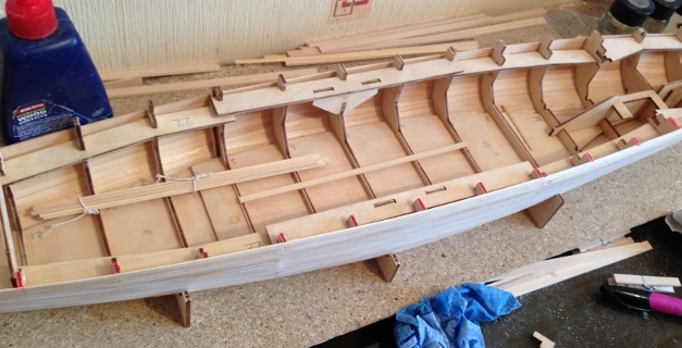

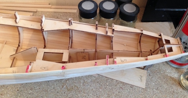

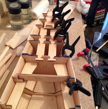

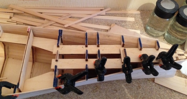

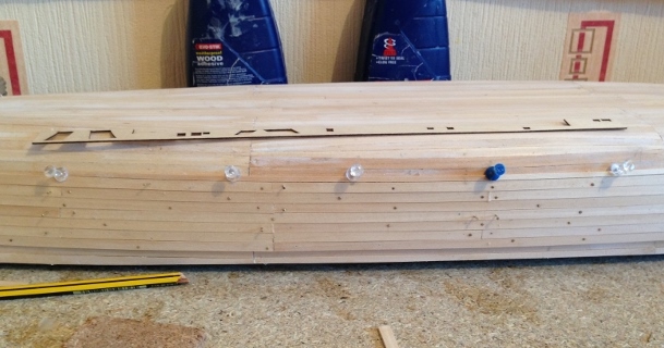

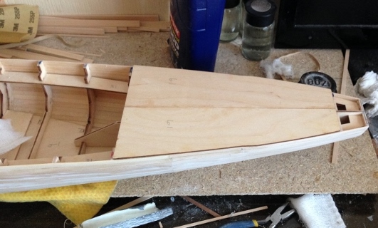

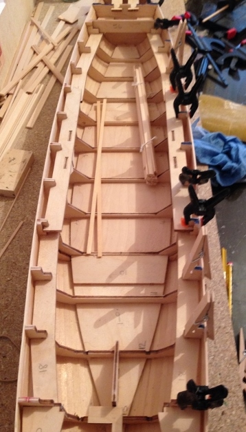

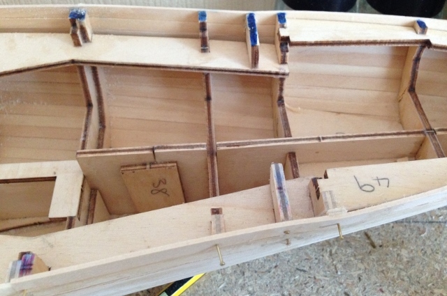

BigGrin Evenin' Folks
Huh Decided to deviate from instructions Blushing Uh Oh Blushing
Instructions want me to strengthen the hull planks by using surgical gauze and white glue next and then fit the forward deck and then finish off the planking to the top off the frames
I have decided to plank to top off frames 1st this will allow me to strengthen ALL the hull planks
Blushing Used a felt tip to colour in the top off the frames this will tell me when to stop sanding Blushing Hopefully
LOL Thinking pink is a bit girlie changed to blue
Crying I have noticed that the ledge that starts to replicate the armour plating is virtualy unnoticeable that runs along the hull
This is probably due to not enough care taken when sanding the frames and 1st planking
The 2nd planking is very thin and after sanding will again just look like a bad crease
I am hoping that when the time comes using a thicker plank along that line will help rectify this issue
budgie attached the following image(s):

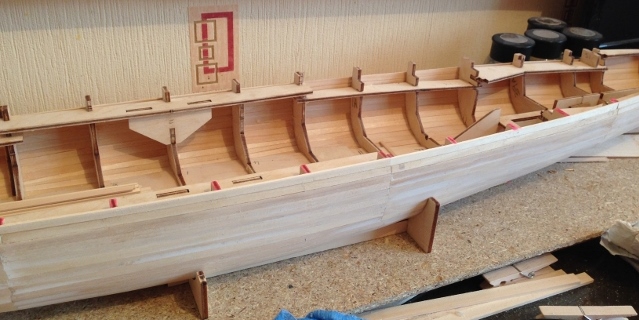

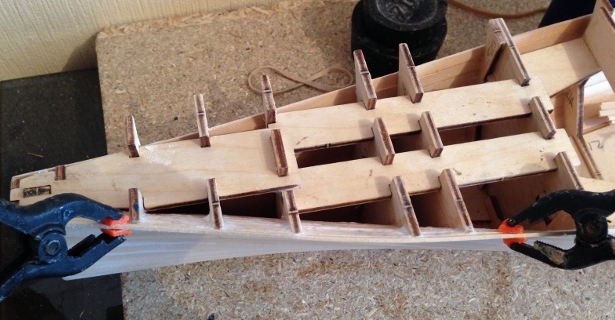

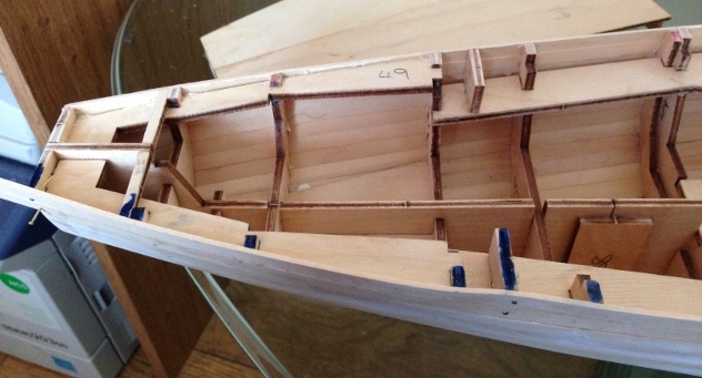

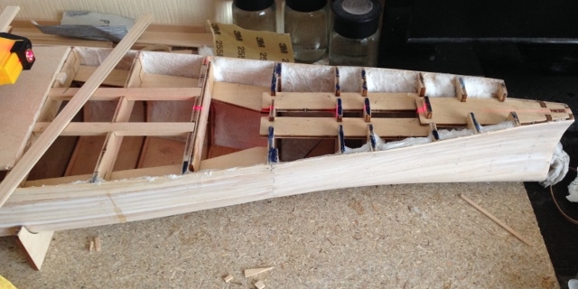

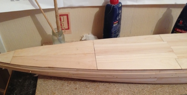

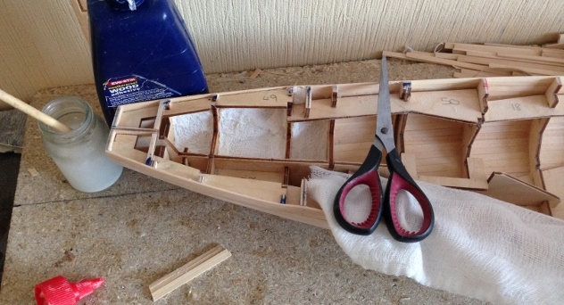

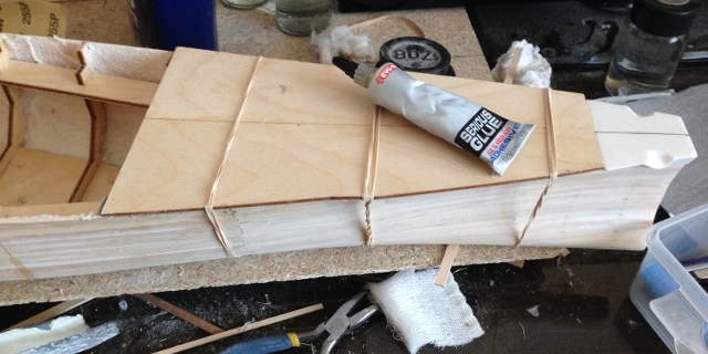

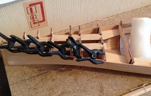

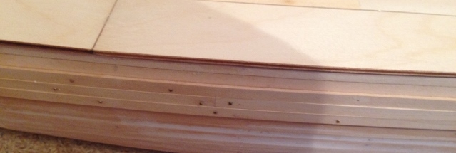

BigGrin Hi Folks Crying made a boo boo
1st pic shows a slight bend in planking which is correct Cursing but only on one side...Blushing silly me
2nd pic shows this rectified by loosening the top two planks and gluing a bit of planking to a couple of the frames to make them wider to push planks into the bend
Cool Have started strengthening the planking using gauze and diluted wood glue as per instructions
Cool Have also glued the forward deck on and keeping it in place with use of elastic bands
Blushing There is a slight gap between the deck and last row of planks which i will fill in with putty later
Cool Also glued my first resin piece
Instructions recommend 2 part epoxy but the tube of "serious glue" has done the job. BigGrin That part aint going anywhere
I hope it is as good as sticking brass to wood and i do not relish the idea of using epoxy for all those parts
Crying Ah well back to the gauzeing
Thanks for lookin'

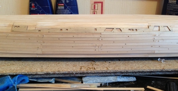

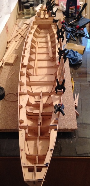

#33 Posted : 19 April 2015 12:14:53
Joined: 20/03/2010
Posts: 1,199
Points: 3,473
Location: Glenrothes

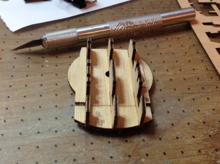

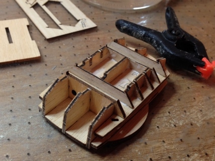

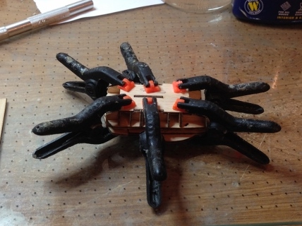

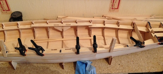

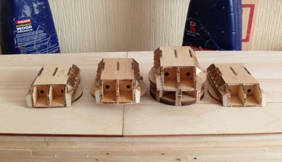

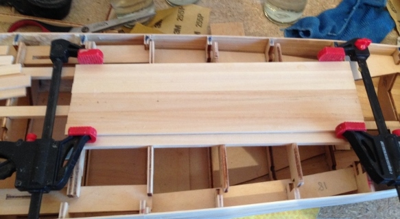

BigGrin Mornin' Folks......been plodding along with the false deck
Blushing Have noticed that if you do not clamp the strips together, the ply sides that has the shape of the deck can overlap the hull by quite a bit
Cool I suppose if you sand the inner edge this will rectify the issue as you do not want to sand the outer edge in case the shape gets distorted
LOL Pity i never thought of that before redoingLOL

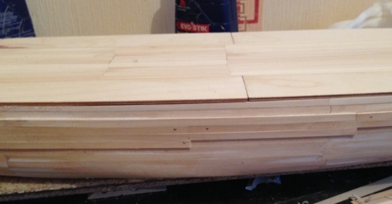

Cool Also made a start on the 2nd planking using the same thickness off planks as the 1st planking (from the "spares") so the armour plating ledge is more noticeable
Confused Was concerned about doing this as there are thinner detailed parts to be added to the hull (ply with portholes) but a test fit seems tiddlyboo BigGrin
Laugh Getting bored with the planking so started the big gun turrets Anton Bruno Cesar and Dora
Thanks for lookin'

Crying Back to the planking
The "cooling water openings" are to be placed 9 rows of 5mm planking down
Cool As i am using 6mm wide planks i only need 7 rows Flapper Yippee
Crying and a half Blink
