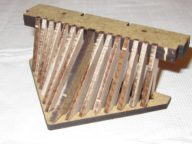

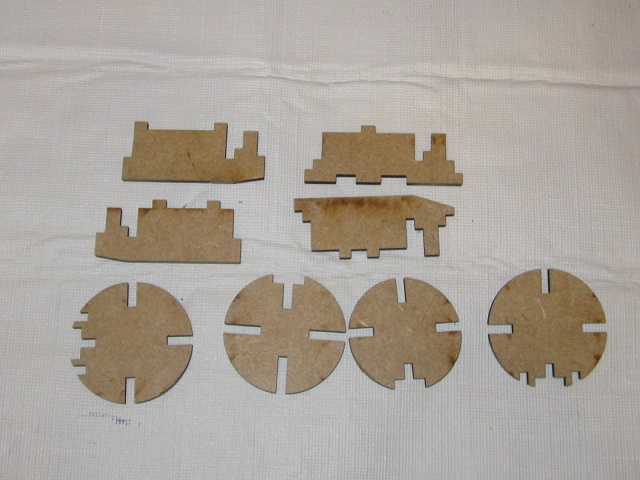

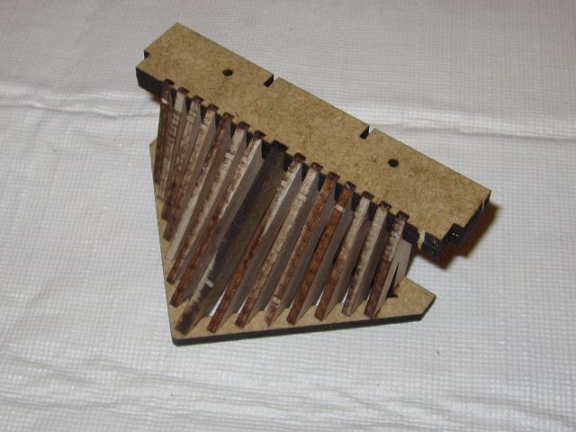

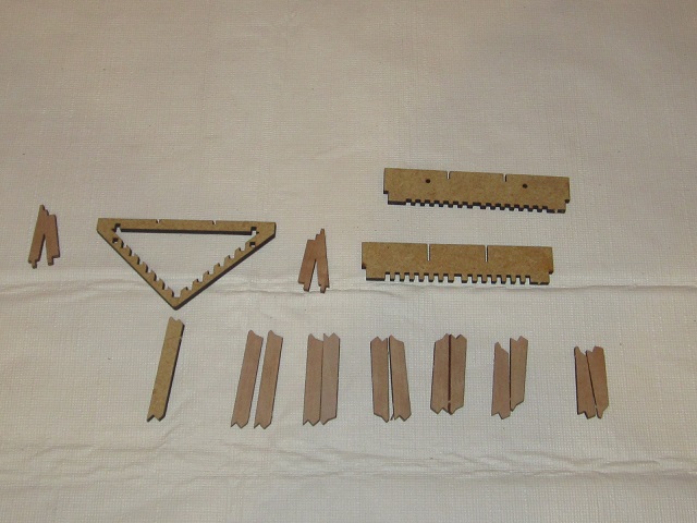

The next part is the pilot. Now I hear you ask what is a pilot doing on a train? Well the pilot is the device on the front of the train used to deflect objects out of the trains path. Another term used is "cowcatcher" although in USA of 1860s it was far more likely a buffalo catcher.
This part is made of laser cut wood.I used 5 minute epoxy to attach the two outermost beams connecting the base to the top and then used superglue to fix the rest of the beams.The fit here was excellent.

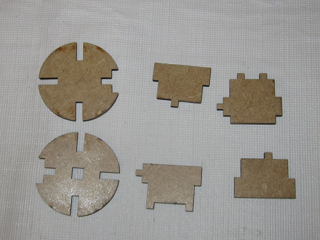

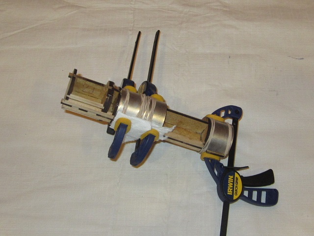

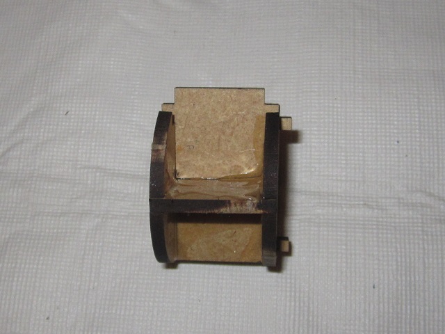

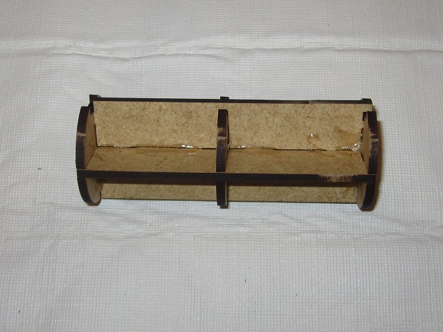

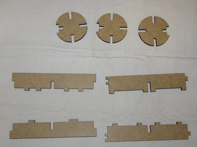

Next up the boiler.
The boiler is made of a wood frame that thin metal plates. There is a change in diameter of the boiler from the rear to the front so you need to build the 3 separate parts of the boiler and then assemble them onto the frame and measure where you need to file down and align the 3 pieces.
I also decided at this point to depart from the build sequence.The boiler, cab and tender are all made from a wood frame with metal coverings. I am a little nervous about bending the metal so I figured I would build all of the wood frames before moving on to the metal.
So here are the 3 sections of the boiler;

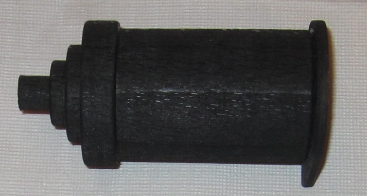

More progress on the boiler
Now the frame is built it is time to cover the frame with the thin metal pieces.These are flat pieces that need to be bent to shape and then glued to the frame.I got to use my bending tool at last (actually it is just a piece of wood painted black).
I was nervous about how well the metal (I think it is tin) would bend.It actually was pretty easy to bend.It did retain some springiness though and I had to clamp it in place until the epoxy had set.
Here is the bending tool.

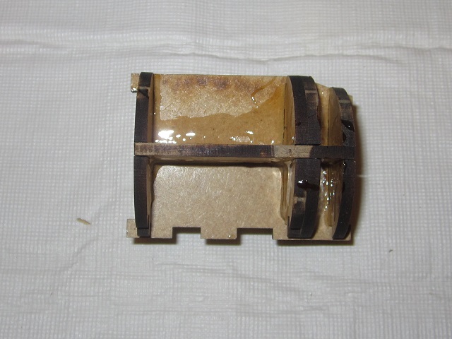

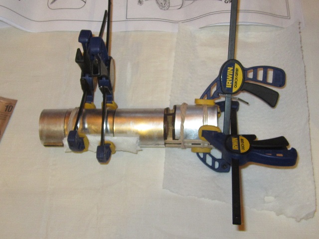

#39 Posted : 23 April 2015 02:21:51
Application of the first pieces of metal.I used my miniature clamps to hold everything together.I left the clamps on for 24 hours.I tried 12 hours and one of the pieces popped off the frame.

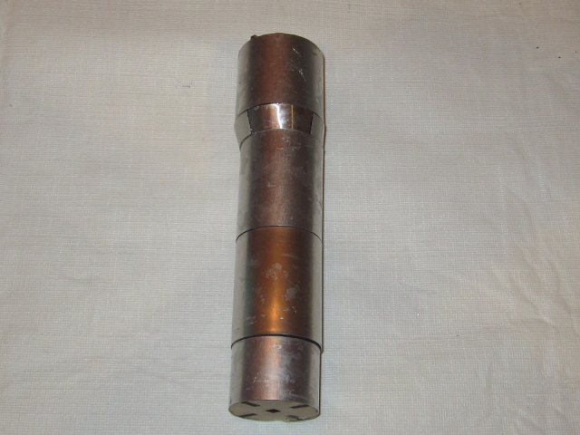

#40 Posted : 23 April 2015 02:24:04
Here is the boiler with all of the metal parts added.
