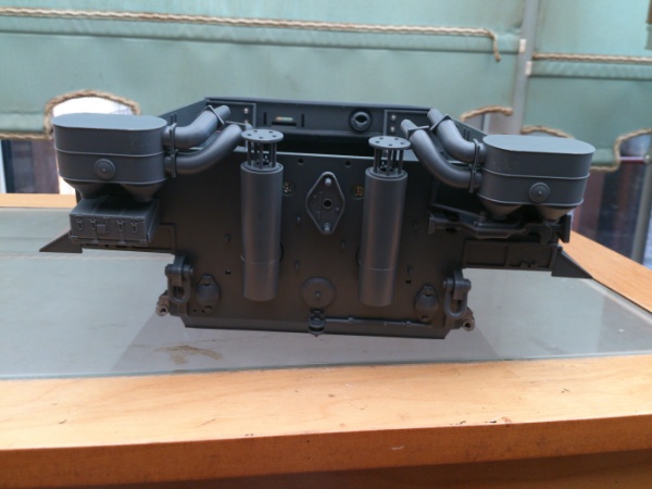

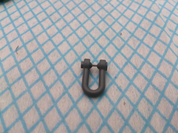

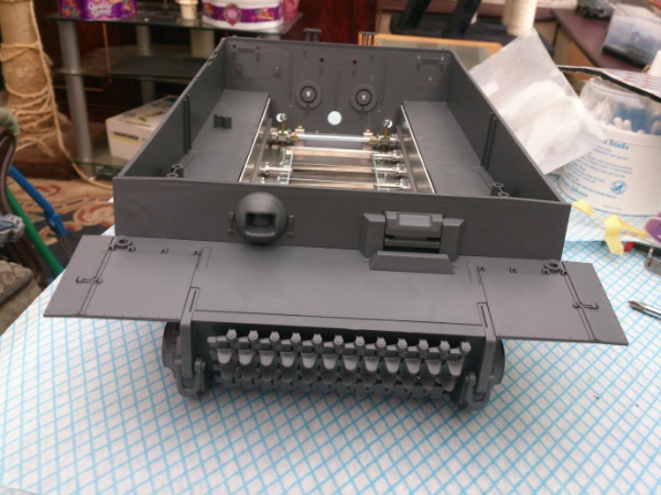

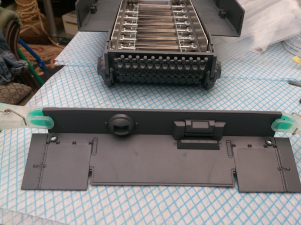

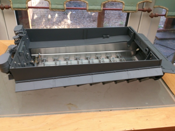

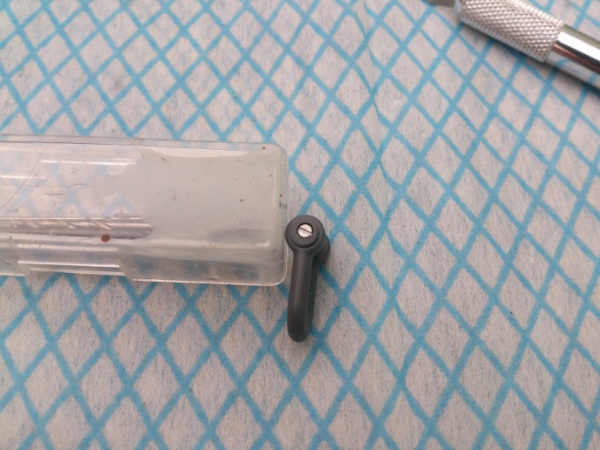

Hi first of all a change of plan on the etch.after building some of it up decided it much to delicate for working model.you were right Steve.I will use the grills.an do bit of scratch building ie the s mines. Anyway I modified the towing loops as they nearly always fell off on previous tanks never to be seen again.I drilled an tapped them m1, to take steel bolt , much stronger now.the back end all bolted on for pic purposes, as will need taking off for painting.remember not to put glue on side fenders at front where they contact front armour plate.as this needs to be removable for maintenance purposes.next job get some paint on her.cheers an happy moddelling mick. BigGrin BigGrin

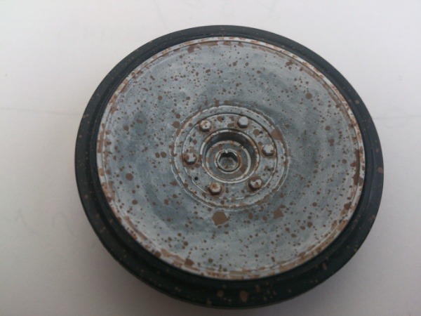

#25 Posted : 03 April 2015 19:52:27

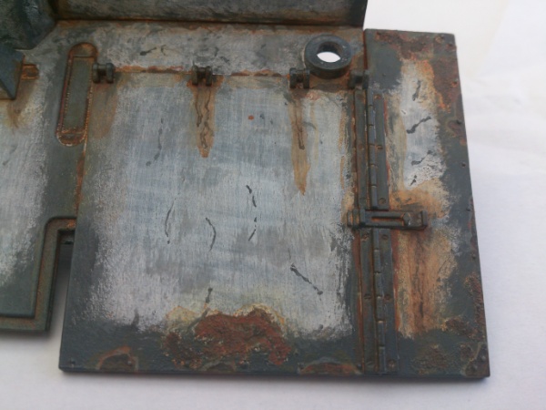

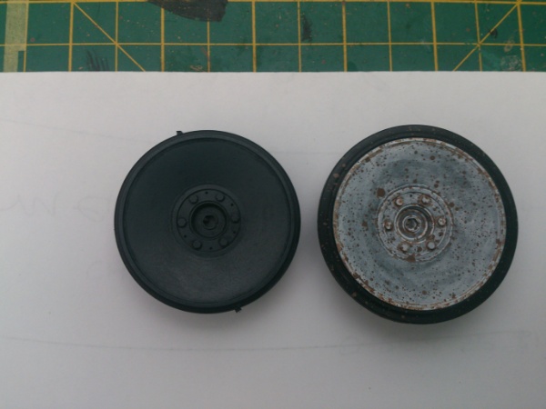

Hi bin playin around with the paint finish want on this tank.it be basic grey with worn winter cam.I primed it with Halfords grey , then matt black.two coats of german grey drybrushed on, don't own a spray gun.then 3 coats of white wash.last one washed through in places.then rust around bolts and welded seems, as thought this be where they likely to rust through first.then finally mud flicked on with toothbrush. Anyway kinda like it so will go with this on rest of tank.the last pic comparison with plain grey wheel.cheers and happy moddelling mick. BigGrin BigGrin

BigGrin Nice work on those wheels Mick they do look greatCool
#28 Posted : 04 April 2015 00:03:12
Fabulous effect Mick, very well done....Drool Drool
#29 Posted : 04 April 2015 11:41:37
Excellent work Mick and those wheels look very realistic - well done!! Drool Cool ThumpUp
Very interesting the way that you've achieved the effect, thanks for the insight and also that you've carefully thought about where the rust might occur naturally rather than just being completely random when applying it? It's also especially interesting that you achieved it with a brush? Just goes to show that an airbrush isn't necessary if you take your time and use thin enough paint, then it becomes hard to tell the difference between the two methods and imho brush painting is easier (and more fun)?

#30 Posted : 04 April 2015 15:31:02
Hi thank you all for your kind comments much appreciated. Me really enjoying this.me trying to put me self in the shoes of lowly private or crewman, given a tub of white wash an a brush, given the job of paint that.this will be one of the 503rds division tank.I see from my tiger reference book they had there own unique storage box on back of turret.so will be scratch building this.cheers and happy moddelling mick. BigGrin BigGrin

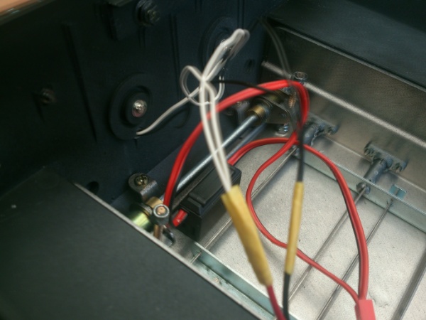

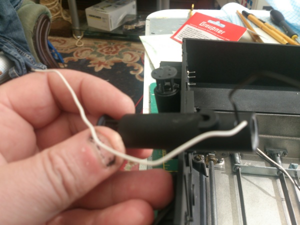

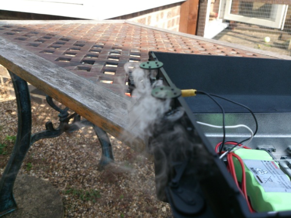

#31 Posted : 09 April 2015 17:28:56

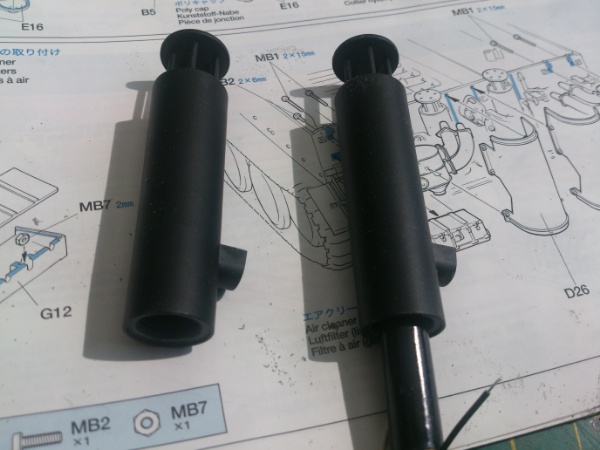

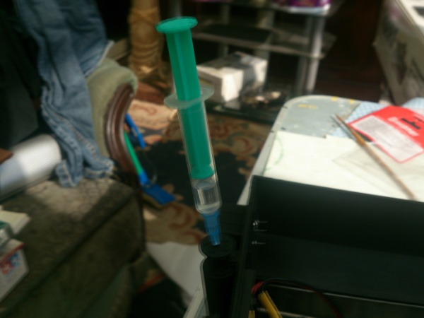

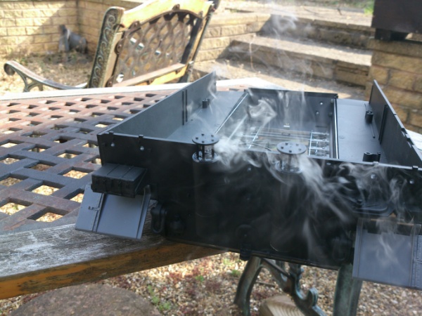

Hi thought I'd show small update of fitting smoke units in me tiger.eh not part of kit so are an option I decided to fit.pretty easy job in tiger as the small boat ones from groupner fit real nice. Cheers and happy moddelling mick. BigGrin BigGrin

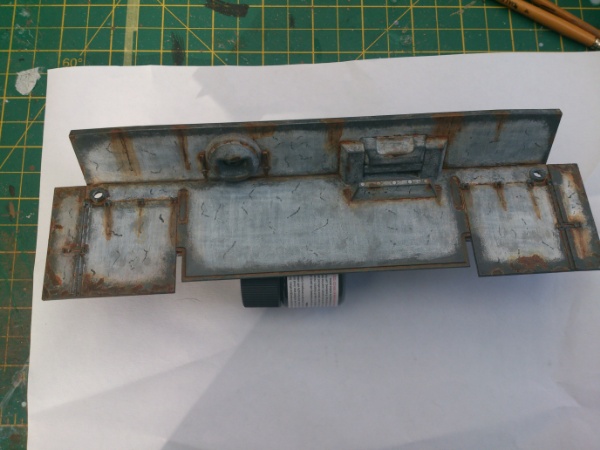

#35 Posted : 16 April 2015 19:20:48
Hi still playing around with paint.this only second model in me life I tried to weather.so trying to sort out what I want is fun.but this be how like this one rather tatty old tiger.the pitted rust is just sawdust glued to model prier to painting. Probably mad idea but seems to work.cheers and happy moddelling mick. BigGrin BigGrin .

#37 Posted : 16 April 2015 22:10:56
Awesome!! Cool That rust looks so realistic ThumpUp
#38 Posted : 16 April 2015 22:16:58
Question. The smike generators you arenusingndo they very output with the engin speed or just a constant flow?
#39 Posted : 16 April 2015 22:17:50
Question. The smike generators you are using do they very output with the engin speed or just a constant flow?
#40 Posted : 16 April 2015 23:14:03
Hi jase smoke generators are constant flow. running off own battery and switch.be honest would not know how to do them in step with engine revs.cheers mick.BigGrin
