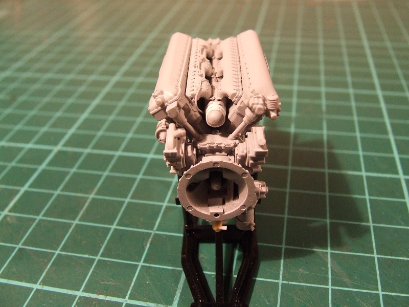

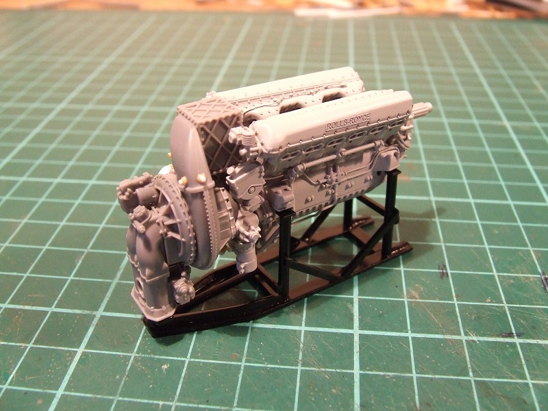

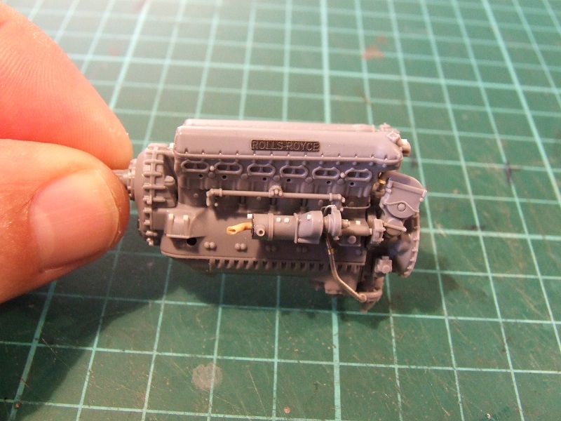

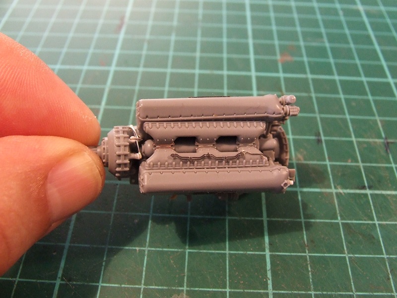

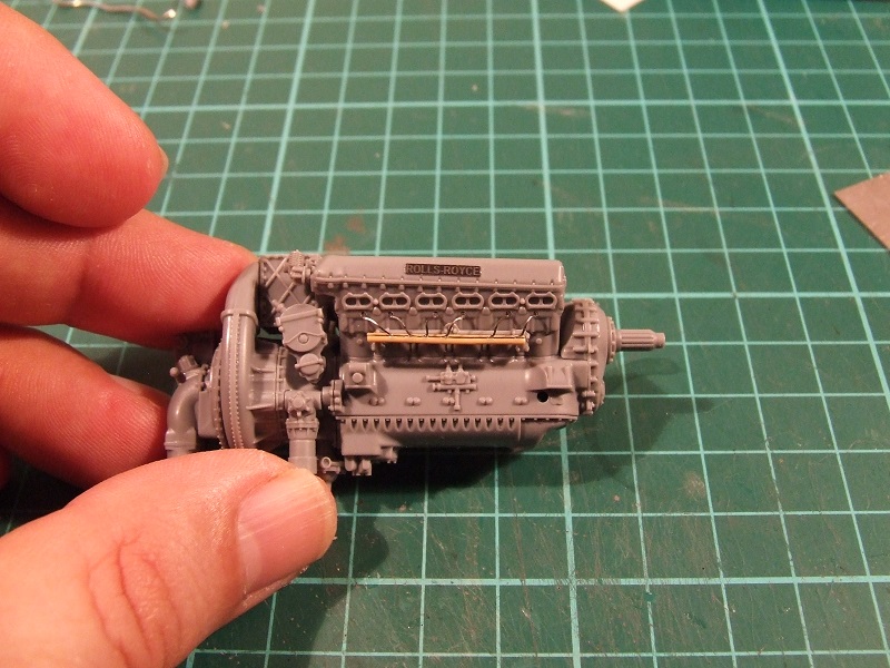

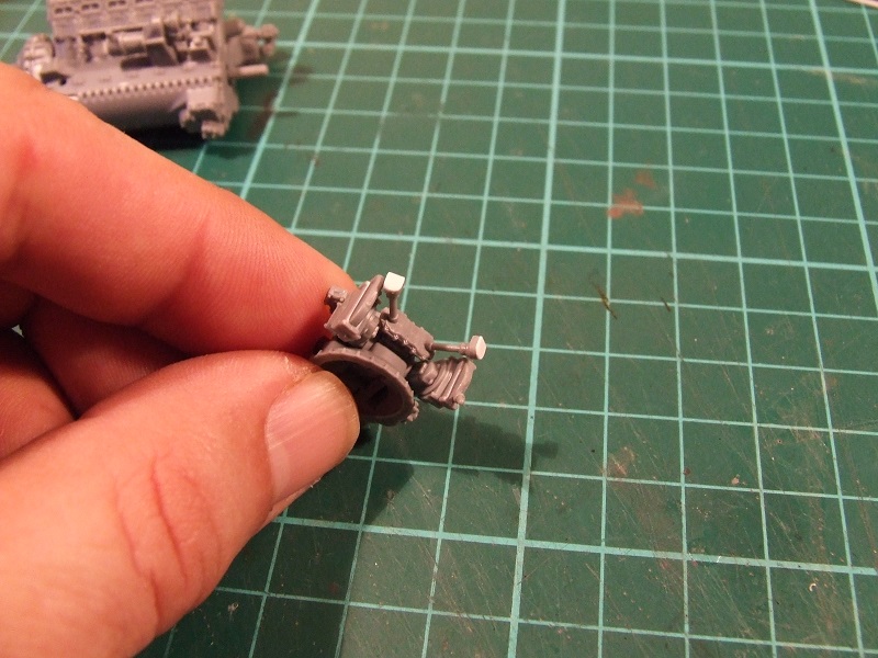

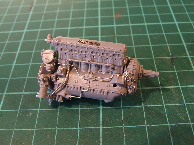

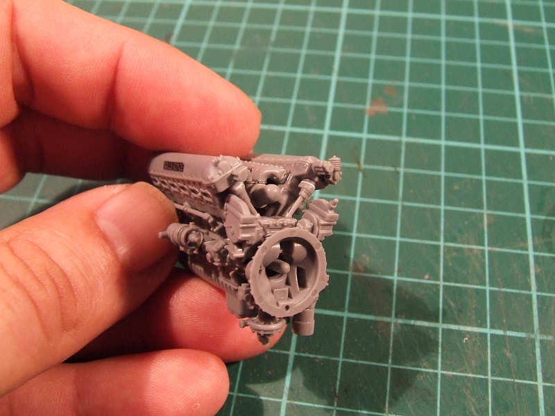

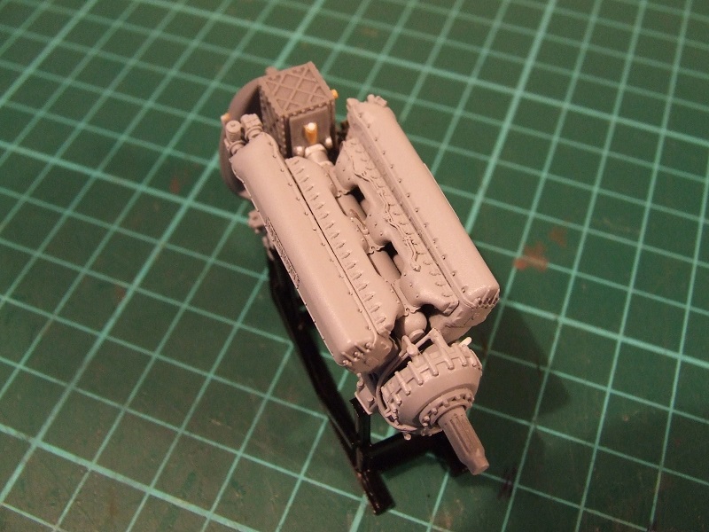

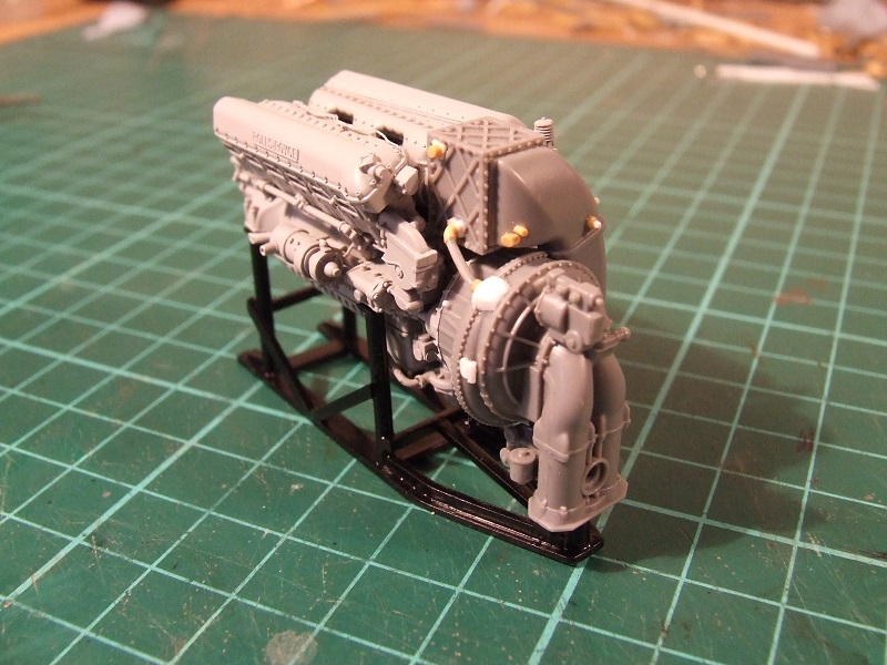

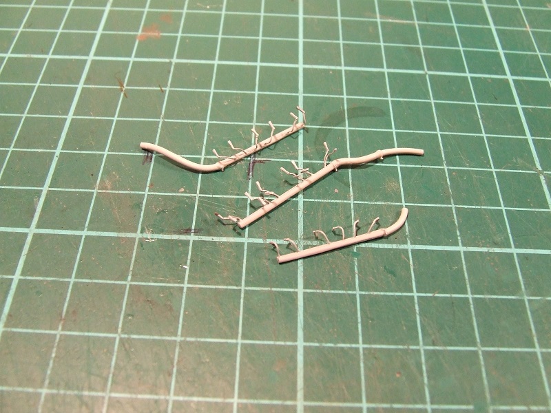

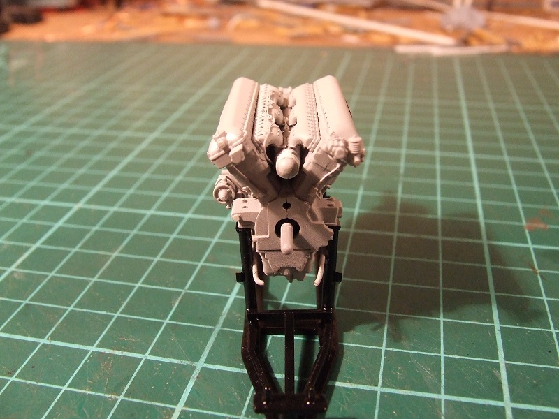

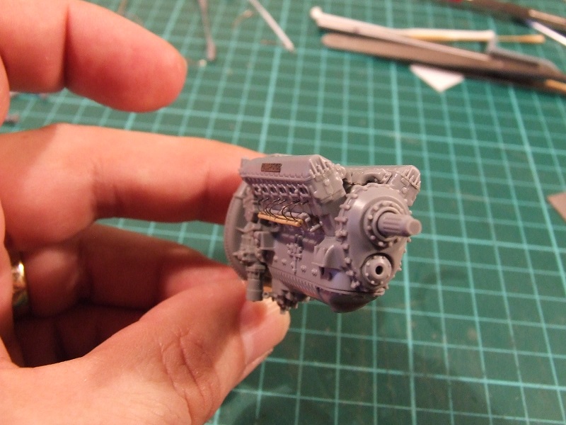

I’ve been very busy lately with work so haven’t had a lot of modelling time, but I have been snatching the odd hour or two here and there and have managed to add some of the extra detail that I said I was going to be scratch-building on the Merlin engine. This kit is one of, if not the most detailed Spitfire plastic kits out there, but going through my very comprehensive reference material I have come to realise that actually there is quite a bit of detail which isn’t included and whilst this is a nice rendition of the Merlin as a standard build, some of the missing detail is quite basic and really should have been included for the price, so building it as supplied in the kit really didn't satisfy my eye for detail. I want to take this model to a much higher level, so it seems I have a lot to do and a long way to go before it even resembles a complete Spitfire Mk.IX engine.

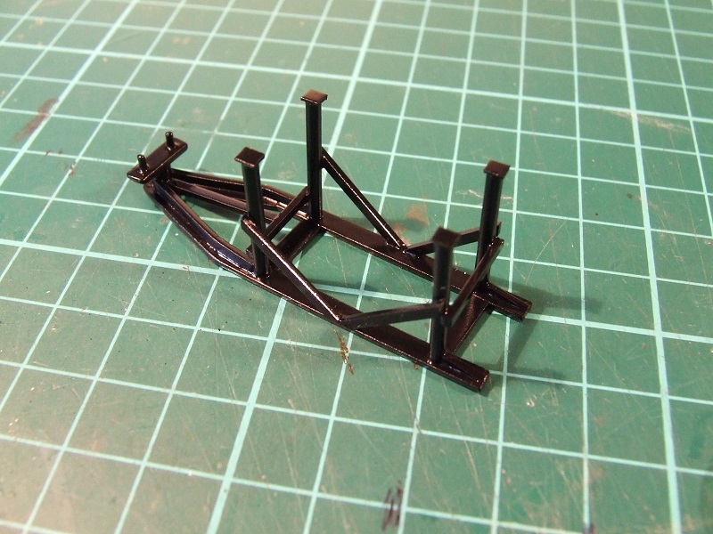

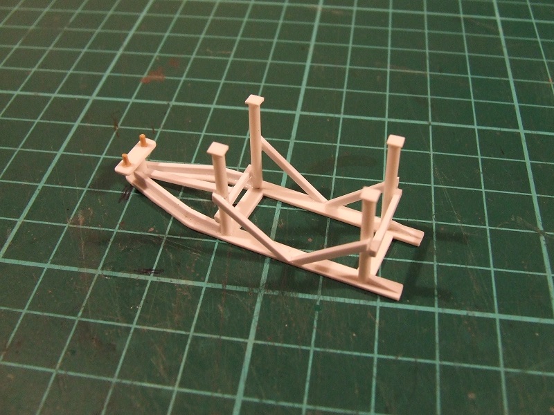

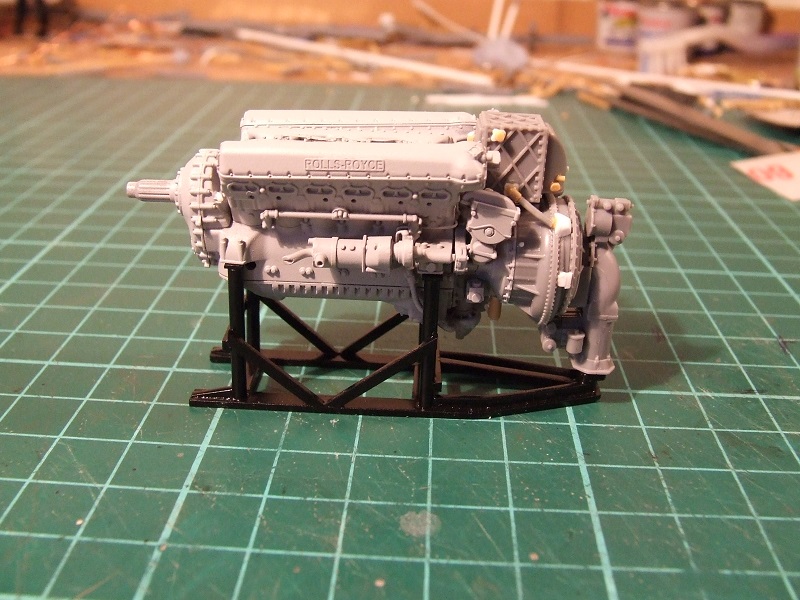

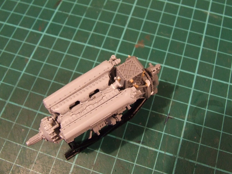

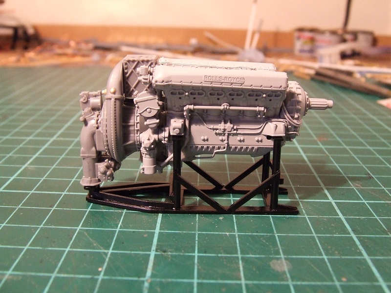

Before detailing the engine I decided that I wanted to have an engine stand to display it on and also to make it easier to photograph the work for my diary, so I set about building one out of plastic rod, stretched sprue and sheet and then sprayed it gloss black to add a bit of appeal.

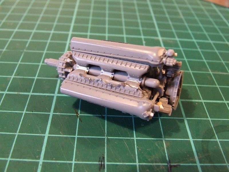

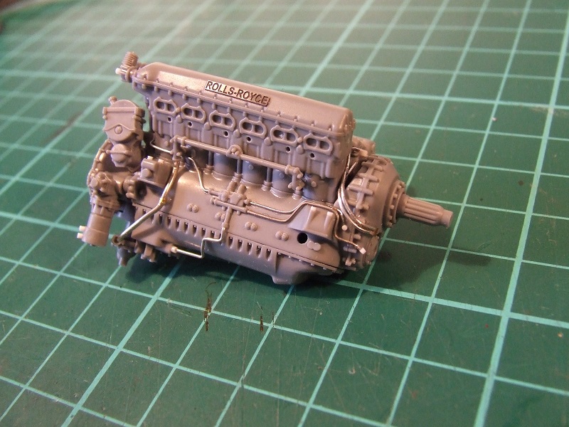

Next job was to start on the details. Before I could do that though, I noticed that there was a distinct gap between the underside of the rocker covers and the camshaft drive tubes which fit beneath them so I added some shims from plastic card to take up the gap – not Tamiya’s usual standard there!!

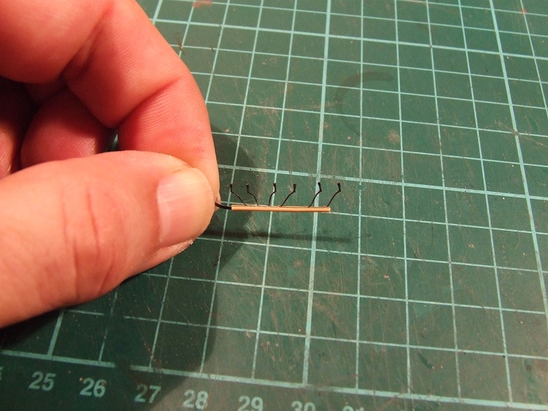

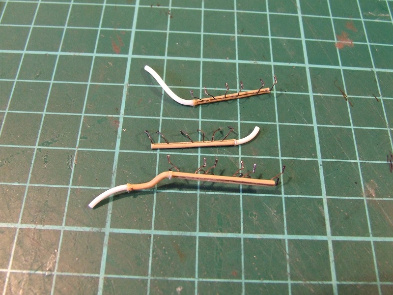

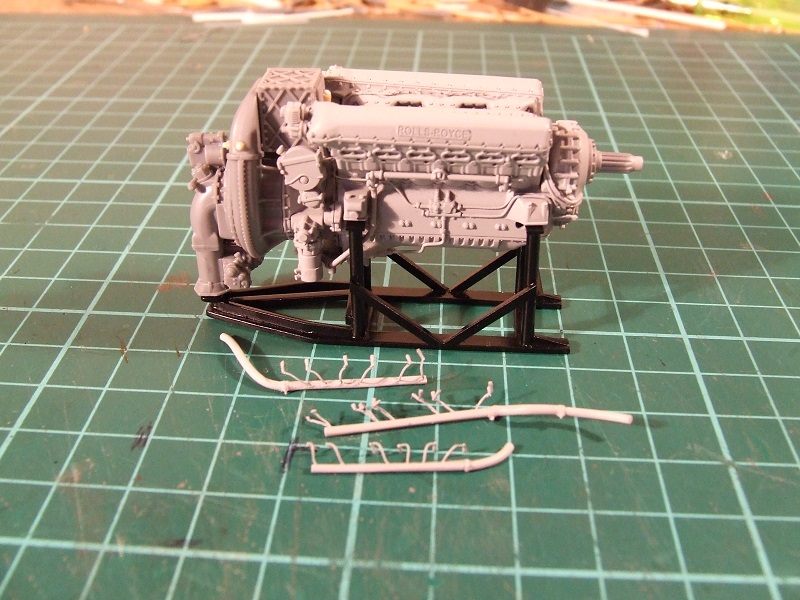

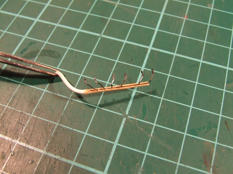

Next job was to add the Eduard etched brass ignition harnesses, which included the HT leads and the spark plugs. However, the harnesses themselves look a little 2D in flat brass, when they should be more tubular, with the leads and plugs being passable as they were once folded and glued and a bit of paint will also help them look more 3D. The rather flat etched brass ignition parts can be seen in the photo of the Eduard fret below.
To make the harness tubes more 3D, I added a semi-circular strip of stretched sprue to each side of the flat brass, thus giving a more tubular appearance which should look fine when painted.
On the real Merlin the harnesses connect to a quite large diameter braided tube, which connects to the magnetos and the braided tubes also serve the purpose of reducing radio interference from the high voltages that run through the ignition leads. These were replicated out of stretched sprue and added to the ignition harnesses. I also added some very small pieces of fine sprue to indicate the ‘screw’ part of a circlip (which will be suggested by painting a silver line around the connection later). I also drilled some holes in the cylinder heads to receive the spark plugs when they are fitted.

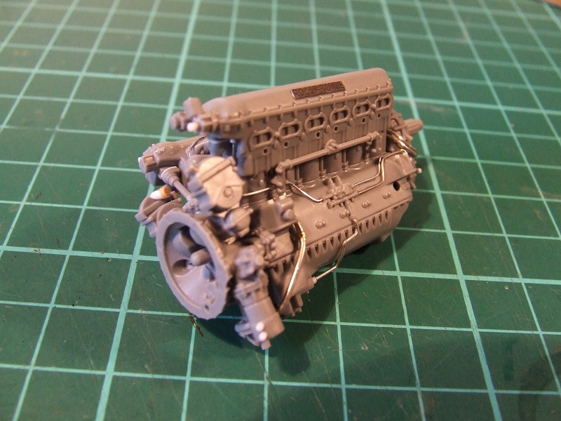

The ignition harnesses will be fitted to the engine once it has been painted. I then moved on to fabricating some of the various high-pressure and low-pressure oil pipes, coolant pipes and various other pipes that keep the engine cool and lubricated and also some pipes around the reduction housing at the front of the engine which will connect to the propeller pitch control assemblies later. All of the pipes were made from various thicknesses of fuse wire, floristry wire and anything else that I could find in my scrap box. I also added some missing bolt heads, pipe unions and other items out of small sections of stretched sprue, which you can just see in the photos below. Some of the pipes are still to be connected at one end where they connect to the wheel housing as I want to be able to disassemble the various engine modules to make it easier to paint them. One or two small etched parts were added like the priming 'volute' pipes on the induction manifold and a small plate on the end of the intercooler pump, where I also drilled out a vent and added an air cooling inlet to the pump out of stretched sprue which was bent into a shallow 'S' shape and drilled.

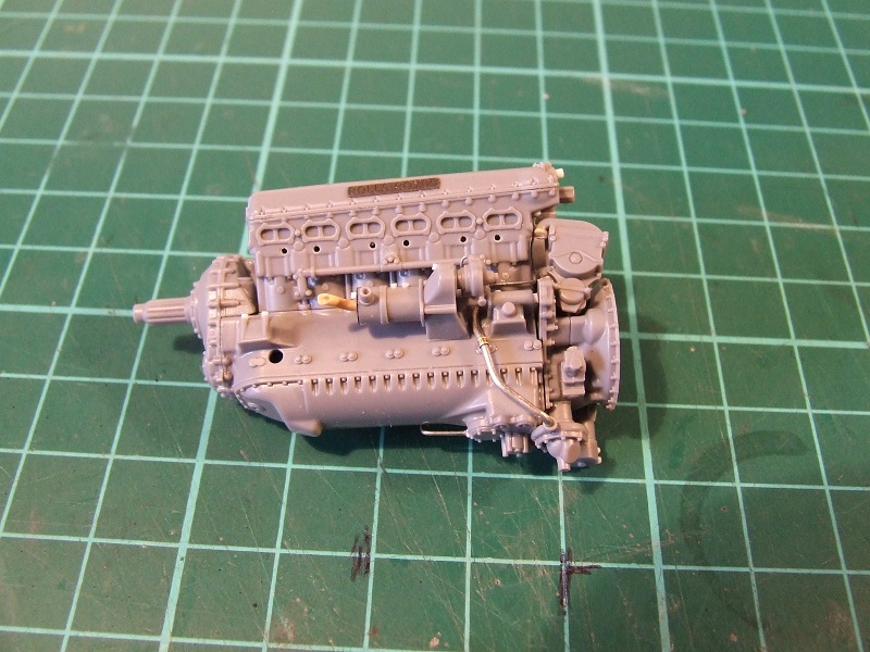

The main engine block and the temporarily attached wheel housing were then primed using light grey Tamiya Fine Surface Primer. The photos below show primed parts:
That is as much of the detail that I have done to the main block and wheel housing and apart from one or two minor details which need to be added later, the main assembly is ready for paint.

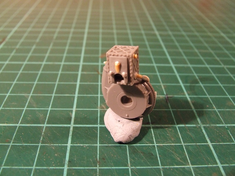

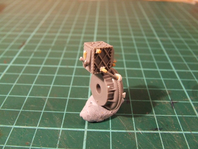

Next I started adding some detail to the supercharger/intercooler section. There are two brackets on the front of the intercooler where the main induction pipe exits which are moulded too high up by Tamiya, they should be lower down and there should be a small angled flange and filler cap above it. The brackets were cut off and refitted lower and the flange and cap made from stretched sprue. I also added an exit pipe for the intercooler header tank and intercooler feed pipe that goes to the liquid cooled supercharger and where it joins the supercharger, I had to fabricate an entry flange that Tamiya has omitted. There were also several other small fittings to make and add to what is in my opinion an overly simplified intercooler, given that it sits right above the engine where it is easy to see? Not one of Tamiya’s better efforts and I think they could have done better there!!
That completes this update. I still have many more pipes and fittings to make and add to the supercharger/intercooler and the carburettor/induction trunking before this engine is anything like as detailed as the real thing? Thankfully, I have some very clear and comprehensive reference material that makes things a lot easier than they could be by just using photographs!!
Thanks for looking, all comments and criticisms are welcomed.

Fantastic work Kev, enjoying seeing all the extra little details that you are adding, I also love your scratch built stand for the engine. This is going to be a piece to watch as you progress ThumpUp
