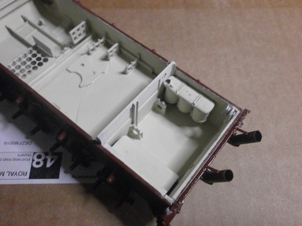

BigGrin Hi All

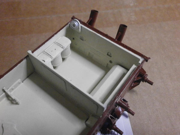

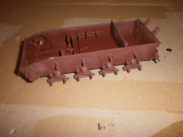

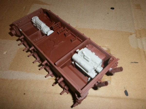

Just a quick update on progress, All the base interior detail is now added and a light coat of undercoat applied. As you can see it all fits like a dreamBlink Flapper Flapper BigGrin and still loads to go inLOL Drool. You may notice some unfilled area's in the engine bay but the water tanks will cover this area so not a problem, also i have deliberately left the marks on the side armour as it matches the used and abused insides of the Polish Stug walkround. More soon.

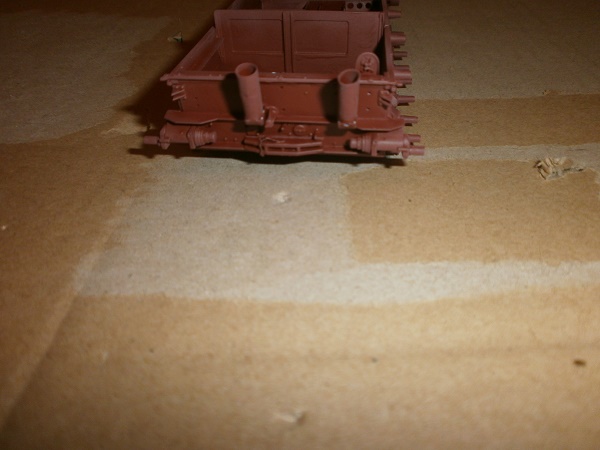

BigGrin Hi All

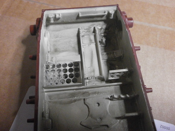

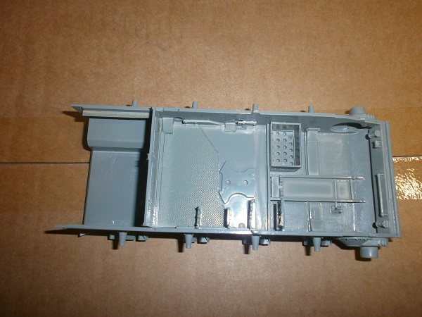

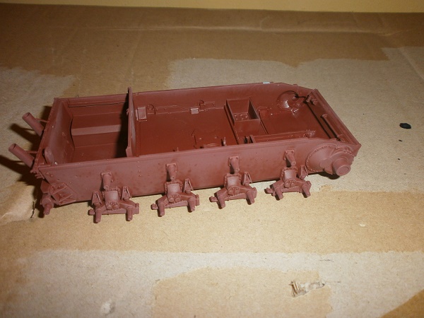

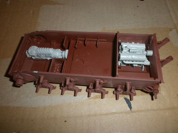

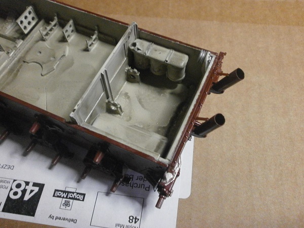

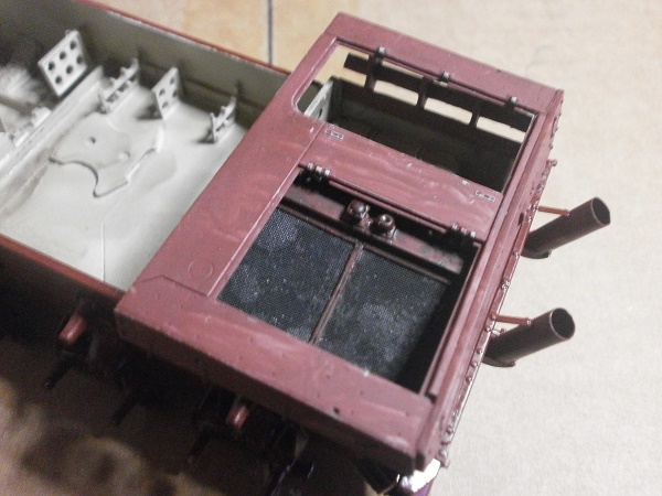

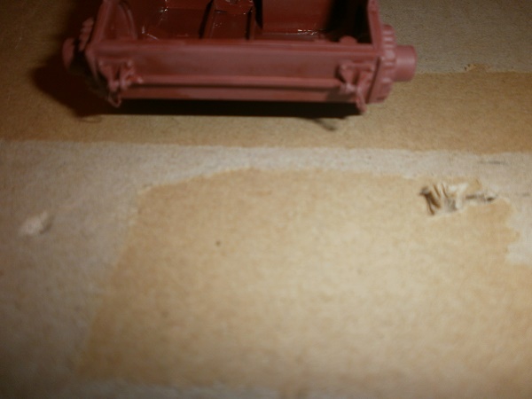

Some more progress, all the basic fittings have been added to the hull and some etch has been added to the outer front and rear finally all was undercoated then a base coat of German red lead added. Once all is dry Il be adding a liberal amount of Vallejo chipping medium before starting on the first base coats inside. As you can see from the last couple of pics the engine and gearbox slip in quite neatly.

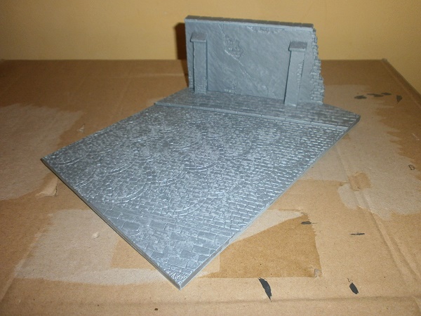

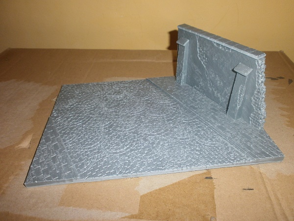

I thought it was about time to start making up the Dio base i have chosen for this build, its from Modelart and consists of quite thick vac-formed plastic sections you need to prepare and stick together then paint. I think these Dio kits are a brilliant way to introduce people into the black art of Dio building/making and after doing one of these it should give the confidence to make another from scratch. The Modelart website give some very good tutorials on the construction and painting of these kits also and there all available for download. More soon.

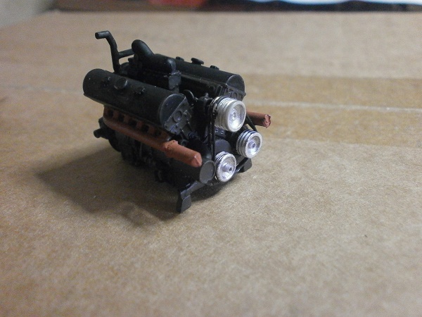

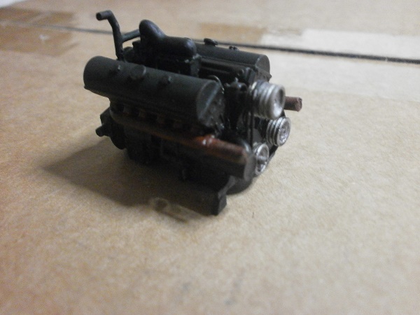

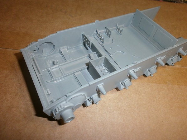

BigGrin Hi All

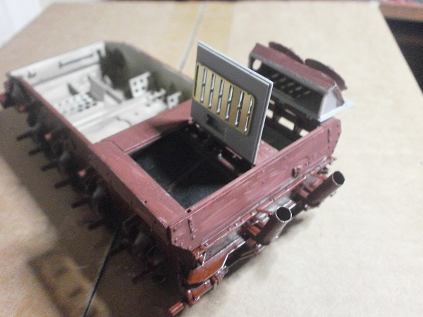

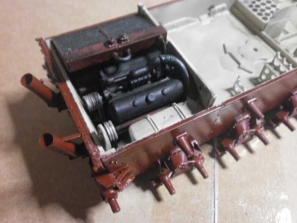

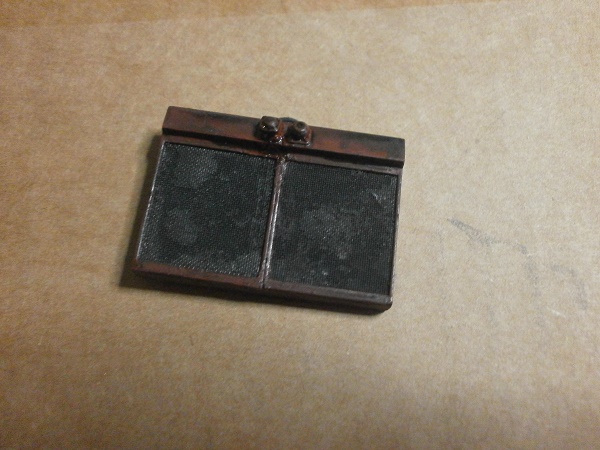

Some more progress, The inner hull after the application of Oxid rot and Vallejo chipping medium has now had a few coats of Elfenbien after this was dry a mixture of Tamiya Smoke and burnt umber has been applied to dirty things up. The Engine was next to be painted up along with the radiators, cooling fans and hoses, fuse wire has been used to replicate the fan belts again all the parts were dirted up with smoke and umber.
Next was the job of placing it all in position in the lower hull and everything went in with a small amount of adjustment but nothing serious. The upper hull is still being made up but I included it to show that everything fits inside without fowling the engine and radiators. The engine bay inspection hatches you may notice still need some fit adjustment but nothing serious. More soon.
