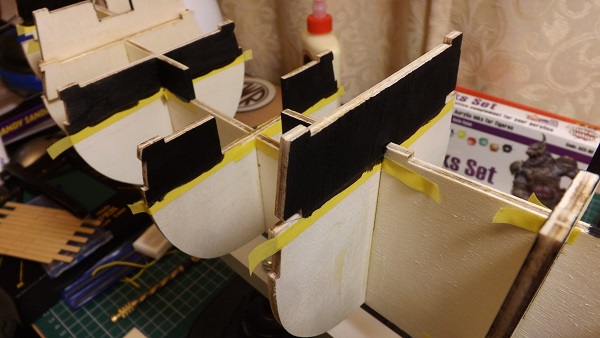

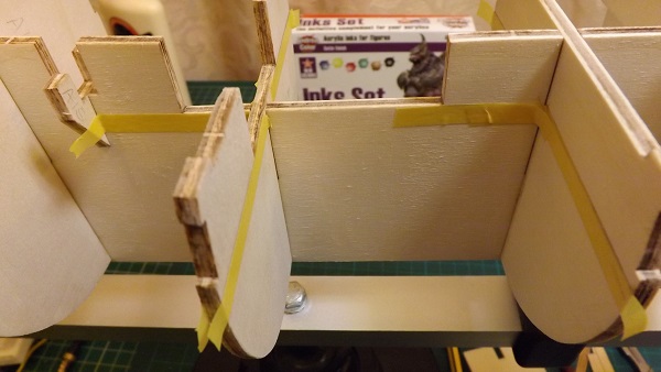

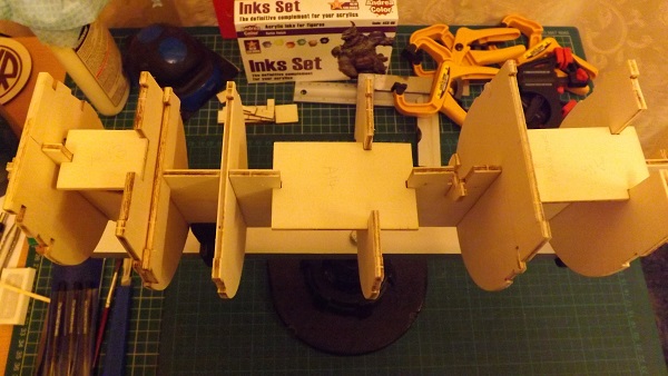

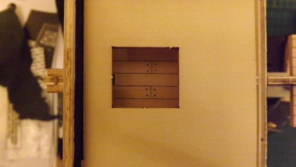

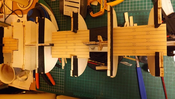

1. The first picture shows these false decks being test fitted into place.
2. Having test fitted them into place I decided that I would paint black some of the wood that may still be viewable just in case it should be visible through the grating to be added at a later date.
3. I used Tamiya masking tape to line out the areas I wanted to paint black.
4. This is what it now looks like with the black paint added.

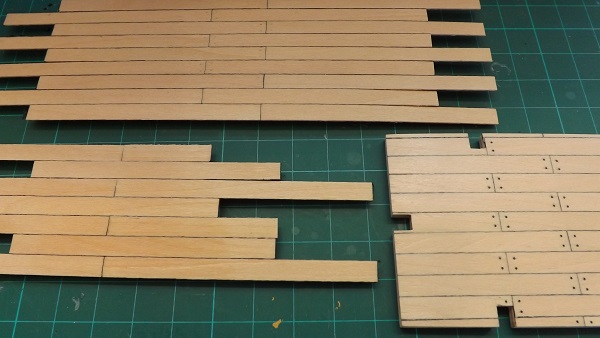

#23 Posted : 25 January 2015 14:54:55
Sunday 25th January 2015

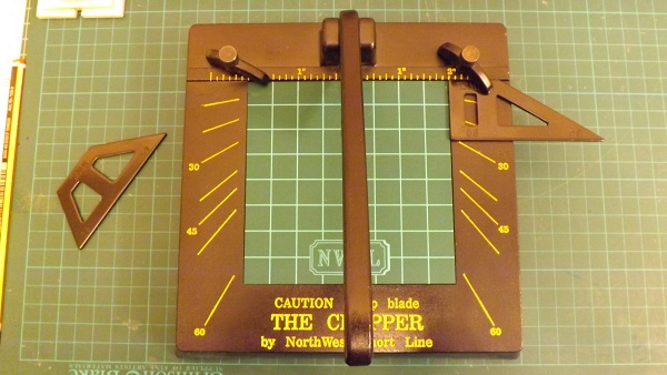

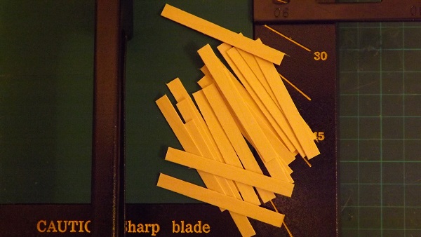

Having looked again at these false decks I thought it might be fun to have a play around with a planking effect even tough in theory very little of this will be seen through the final grating of the upper decks. The instructions would just have these pices glued in place with no details of planking them.
The intention was to have a little play to try and produce a suitable caulking effect between the planks and to produce an effect of the treenails.
The wood for the decking supplied in my kit is unfortunately a little rough edged and having looked at it too much work to sand so I ordered replacement Maple strips from an online supplier. I keep the size the same as that supplied in the kit which is 5mm x 0.5mm

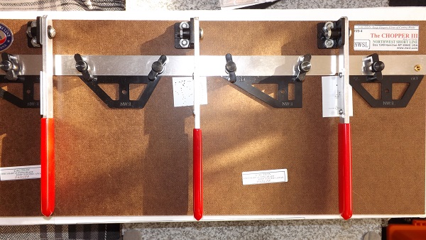

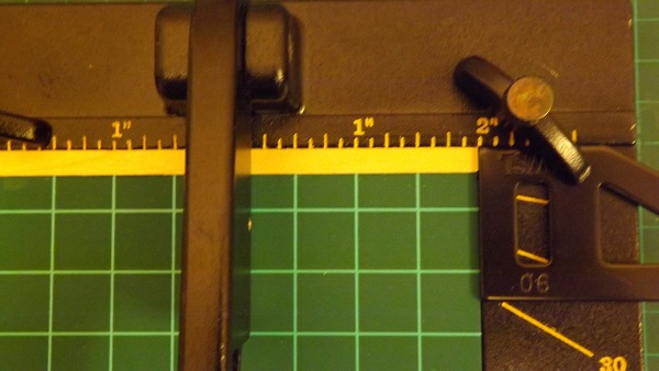

1. In order to cut the 1000mm lengths of maple down to a a suitable plank length I set up my "Chopper" with an stop to ensure all the planks could be cut to the same length.
2. Having cut our planks we end up with a nice little pile of wood strips to work with.

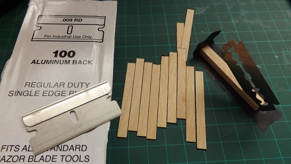

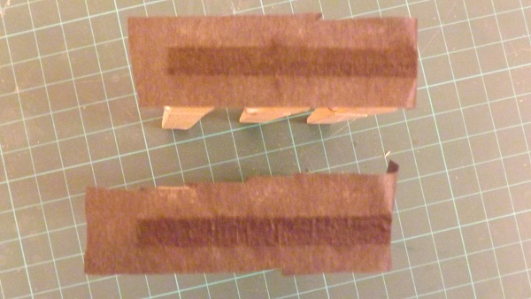

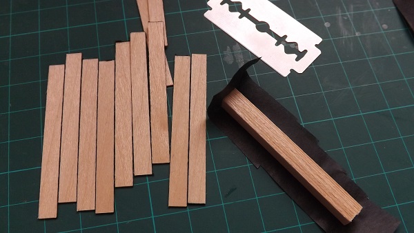

Having produced a pile of wood strips I will now describe my chosen method of producing he caulking and treenail effects. There are many methods of producing the caulking effect from eding the plank with a soft pencil, using black cotton and a whole host of other valid and interesting methods.
This is the method I find works best for me.
1. I use a cheap thin PVA glue, some black tissue paper (important to get a colour fast version to stop problems with the glue or later varnish coats)and a couple of peg clamps.
2. The first stage is to line up a set of wood strips so the one long and one short edge are all even. These are then clamped up.
3. I apply a generous coat of glue to one long and one short edge onto which a piece of the black tissue paper is affixed.

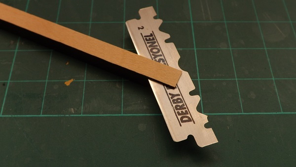

4. When this little glued bundle is dry its time to separate out each plank.
5. I find that the finest blade to use for this is a good old razor blade. I have used double edged in the past but as I am rather attached to my fingers have recently sourced a batch of barbers single edge blades. I have found that the traditional safety blade is just a little to thick and rigid for my liking.
6. All I then do is to carefully (those blades are very sharp) cut through the tissue paper to produce a stack of planks that have a black edge along one long and one short side.

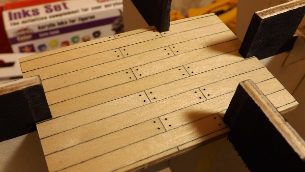

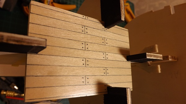

3. When the planks are dry its a case of trimming around the false decks to remove excess deck strips.

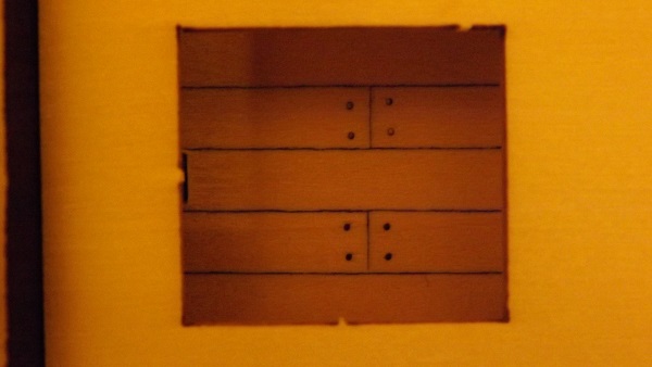

#26 Posted : 25 January 2015 15:48:57

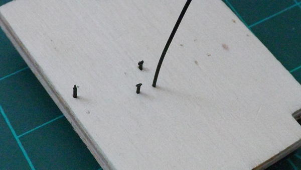

Having finished the planking its time for the treenails.
1. For this task I have decided to use a 0.5mm plastic fishing line cut
into small lengths and then glued into 0.5mm holes I have drilled
using those previously created guide marks made with the jig to try
and produce an even, neat finish (easier said than done).
2. When the "plastic pegs" have dried they are cut off flush using, this
time, a single edge safety razor blade. A quick rub over with a fine
sandpaper is then followed by a couple of satin varnish coats.
3. These false decks are then glued firmly onto the false keel. The
final picture on this posy shows the effect when the upper deck is
put in place although as mentioned the hole will be filled with a
grating so chances are not very much of this work will be finished on
the final model.

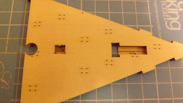

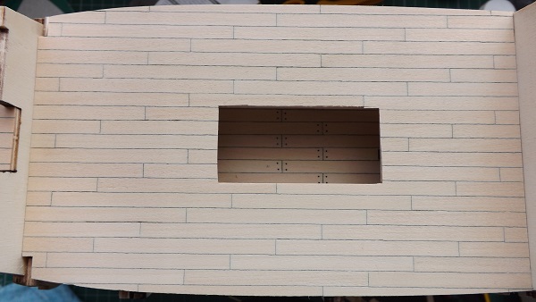

#27 Posted : 25 January 2015 16:17:19

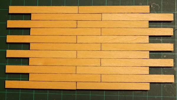

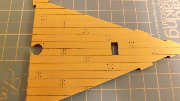

My final and still to be completed update for this week centres on the preparation of the 4 parts that will make up the upper deck levels.
Again had issues with the wood being very warped in my kit so having damped the parts they have been clamped up between 2 very heavy granite chopping boards, of all things, for the last 2 weeks and this has resolved the problem.
1. For these upper decks I am going to attempt a slightly more accurate
planking pattern and have opted for a "3 Butt Shift pattern". There
is no indication or full direction for the planking in the Occre
instructions other than one of the instruction pictures showing the
deck having a measurement of 65mm marked. It really does not explain
what this refers to.
2. As I am going to be cutting a slightly longer plank then a longer
cutter is the order of the day so I have switched to my "Chopper III"
for this purpose.
2. Having done some simple calculations I decided that a better fit
would be a planking length of 64mm. For my chosen planking pattern I
first divided the deck evenly in to with a pencil line. From this
line I then measured out further lines spaced at 15mm apart.
I have pinned a scrap plank down the centre of the deck and will work
my way out using the same style of pre-caulked planks that I have
already described.
3. The final picture in this posting is as far as I have progressed so
far. This decking piece now needs to be treenailed and the hatch
opening needs to be squared up. While it appears I have cut back the
corners of the planking at the left hand edge exposing the bulkheads
below this is not an issue as this will not be seen on the final
model as a further "wall" is positioned on the deck area.
4. The next decision I have to make is do I leave the decks in natural
light finish or do I stain them a light oak. That decision will be
made over the next week as I progress with the planking of the
remaining 3 deck pieces.

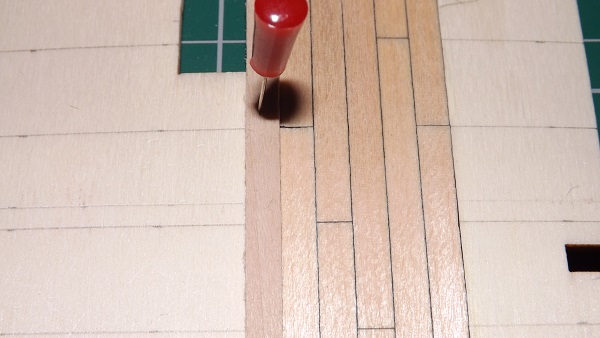

#39 Posted : 15 February 2015 18:36:03
Sunday 15th February 2015
Well after my last post I sat and looked at my attempts of planking the main deck and to be honest was far from happy with my efforts.
So out with the scrapper and off with the planking. Even with a scrapper this took a while and although I could of soaked the planks off after spending an age trying to get the warped deck flat I was not going to take chances.

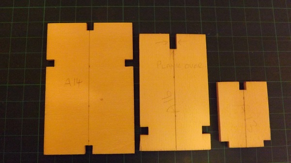

Some of the deck sections have a number of cut outs that once planked over are not opened up again. The pictures of the "beak" bow section demonstrate this and you can see from the following pictures exactly what needs to be opened up once planked over.

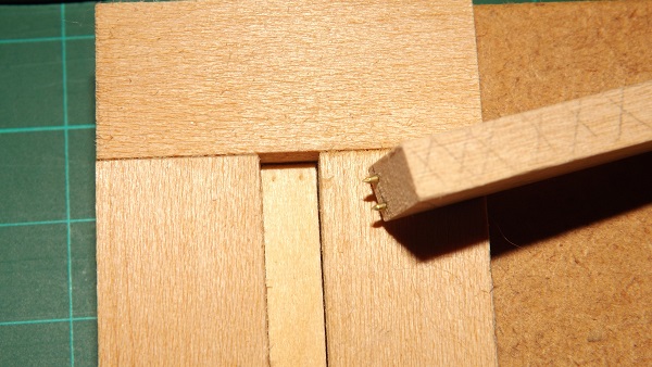

#40 Posted : 15 February 2015 19:06:39

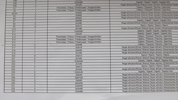

Having completed all of the deck planking, and feeling fairly happy with the results, I had a quick review of he instructions to see what the next stages have lined up.
Each of the deck openings are too be lined with 2 x 3 mm walnut strip. This stage if we follow the instructions is carried out once the decks are installed. I thought this would be more difficult so opted to install these strips prior to gluing on the decks to the false keel.
It should be noted that instructions are written by the manufacturer to give the best possible build experience but just sometimes you can make your own build that little bit easier.
Its at this point a minor error was found in the parts listing. Parts E16 and E17 make up thMore Smilies...e first of the hatch linings but as (hopefully) you can see from the picture E17 is correctly listed as African Walnut but Parts E16 are shown as PLYWOOD- a minor issue but one to be aware of.
