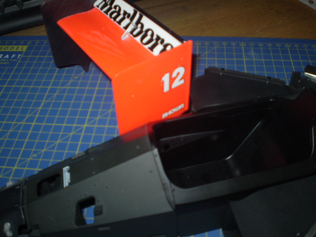

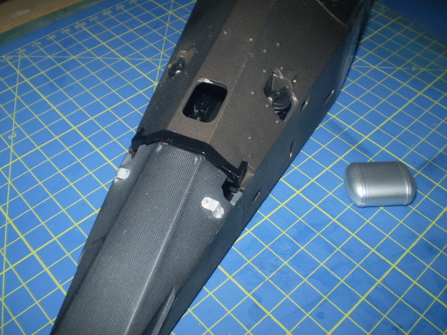

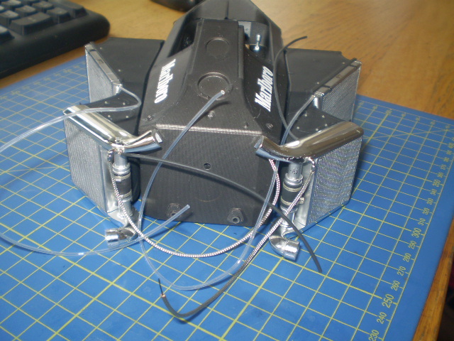

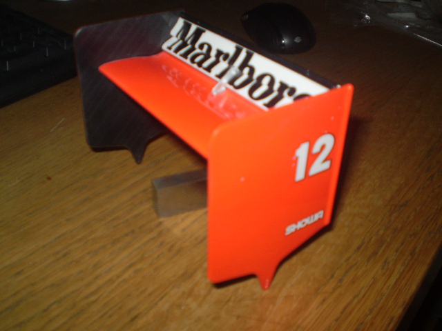

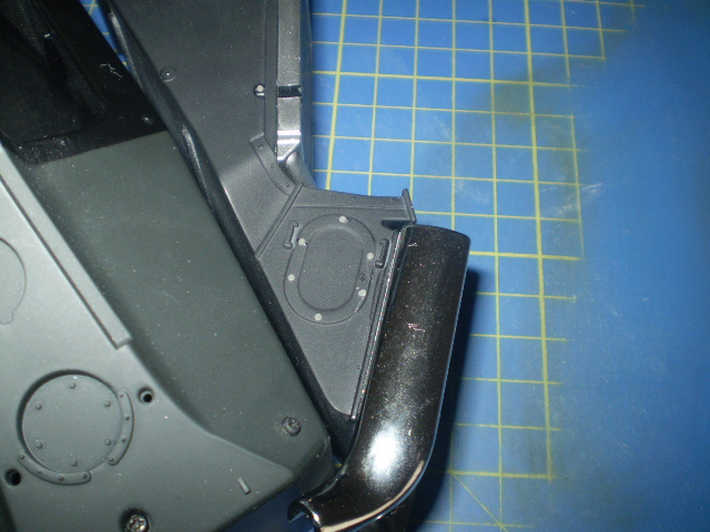

caught up with the right hand side pod with regard to the silicone pipes and jubilee clips, i also decided to cut of the inter cooler access panel cover "dimples" and changed them for some bolts. also finished off the rear wing but its in need of a clean up after polishing.
nearly forgot, managed to make the radiator clips as well
Dan

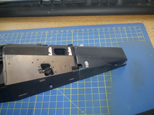

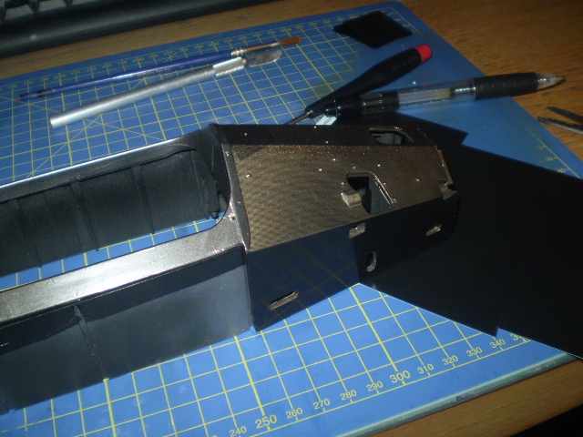

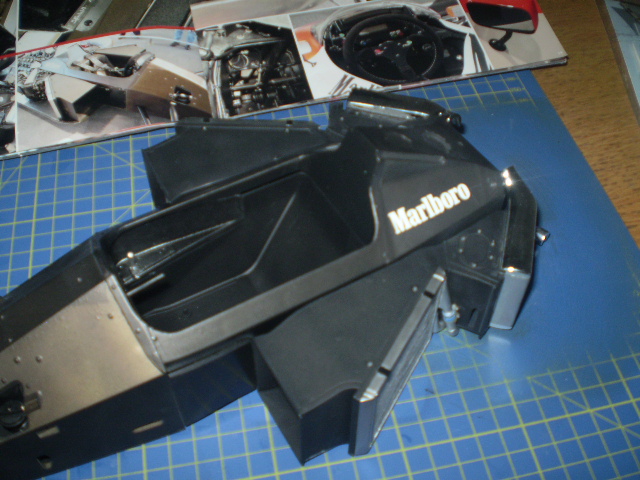

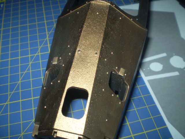

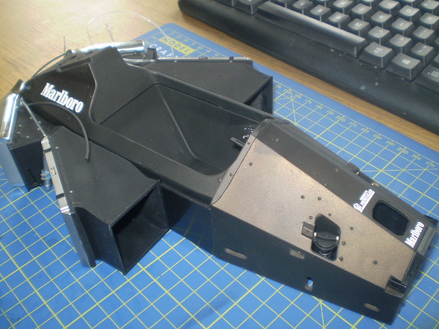

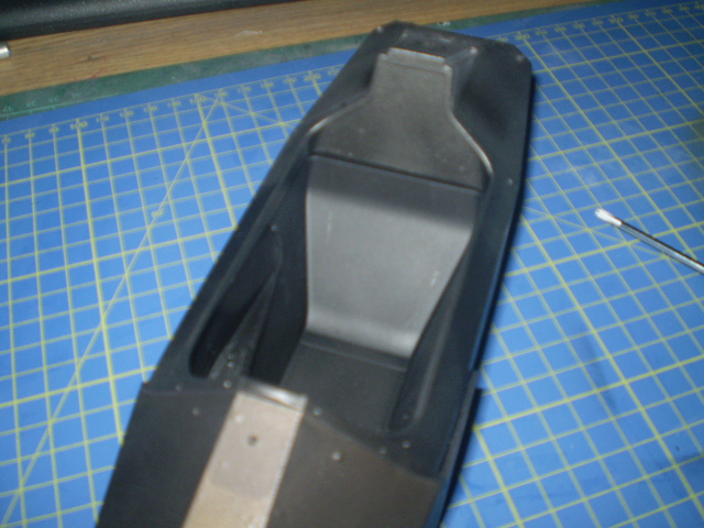

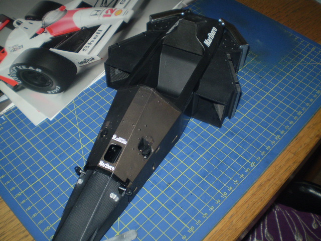

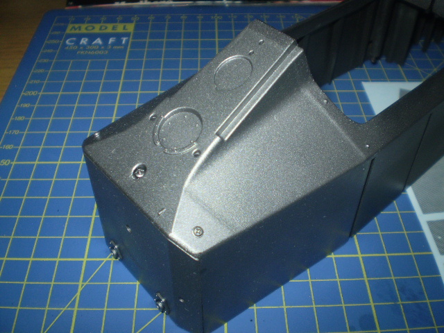

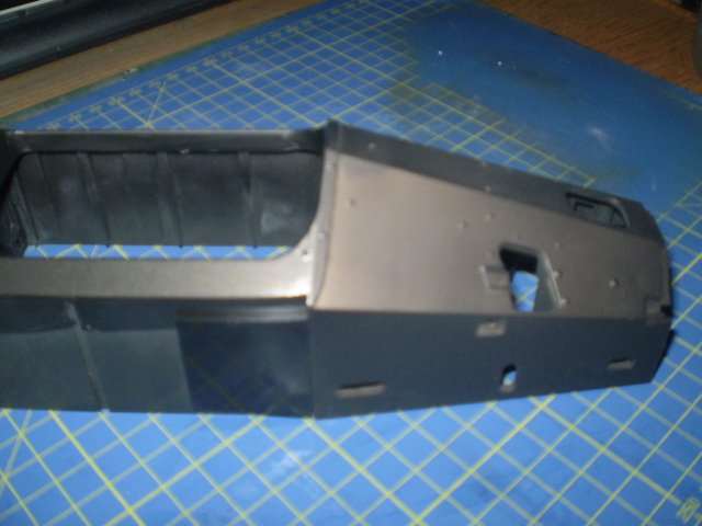

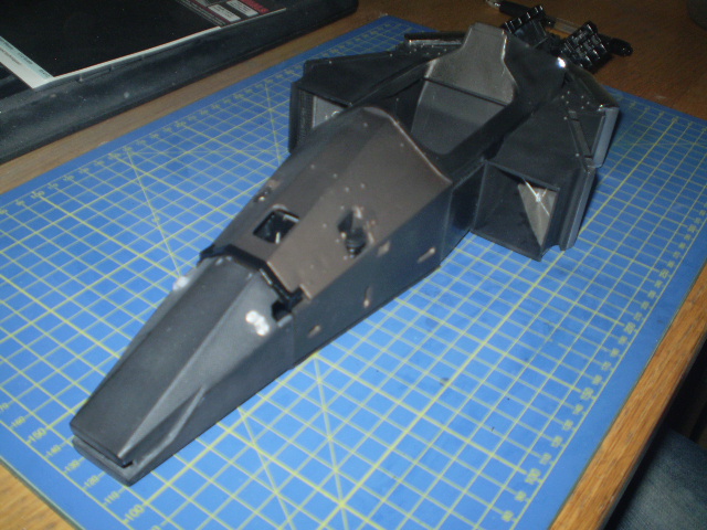

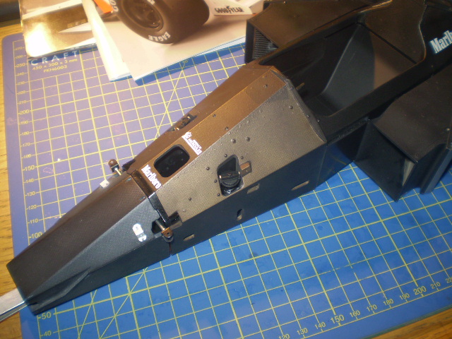

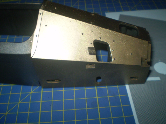

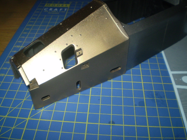

hi all, unfortunately this will be my last post on this build for a good few weeks as all the gear is to be packed away and shipped to a new address very soon. anyway ive been working on the mono in the last couple of weeks! to get the rough stipple effect on the front nose area i brushed on tamiya flat black and continued to work the brush until the paint dried, i then used alclad pale gold for the front base coat and alclad aluminium on the rear before applying the carbon decals.
after a few days i dusted over the decals with a coat of alclad gunmetal to tone it down.
dandare attached the following image(s):
dandare
#27 Posted : 03 February 2015 20:59:43
Joined: 27/06/2011
Posts: 437
Points: 1,321
Location: milton keynes

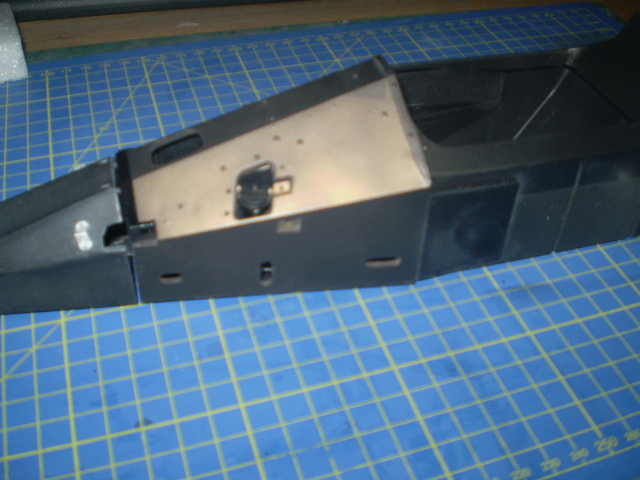

sorry for all the blurry photo's (they looked good on the camera screen)

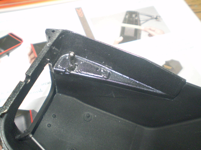

i gave the seat base/cockpit internal a coat of halfords matt black & although the picture came out bad i did actually apply carbon decals to the gear knob area!

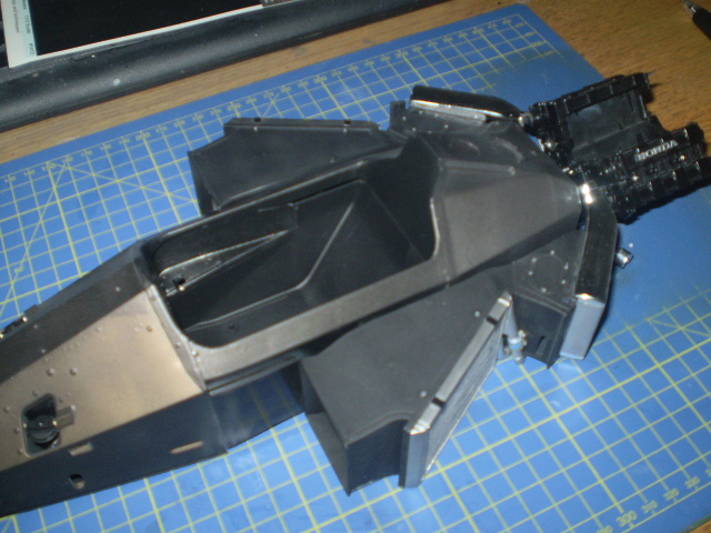

some more photos

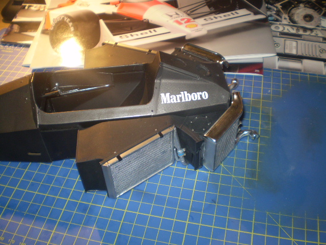

I then applied the sponsor decals & left alone for a couple of days to fully dry out. a coat of Alclad Flat Clear to the outside of the monocoque came next.
the internal carbon around the gear knob will be given a coat of clear gloss.
As i have 2 sponsorship decals for the nose i don't have to wait until the main body arrives to fit into place (part of the decal sits on the main body)so added one to the nose and the other will be used for the part that sits on the body section BigGrin so now i can clear coat the nose and finish that off.

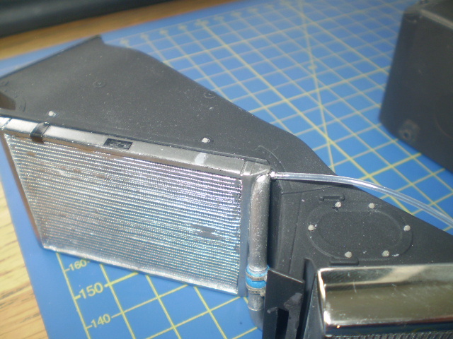

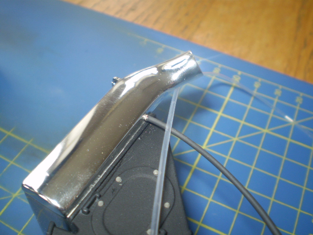

Hi All
nearly back to making some models!

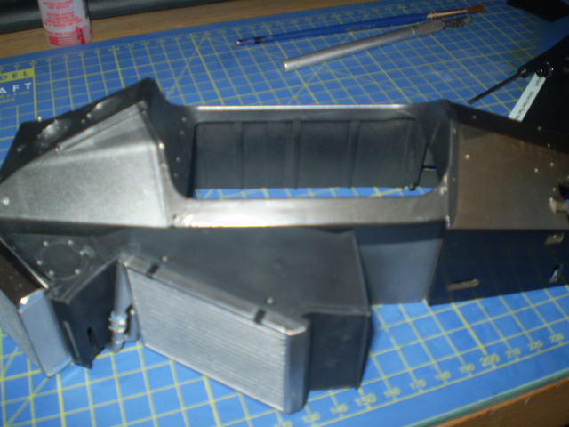

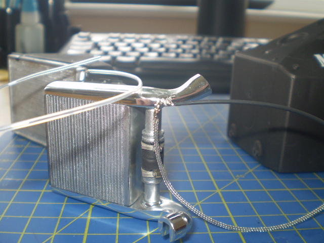

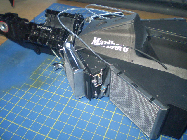

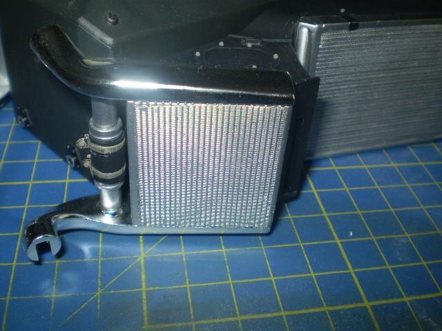

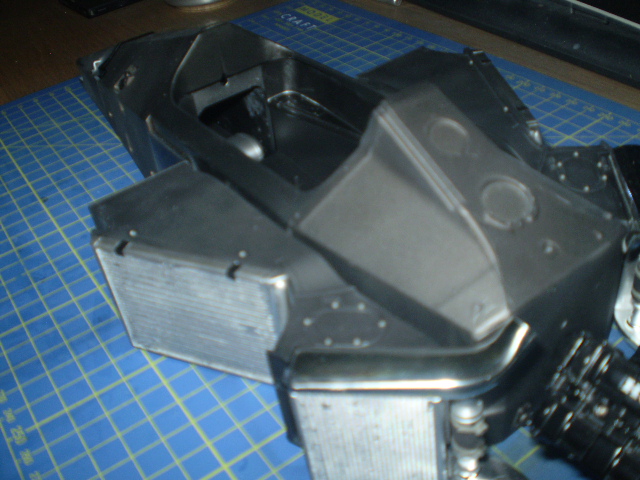

still some unpacking to do but found that whilst i was doing some of my said unpacking i was kinda doing bits and bobs (was unpacking and organising model materials etc)that said i somehow drilled the inter-coolers and radiators, inserted some connectors and fitted some pipework!!!
crazy thing this modelling, it somehow distracts you from what your supposed to be doing LOL
i just need to work out how to get the radiator expansion pipes to look as though they have pink coolant within them!!
Dan

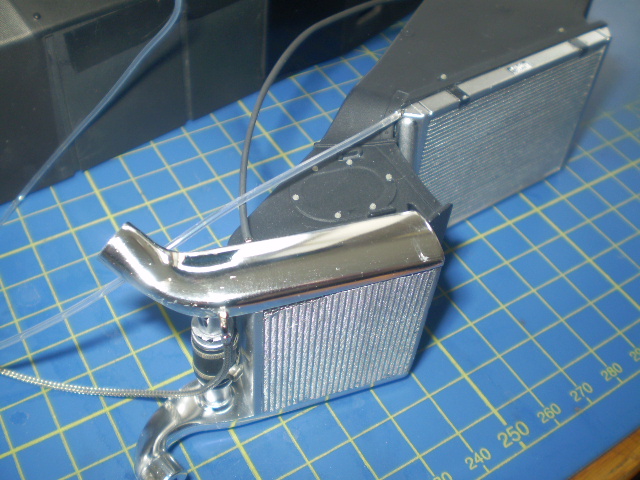

and a couple more photos of the mono, as the last where all blurry

Looking great and i know exactly what you mean about being side tracked at times as for looking for a colour for the pipes try this one ,link below
http://www.ebay.com/itm/...AINT-18ml-/310561609866
Im sure there are a few more out there but hopefully this may give you an example

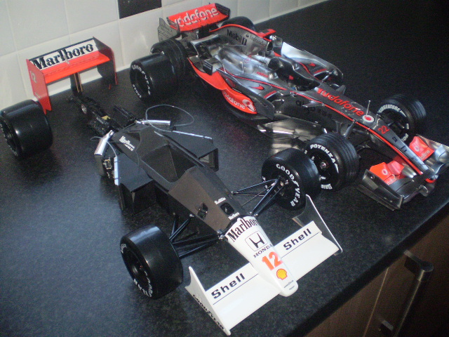

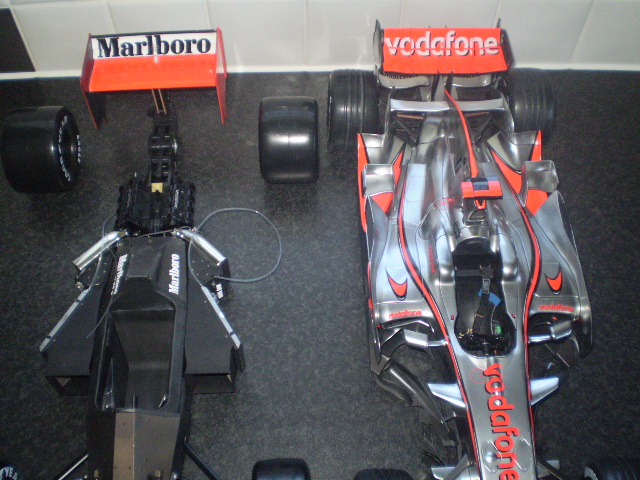

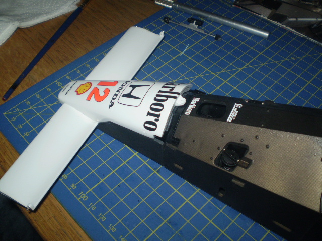

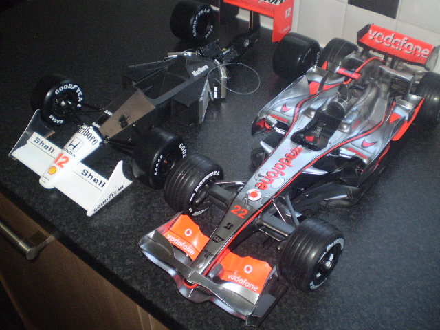

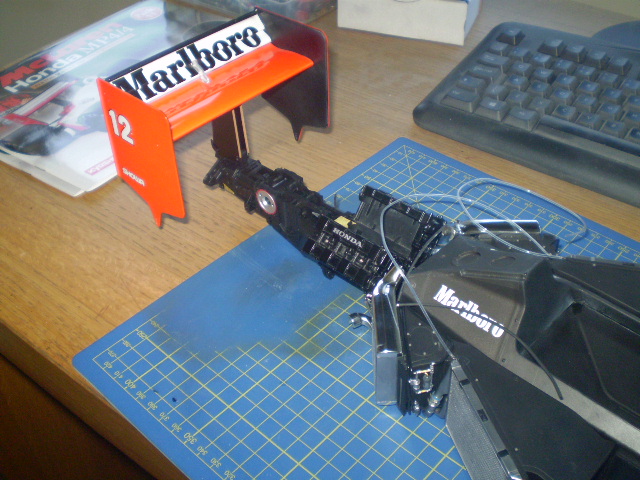

not much to show at the moment! been working on the carbon for the brake cooling ducts and turbo inlets, but these are not ready yet so you will have to wait till another update.
only managed to fit some pipework on the RH air inlet and also, not that the photos show them but added some rivets to the cockpit gear knob panel.

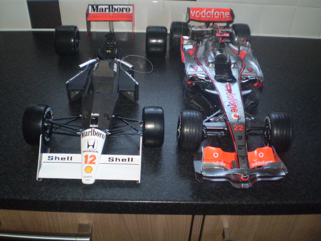

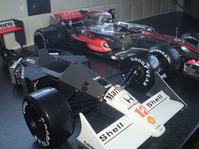

A couple of shots of progress so far and also alongside the MP4/23.
Dan

That's looking really good Dan. 1 question though, how come you have all 4 wheels and tyres?
Dodge charger build complete
dandare
#39 Posted : 06 April 2015 14:45:24
Joined: 27/06/2011
Posts: 437
Points: 1,321
Hi Steve, thanks for looking in.
After messing up the brake discs Crying i needed some new ones, therefore fleebay came to the rescue with the added bonus of some other parts within the pack, i can now test out the worn tyre look BigGrin
Dan
