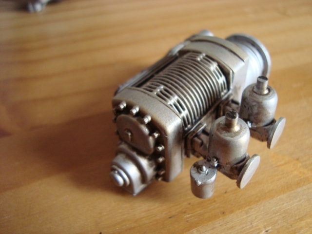

Superb work on the motor!! Always the way with oil washes, matt everything down a bit. Satin coat should make it look realistic though. I know from my dealings in restoring classic cars that the engine paint when first done has a nice shine, but once the engine has run and the heat has set it properly, you get a superb satin finish. Then once you add chrone and brass bits it really starts to come alive. Loving this build!!Love BigGrin
#23 Posted : 16 September 2014 23:47:32
Wonderful work Steve, you say you are trying to achieve an oily look with a well cared for look..... well, I really think you have achieved that..... looks fab....Drool Drool

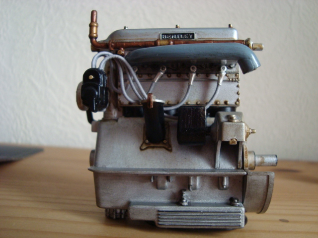

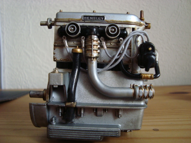

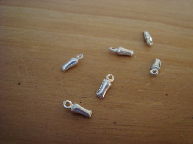

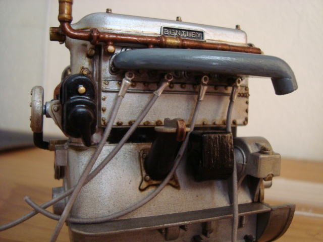

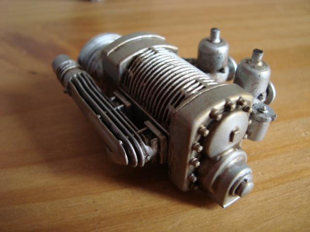

Not had much time today but managed to finish the blower with a sepia wash and some gold dry brushing to give the worn alloy look.
Also made some leads for the plugs, not in the kit but they should be at this scale. I went for the old style clamps and the leads are white elastic cord which I hoped would look like the asbestos wrapped flex used on these back then. I dont know what the fittings are - my wife makes jewelery and they were in her supplies - i just cut them in halfLaugh
Lastly I have given all the engine parts a satin lacquer - not noticeable in the pics really but it just makes it slightly more shiny as It went a bit dull after the wash.
kpnuts

Now that looks spot on!! The satin coat is perfect. The ignition leads are a superb bit of detailing, and scratch building with whatever you can find is half the fun. Superb build.BigGrin Drool BigGrin

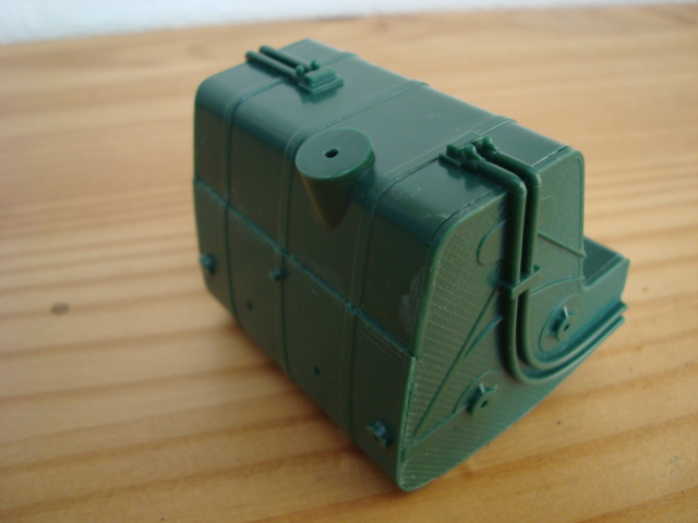

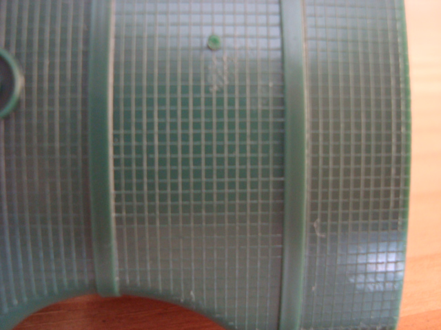

So next up is the fuel tank. There is a lot to be put right on this, the pics below show the tank built out of the box, I didnt waste time filling in the joints etc as it need a fair bit of work.
The problems I can see are firstly the 4 hoses, these look too much like they are part of the tank and not separate lines so they will have to go. Secondly is the stone chip guard - this is supposed to be a steel mesh covering the lower half of the rear and underneath and also the 2 sides. The mesh pattern is no where near deep enough to look realistic so this will also have to be dealt with.
So, basically I think I will be sanding off all detail on this tank and replacing the lot, hoses, mesh and straps.
This is an area where photo etch would have been very handy, even the re-release of this kit from 2012 has no extra detailing and I think it would be good if Airfix could follow the likes of Tamiya and include some etch when they re-release an old kit like this.

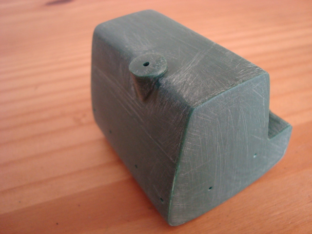

Well I got rid of all the fuel tank detail as per pics below.
I had a look round for some bits and pieces and managed to find some things for the fuel lines, brackets and straps but was at a loss to know what to use for the metal mesh....so I then saw a sieve in the kitchen drawerLaugh
Anyway, due to it being woven wire rather than mesh it all fell apart when I cut it to shape so no good (nor is the sieve any more). I have now ordered some aluminum mesh with 1.5mm holes and fixed joints so can be cut to any size. I have enough coming for all the jobs on this model as I think Im going to use it for the carb protection guard, windscreen guard, headlight covers and the fuel tank so worth buying it.

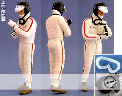

Just a quick question, Im going to put this on a simple display base so does anyone know of a suitable 1/12 scale figure for this era - sitting or standing , I don't mind a bit of re-modeling but would rather not. I do have a few in my stash but none suitable...Henry VIII, Anne Boleyn, James Bond, QE1, Valentino Rossi and a skeletonLaugh
#37 Posted : 19 September 2014 16:43:49
]here is a Tamiya figure of a 1960s driver.
#38 Posted : 19 September 2014 16:51:18
Thanks, I like that driver, not sure what they would look like from 1930 though, have to do some research - dosent even have to be a race driver. I guess he could bw worked on though so may be a good base
