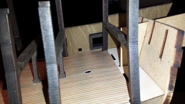

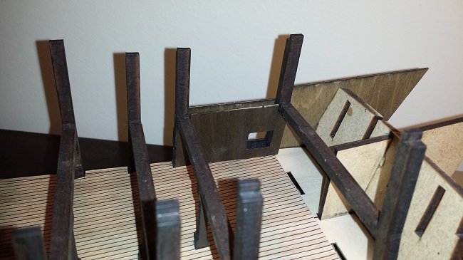

Hello again all,
I have finally recieved my next 4 issues and I am pleased to say that this time they have all arrived intact. I will make a start on getting the wood die on over the next few days and should be ready to start panneling up over the coming week or so.
As usual I shall keep you posted with pictures of the build. My only worry is that now I have to pin some of the panels, this may split the wood so this will be the most nervous of the build to date. I may just be worried about nothing but if anyone has had a bad experience with pinning panels on previous builds please PM me and let me know any little tricks you may have found along the way.
Pinks666 attached the following image(s):

Hi Pink, if you are concerned about the wood splitting when inserting the pins then I would consider pre-drilling the pin holes in the panels first. Cut the head from a pin, insert it into a pin vice and use this to pre-drill the holes. This method works just as well and is far cheaper than purchasing micro drills which tend to break easily.
Hope this helps.

No problem Marc, one other thing.. If the pins are to be removed after the panels are set in place then you may like to consider using thumb tacks or map pins to hold the panels in place while they set.... Thumb tacks or map pins are easier to remove than the pins supplied especially if the supplied pins have been driven all the way in.... I tend to use map pins but do find the head comes off sometimes.

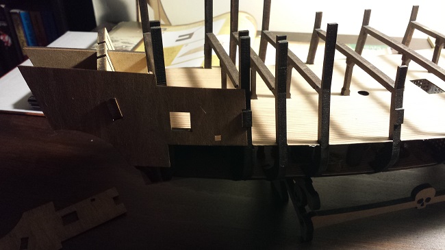

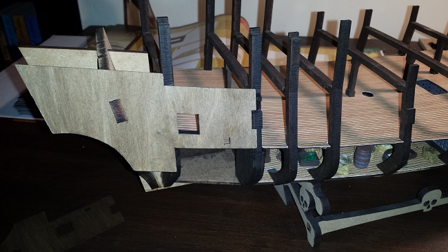

I have finally got around to progressing my build a little, I have fitted the first gun port to the first outer hull.
I have then fitted the outer hull to the frame work.
I have noticed that this is around the time I am noticing small errors of alignment. a tiny amount of filler will definitely rectify this problem but it is certainly something I will be aware of as I move forward.
