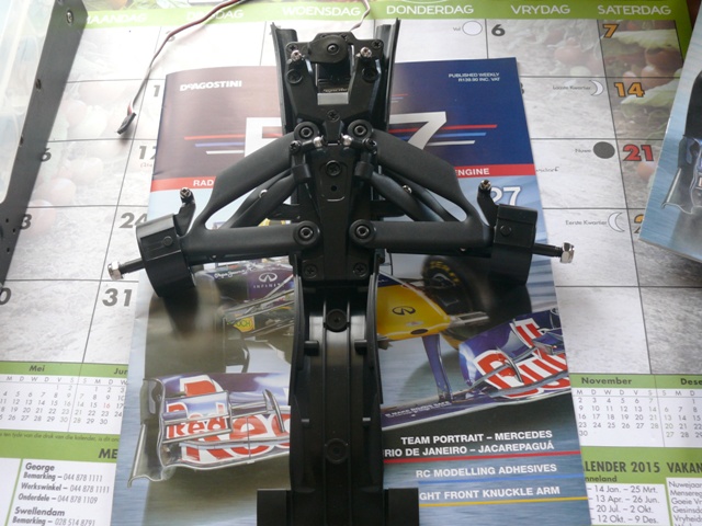

As promised, here are a few pictures of what I am getting up to. I am so far behind, it's not funny but I do have a few excusesBlushing Ham radio, rc planes, rc boats, full time workHuh and a wife that is Mad I am building in a sequence that suites me, so the shocks must still be done. Came across a problem this afternoonConfused I fitted the bearings into the front wheels where they are loose but that I will sort out. Fitted the wheels to the spindles and tightened the nut. The wheels have excessive in/out movement on the shaft. One of two options. Cut more thread on the shaft or space it up with washers. We are paying a lot so we should not have this sort of problemAngry

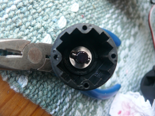

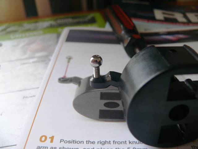

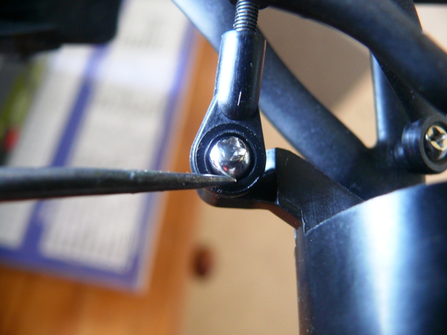

I forgot to mention that I use the tip of a Philips screwdriver to open up the hole where the screw goes in, as shown in the first picture. I put the point of the screwdriver in the mouth of the hole and just give a few left and right twists. The screw will enter much easier.

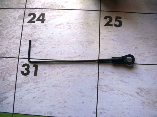

I have now finished issue 30. Use the alan key to turn in the threaded rod. I am just very upset with the fit of the linkages. There is a lot of play that must now be corrected. With the amount of money that we are paying I expected better fitting parts. I have a cheapy rc buggy with less slop on the steering. Now I must fix the very sloppy bearings, they fall around in the hub, and the steering linkage. Has anyone else had this problem?

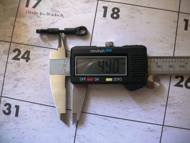

#26 Posted : 16 June 2015 15:42:19
Joined: 26/05/2014
Posts: 206
Points: 621
Location: Swellendam, RSA

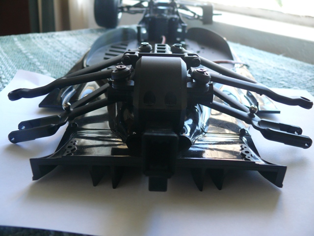

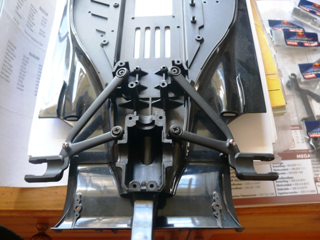

Sorry folksBlushing I have been doing all sorts of things except work on the car. Would you believe that I found my slot car that was last used in 1974, that rather dates me. Ok, here is a picture of the linkage where I have excessive playCursing

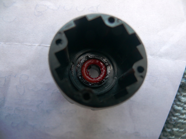

#27 Posted : 18 July 2015 15:57:41
Joined: 26/05/2014
Posts: 206
Points: 621

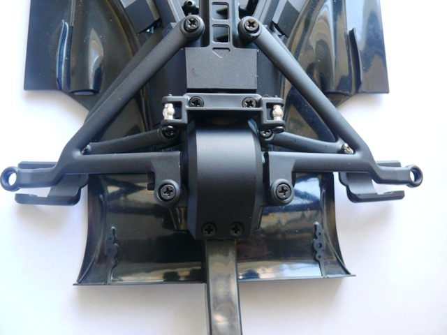

Right, I have not been here for a while so let's try and make up. I am up to issue 50 but I am jumping around with the build. Let's go to the diff. The lubricants that I use I take upon my own head and the comments are my own. I used some red rubber grease on the O rings and a high pressure liquid grease on the shafts. I cannot see why they do not recommend lubricating the shafts. I mean, it is fast turning part without lubrication! O rings and seals should always be lubricated with a bit of rubber grease. As I said, this is what I am doing. Here are some pictures.

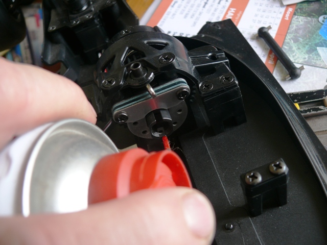

#28 Posted : 30 July 2015 18:28:38
Joined: 26/05/2014
Posts: 206
Points: 621

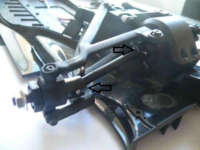

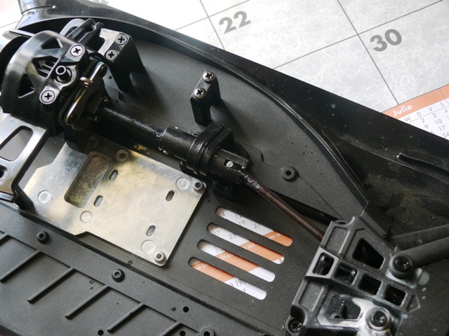

Ok, done the diff and I will wait for the right hand axle shaft before I continue. I sprayed some high pressure grease into the coupling where the left hand shaft sits in the hubs. See the pictures and the arrows. Just remember, all lubrication that I use I do at my own discretion. I take no responsibility if something goes wrong.
Just a quick rundown on my credentials. I am a Master Foreman and Technical Advisor for our local Toyota agency. I am using products on the RB7 that we use on our vehicles

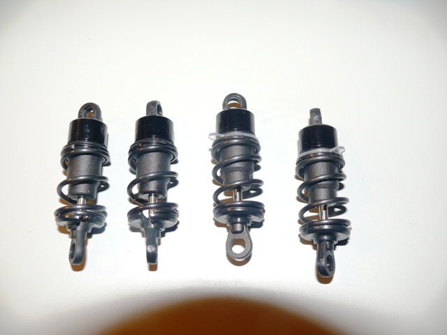

#30 Posted : 12 September 2015 16:21:48
Joined: 26/05/2014
Posts: 206
Points: 621

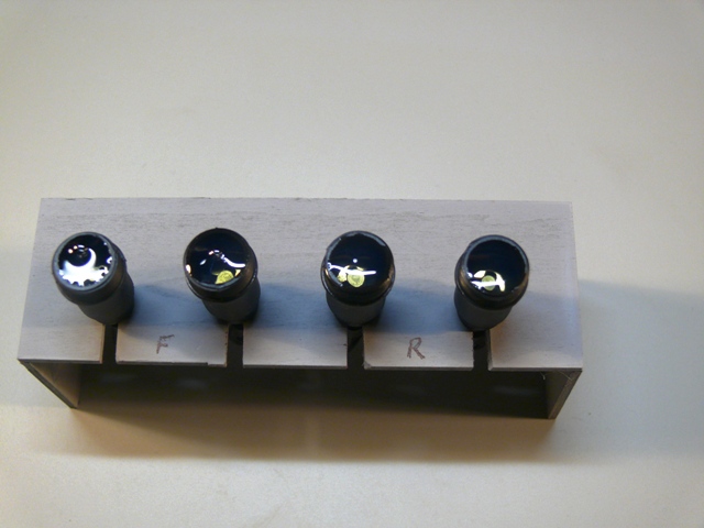

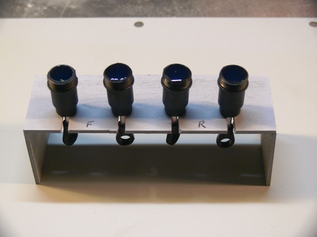

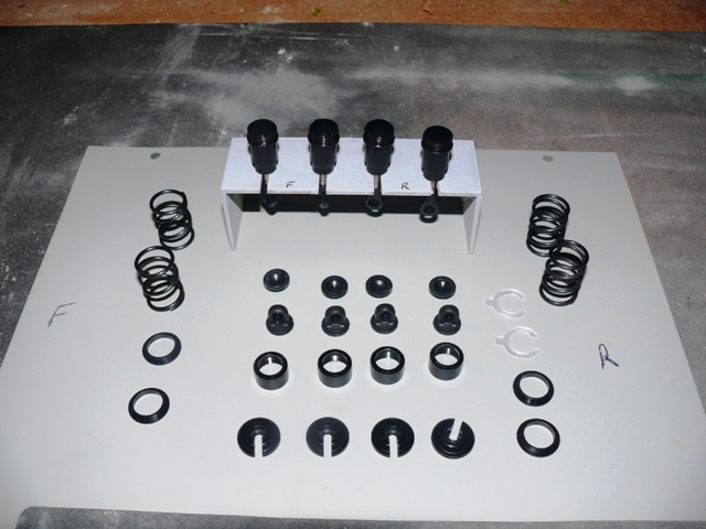

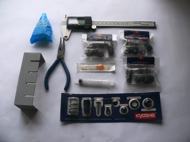

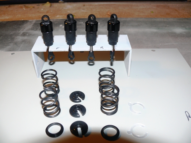

As I have said, I am building the RB7 in my own order. Right, all the shock parts have arrived and I have now assembled them. Please watch out that you do not mix the shocks up. The front shocks have the extra spacer and the springs also differ. In the last photo you will see the difference. 3 Coils on the front springs and 4 coils on the rear springs. Follow the instructions to get rid of the air bubbles, the front shocks with the spacers have lots of air trapped there.
AndreZS1AZ attached the following image(s):

coming along nicely your build isCool . Only thing I will say about putting the grease where them arrows are is that it will attract dirt and dust which will eventually probably wear quicker then a dry joint plus it will build up and also spray around the area.

Hi Steve, the grease that I am using is a high pressure spray on grease that does not splatter or get flung off with centrifugal force. When there is a dirt build up, I will clean it out with brake cleaner and re-grease. As I said, all the lubrication I take upon myself, so if there is a boo boo, it will be my problem, but I do not think that there will be problems as I have used these products before.

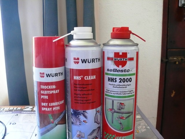

Hi all of you out there. Here is a picture of the products that I am using. I will be posting some more of the car when I get a chance. Must go and bath the Rottweiler now.

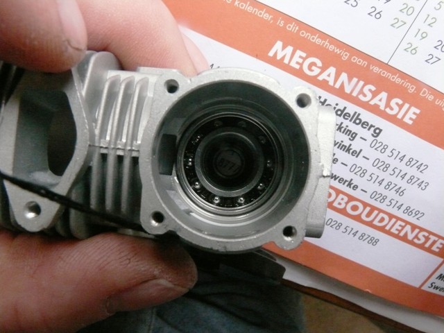

#34 Posted : 14 December 2015 17:46:47
Joined: 26/05/2014
Posts: 206
Points: 621

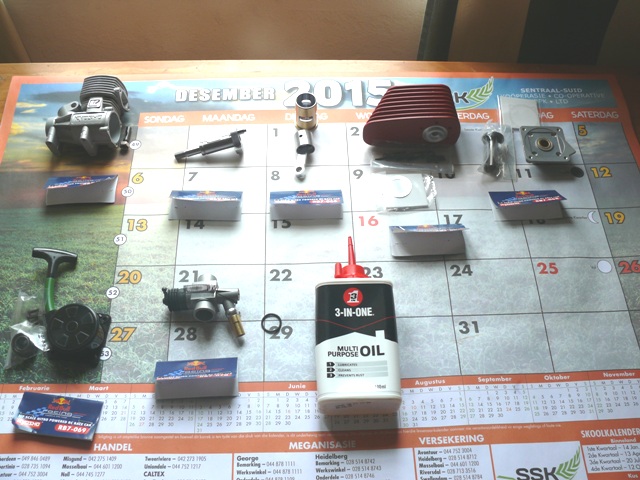

I received issues 67-70 today and I will assemble the engine over the weekend. There is a better way to assemble the head and shims. I will show that when I assemble the top. I first sprayed some HHS 2000 into the cup joint and then inserted the greased shafts. I will not be putting the wing on as I will only be running the car and will wait for the running wing. I am enjoying the build and working out how to get around some problems.

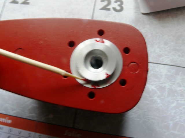

#35 Posted : 16 December 2015 14:17:56
Joined: 26/05/2014
Posts: 206
Points: 621

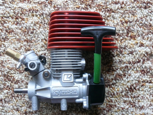

It's a public holiday today here in SA, so I thought let's go for it and assemble the motor. First of all, I had to use a heat gun to warm up the cylinder to remove the piston. Being 220km from the nearest hobby shop, I am using liberal doses of 3 in 1 oil which I have been using for years. The first picture is of all the parts in order. The 2nd picture is of the inner bearing that you must not forget to lube. The 3rd picture is where you put a slight amount of grease on the cylinder head and fit the gasket. Put some grease on that gasket and fit the 2nd gasket. This will stop them from falling off when you fit the head. This is a better method than what the magazines say. Last picture is of the completed motor and the pull start works quite well with some tightness at TDC because of the taper. Just remember to store the engine with the piston at BDC. You will be able to see this through the exhaust port.

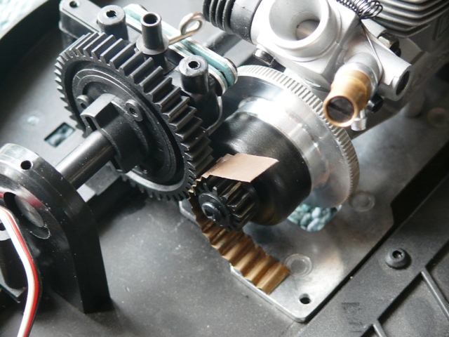

#39 Posted : 07 April 2016 11:58:51
Joined: 26/05/2014
Posts: 206
Points: 621
Fitted the motor and done the gear meshing. I have some very thin shim stock and I used that. Just very disappointed with the amount of slop on the rear suspension and wheels. Did not expect that from Kyosho. I will post photos next week if I get a chance. I am on leave and seem to have more work at home than at workBigGrin
