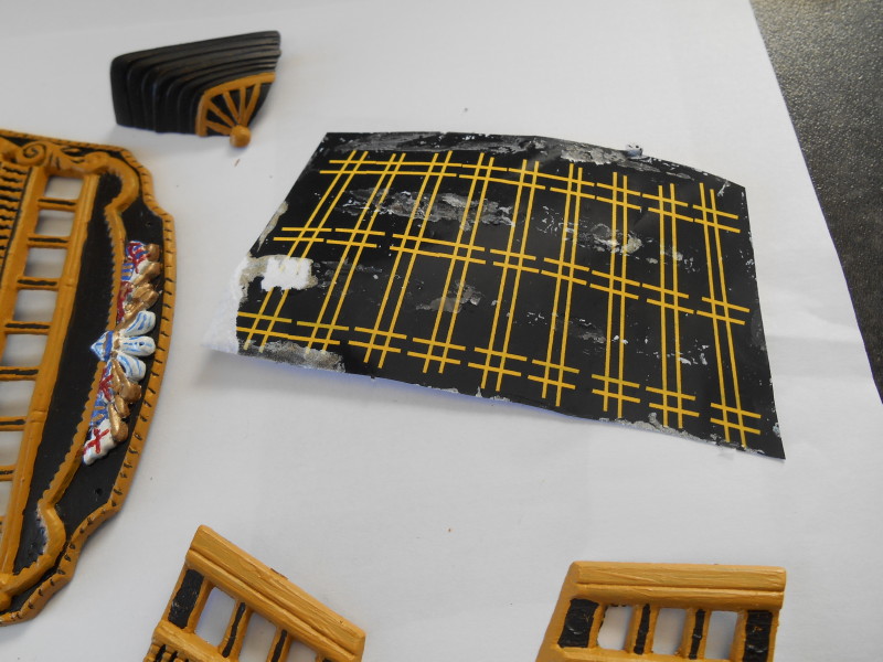

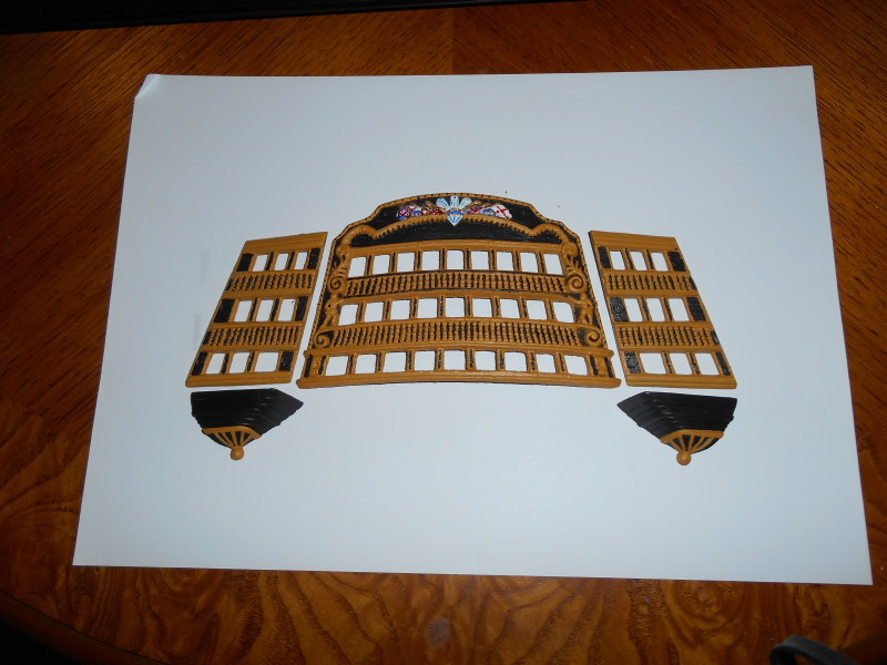

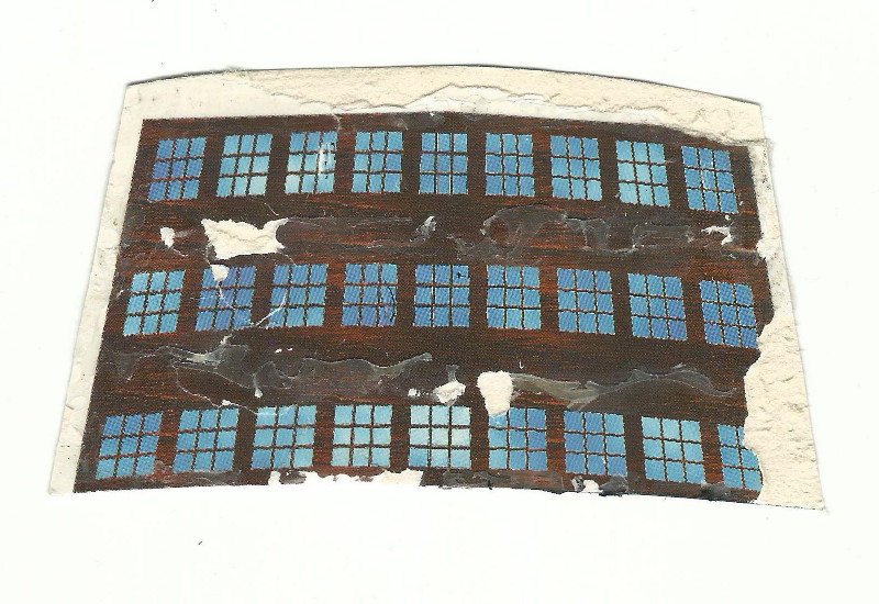

This is the original cardboard cut out windows that came with, a little bit mashed up because i had already stuck them on and then decided to change things and then pulled them off.

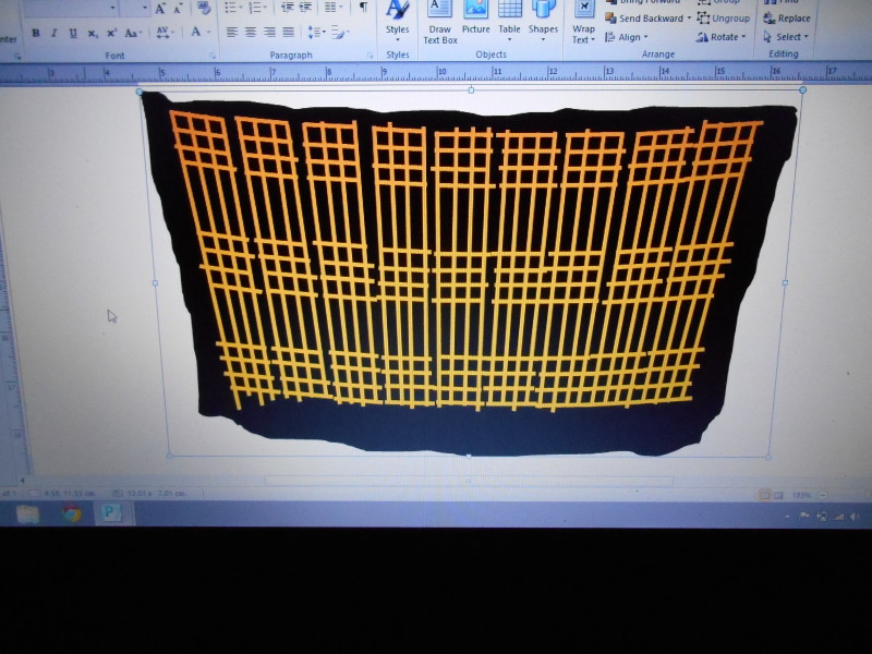

So what i did was scan the original cardboard windows and in Microsoft Publisher overlay them with yellow lines, then delete the carboard template and back it with solid black, i tried different backing colours but the window frames just didn't stand out as well.

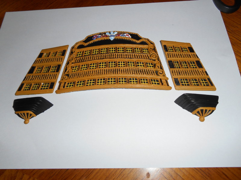

I painted the original metal stern galleries with the same acrylic paint as the ship.
Gibbo attached the following image(s):

Painted the stern decoration

And then glued the new windows in place, the window frames are darker than the picture tells, i printed on photo gloss paper to give a glass effect but the flash from my camera makes them look a lot lighter, i am going to blue tac them onto the ship tomorrow to see how they look, i will be using the back plate but not sure yet if i'm going to use the quarter galleries or order some better replacements from Cornwall boats, it would probably mean ripping off what's already well and truly glued in (but tomorrow's another day).

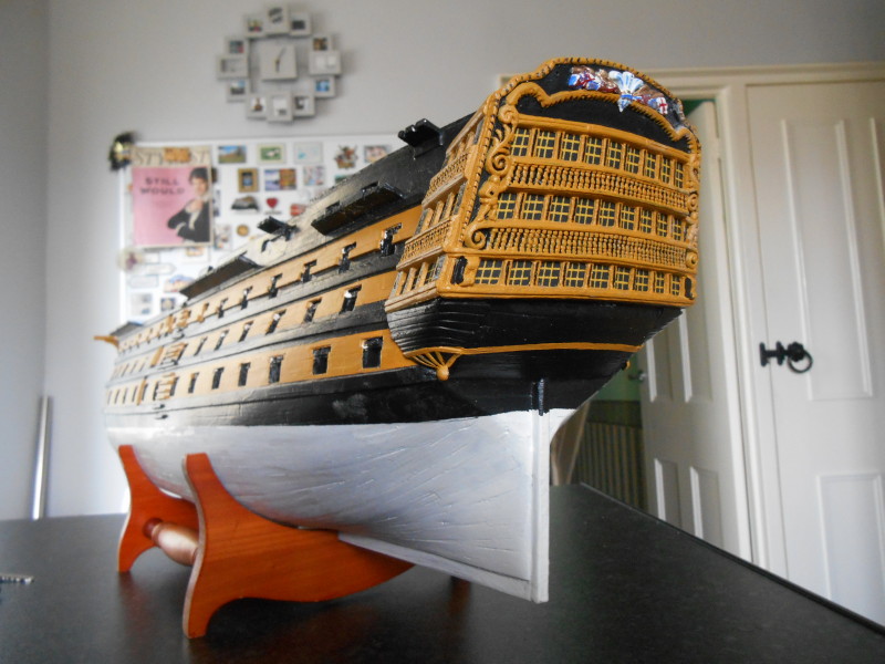

Location: East Sussex UK

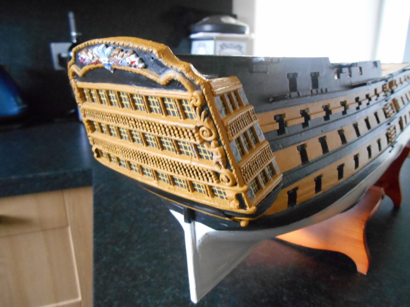

The new 330g artists card worked out really well, Stuck like s**t to blanket, had to do some making good as the arch of the wooden sternplate did not match the arch of the die cast metal sternplate, (a bit of filler required), i decided not to go with better replacement quarter gallery replacements from Cornwall Model Boats as i would have had to rip the whole back end off, if i'd taken off the original quarter gallery sections the wooden back plate would have gone "ping", so i went with what i had, next up is the coppering of the hull below the waterline courtesy of Plymouth57's build.

Now that is nice!!Cool Cool Cool The fit of the quarter galleries is better than the ones I had, well, actually the ONE I had as I discovered both were for the same side!! (And far too late to do anything about it!)Cursing
Far better looking than the official build photos (even the painted version had no painting instructions for the metal plates!)

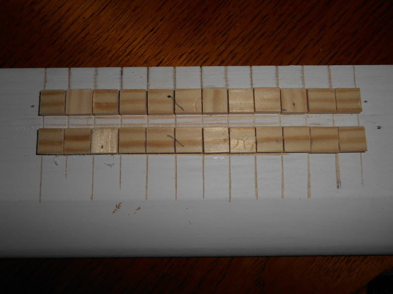

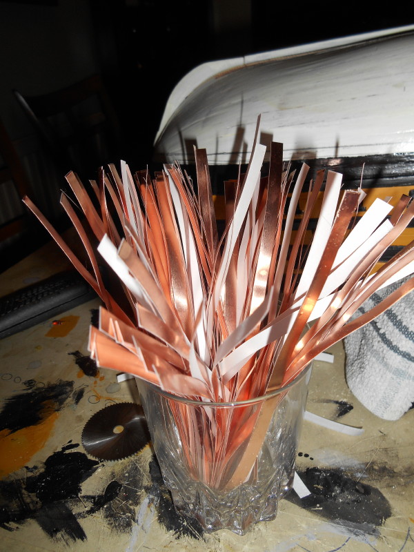

Now that my outstanding work has been caught up on and out of the way and my copper tape ( 6mm X 33m from ebay ) £7.00 with delivery, and mini circular saws ( £ 6.00 from ebay ) have arrived i can get cracking on the hull, this comes courtesy of Plymouth57,s build of this particular model ( thanks again Robin )i devised a gadget to make this process a little easier and quicker, i had a bit of skirting board knocking around and a strip of pine, i cut the pine into two strips of 6" in length and stuck them to the skirting board with a gap of 6.5mm inbetween them, then i cut 1/2" slots along the pine to make 12 sections.

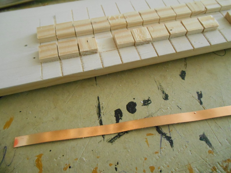

Why are my images not attaching themselves to my post? lets try again, next i cut the copper tape into 6" strips

This is the plain 6" copper strip
