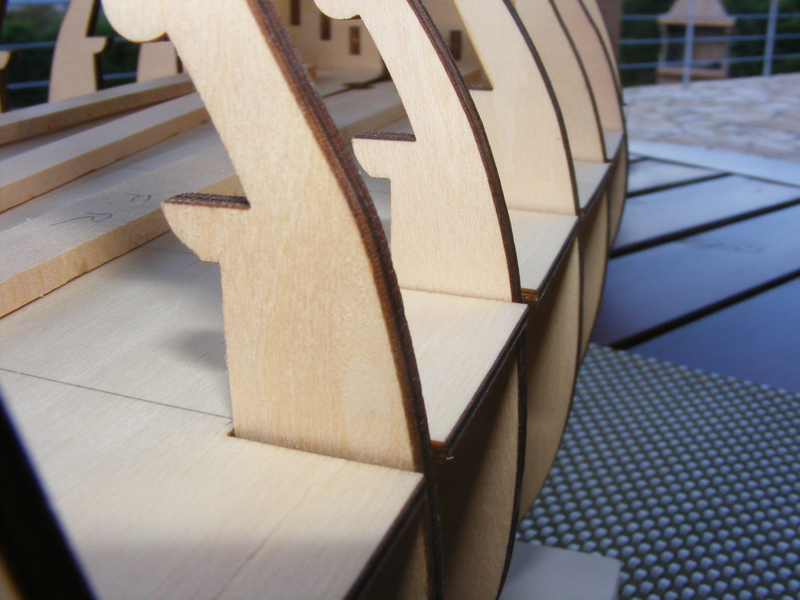

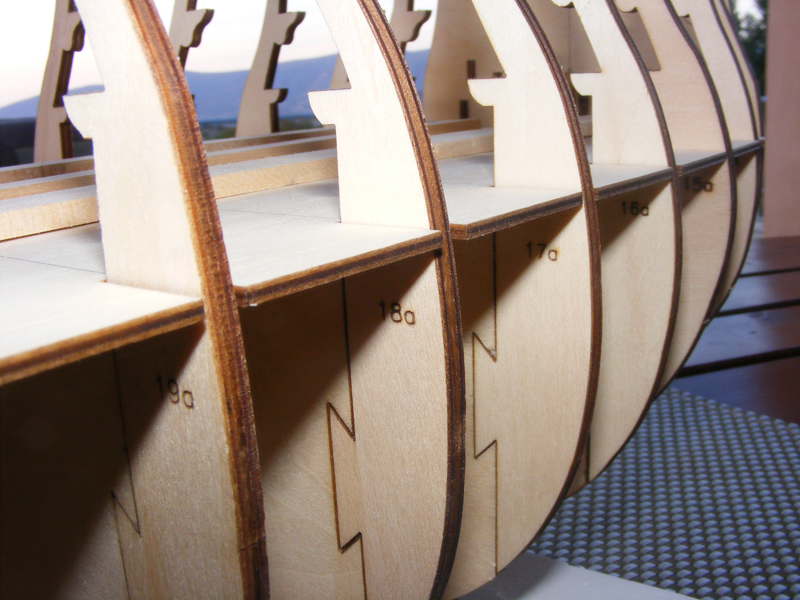

Tomick wrote:
Where any part of the deck exceeds the outer edge of the frames, the deck needs to be sanded back.
Interestingly my rib 15 seems OK but 18 (19 is a little 'out' as well) isn't looking too brilliant.
I presume I should not sand the deck back here but build up the rib, should I not?
John

Tomick wrote:
The deck should not exceed the outer edge of the frames, simply check the flow across the frames with a plank and fair to suit.
Sorry to be a bit slow but what does 'fair to suit' mean in my case?
John

What the deck? That will make a v shape then. Are you saying I should sand the deck back rather than build the rib up?
John
Jack Sparrow
#27 Posted : 23 September 2010 19:21:21
You have to sand the deck back to follow the curve of the ribs and the hull. Not sure about a 'V' shape, could you post some pics to clarify??
I did.
John

My apologies John, I did not see the links. As far as I can see yours are the same as mine, and looking at Tomicks build pictures he has sanded his decks to the frames, but then in another post he says the deck should not need sanding.Blink Confused So I am now in a dilema as what to do. I am glad I spotted your posts and looked through the replies as I was going to start fairing mine tonight!! I will not bother now until this is 100% cleared up!!
#31 Posted : 23 September 2010 22:13:13
If any part of the deck protrudes frame edges, the deck should be faired to suit the flow of planking across the frames, simply check with a plank.
Jack Sparrow
#32 Posted : 23 September 2010 22:16:44
Thankyou Tomick. Checked your pics too and I am now happy to get out the rip saw!!!LOL Flapper LOL No really, thankyou, I am now starting the fairing with confidence.BigGrin BigGrin
#33 Posted : 23 September 2010 22:20:41
Do it methodically and remove a little at a time and keep rechecking with a plank, its not a job to be rushed, did you buy some two-stroke oil for the chainsaw? LOL
But the frame/rib is inset/set back compared with the two either side of it. Surely this will cause a dent to appear.
John
#36 Posted : 24 September 2010 09:41:38
How does it look when you run a plank across the frames which includes any you are saying are set back, presumably you mean set back compared with other frames, what you are looking to achieve is a smooth flow of planking across all frames, can you post a photo?

If the frames are set back and when you lay a plank across the frames it dips in leaving a dent, I build the frame up with a 1mm plank untill it is slightly proud, then sand it back. Worked ok for the Black Pearl I am building. BigGrin BigGrin BigGrin BigGrin
