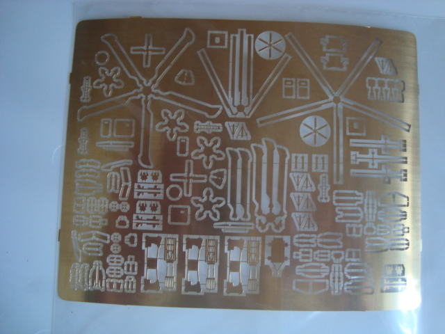

Good news is my etch arrived todayBigGrin I'm very happy with it too, never seen an A4 sized sheet before, 3 sheets in total so I can begin my build after a lot more reading of course, there is a very detailed 12 page book with it.
I have dabbled in etch before, 1/35 scale mainly but this is going to be a whole new experience for me.
Any tips welcome on here please, mainly would I be better off cleaning and priming the sheets as they are now in one piece or cutting them down to smaller sections as needed?

Thanks Jase, I have ordered the AK salt and deck wash too. Looking at your etch advice I think I will wash and prime the whole sheet first then, really thought it would just crack off when the etch was bent though?
#40 Posted : 07 June 2014 13:35:46
Short answer is yes it could. Personally i would not clean and prime until you need too, its amazing how much oils from fingers and work surfaces etch can pick up and you will be coming back to the same etch fret many times over the build.
I find it easier to clean prime and sometimes paint items like railings, ladders on the fret if there is no or little manipulation of the part needed. But for anything that needs more complex curves or folds better to form it first in my view. If the etch is part of a bigger assembly that is all one colour then i tend to prime and paint as part of the assembly.
I am guessing that much of your etch on this project can be painted with the main assembly as its largely all one colour.
Only other tip from me is spend plenty of time comparing your kit and etch instructions. mark up where you are using etch on the build instructions and you decide where you are pre painting and mark up on the etch instruction.
Final thing... Have you stated yetDrool Drool Drool Drool Drool Drool Drool Flapper
