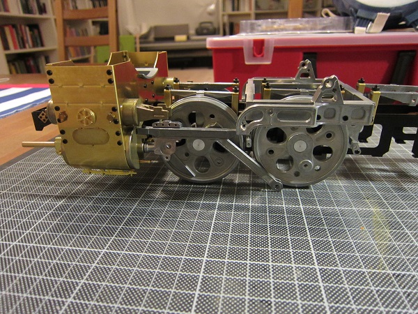

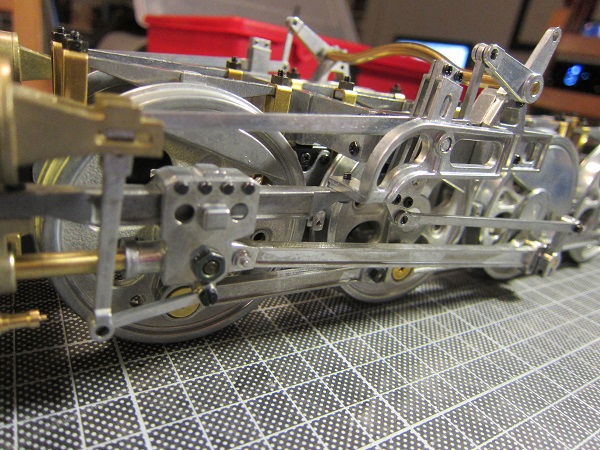

#26 Posted : 13 September 2014 09:47:47
Thanks guys for your nice comments!
I must admit this was the second time, i built this stage - the first time i didn`t read Mr.T`s official build - and didn`t use thread lock for those screws.
Regarding the thread lock i have a question: Now that i bought some, should i use the thread lock for all the screws, or is there some advice, when to use it and when not?
Thanks,
#27 Posted : 13 September 2014 12:27:43
One thing to check with your thread lock is the type you have purchased.
One will allow the screws to be removed with normal hand tolls the other sets solid and that could cause you some issues if you are looking to paint at a later stage at which point I believe some of the major assemblies are broken down again.
My own personal view would be to use it on screws that will no longer be accessible once the model is complete.
Enjoying your build.
Billy
#28 Posted : 13 September 2014 14:41:00

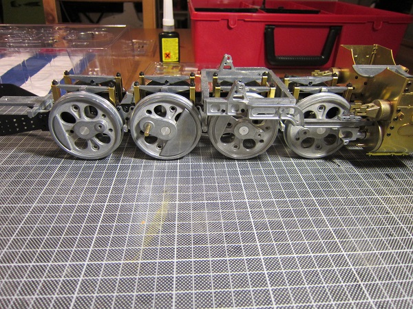

#33 Posted : 17 October 2014 08:32:42
She`s starting to look like a loco - now that the first wheels are on!
As you can see, i did not assemble all the parts of Stage 21 - as they will be dissassebled again in a later stage.

#37 Posted : 18 November 2014 23:16:43
It is a fantastically detailed model and it certainly looks like you are doing it justice. Great work
mwb
#38 Posted : 19 November 2014 03:04:35
Joined: 22/02/2014
Posts: 201
Points: 589
Location: Big T
Hi DaDokta,
Your build is looking good. This is a really fantastic kit. I did notice that the reverse shaft (brass piece with the curve in it) has the curve facing up but it should be down so the boiler will fit on the frame. Hope this helps.
#39 Posted : 19 November 2014 08:28:08
Thanks for the heads-up, Mark!
I just watched for the holes pointing to the rear - and forgot to mind the direction of the curve of the bar!
Fortunately this will be easy to correct.
Pilgrim
#40 Posted : 19 November 2014 10:46:13
Rank: Amateur level 2
Joined: 30/03/2010
Posts: 47
Points: 156
Location: Glorious Devon.
Same mistake I made but didn't spot it until much later when I couldn't get the main chassis to sit correctly. So much easier to correct it now than in a few stages time.
