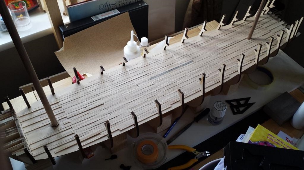

Well it's been a couple of weeks since my last update. I would love to report that I've made major progress, but I haven't!!
I'm still plodding along with the deck, which is now Maple strip and not Tanganyika as I originally planned.
The Maple strip was a little harder to cut than I expected, particularly when it came to trying to cut them in the Chopper. I went through a couple of blades before I switched to using a metal mitre and razor saw, which I found much easier. Typical really after I'd spent £25 on the Chopper specifically for cutting the strips!! Now I have a box full of what can best be described as coffee stirrers!!! At least they'll be good for something if this all goes wrong.
I practised laying the planks (very roughly) just to see what it would look like.
My plan now for the decks is to use diluted 'Weather It' to give a slightly aged look, then use Danish Oil on the lower and Antique Oil on the upper decks. This will be applied once the strips have been fitted and sanded smoother.
One thing I need to look into before gluing anything is simulating the caulking. I had originally planned to use a black permanent 'Sharpie' marker. Which would have been applied after the strips had been coated with Antique Oil to prevent the ink bleeding. But with my new plan, it will be bare wood, laid, sanded then weathered and oiled. I have looked at black electrical tape, but I don't imagine it would hold up to much sanding. Likewise using pencil, would probably be obliterated when it came to weathering and oiling. If anyone has a favourite method for caulking please let me know!!!
So I'm yet again having to stop and really think about what it is I want to achieve. This kit is very much one step forward and two steps back!!!
I have also started infilling between the bow formers in an attempt at adding a little more strength and surface area for when it comes to planking.
It still amazes me how solid this thing is becoming. It must be very heavy once it's finished!!!
