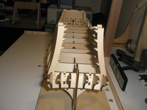

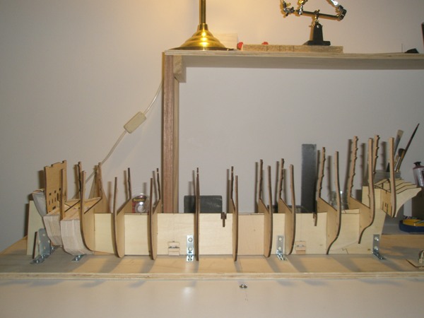

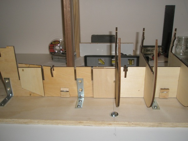

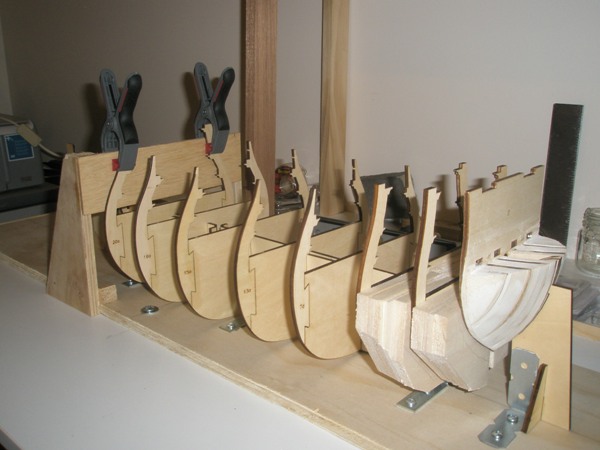

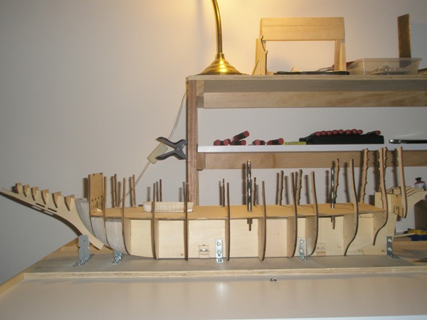

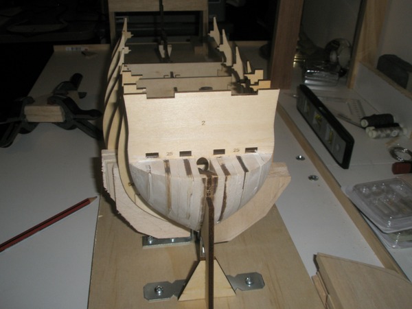

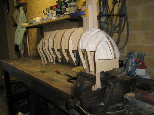

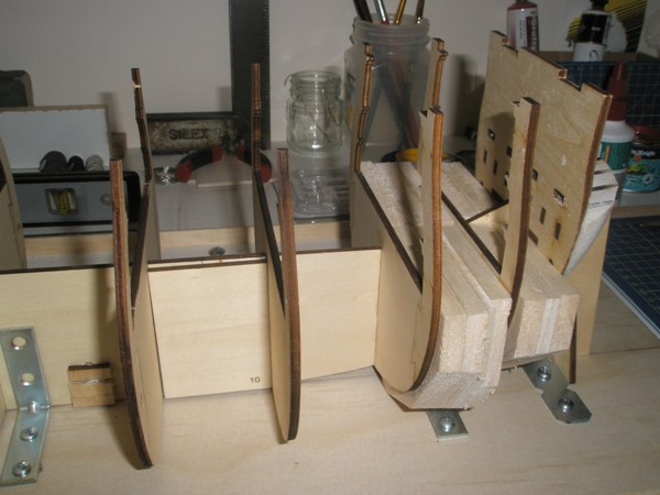

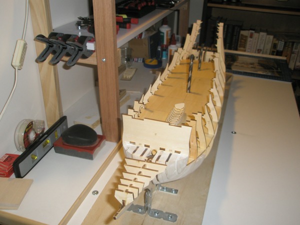

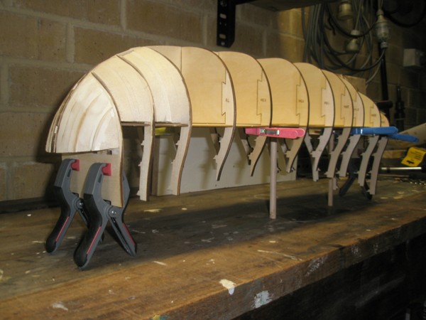

Here's some progress photos of my SotS build to date; up to issue 9.
There have been no major problems so far except that my base board started to bow upwards in the centre (about 5mm) so she was in effect riding on the crest of a wave. Fixed it with a 1/4" bolt, wing nut and washers right through the workbench, so it's a nice flat surface again. Pic #1.
Rib nos. 13a & 15a are warped slightly leaning approx 5deg forward. They are glued nice and flat to their respective frames - the warp starts at the top of the frame. I think the fitting of the deck plates will align them correctly.
Frame 27 is only dry fitted, following Mr Tomicks' Official Build.

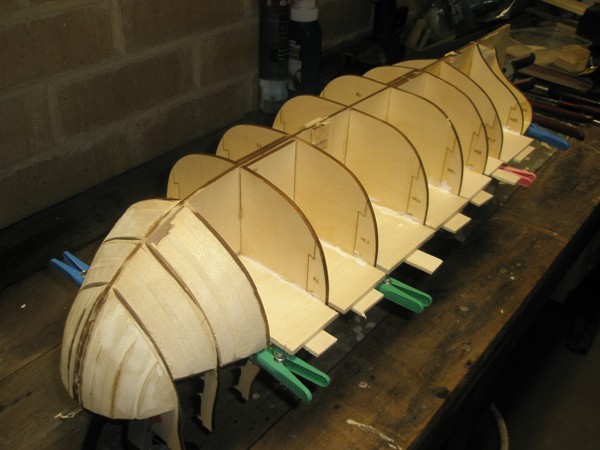

Have decided to infill the hull as per MWG's excellent tutorial and have made a start at the bow section.
Made a start also on the ships' boat - fiddley little critter isn't it?BigGrin
Cheers all,
JohnP

#22 Posted : 10 May 2014 22:00:18
Nice work John, she is starting to show her shape.... well done.... Cool Cool

Thanks for your complimentary words of encouragement - and yes I intend to infill the hull, following MWG's excellent tutorial and additional help from Mr Gandale's build diary. One problem I had there, was in keeping the work steady and immobile in a safe and secure manner as I didn't want the model resting upside down on the tops of the ribs. Neither MWG or Mr Gandale seem to address this issue so I used a clamping system on my bench in the garage. It works well and the ship is kept safe and secure.
Pics below;

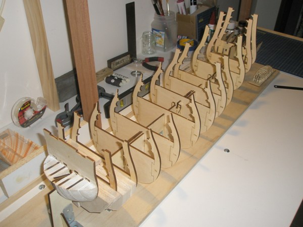

#26 Posted : 22 May 2014 11:54:56
Joined: 25/04/2014
Posts: 374
Points: 1,134
George1 wrote:
Hi John
Good thinking and great idea re the clamping to save rib frames from possibility of breaking under pressure when upside down.Cool Cool
At this stage we don't have any decking or one tip I got from a query was to use doweling on a base in mast holes as a support when ship required to be upside down for things like infilling, painting, planking etc., to save breakage from pressure. BigGrin
Well done John. BigGrin
George
Hi George
Thanks for the tip re the doweling, I'll need to get some.

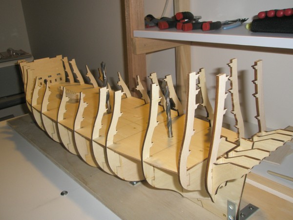

Went to the newsagent today and got issue 11 and have dry fitted the lower deck panels. All slotted in nicely except panel 31 starboard side. I had to tweak a couple of the rib slots a little bit. Frame 6 was the culprit - not quite square with the keel at about 1mm out.
In the interim, I have used a 9.5mm drill bit for the main mast locator and a 7.5mm drill bit for the after mast. Any idea what the mast diameters' are at the base?
Pics below:

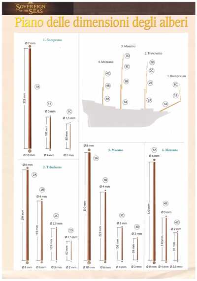

Hi George
The reason I asked about the mast diam is that the after mast bushing on the keel would only take a 7.5mm size bit - maximum. The hole in the deck is a loose 8mm. If the mast is any bigger, that bushing will have to be adjusted to suit before everything is enclosed permanently.
Maybe I should ask Mr Gandale.Confused
JohnP
#29 Posted : 22 May 2014 19:20:05
BigGrin Hi John just read the post the main mast is 10 mm with a taper down to 8 mm hopes this helps BigGrin Rgd Martyn
#30 Posted : 22 May 2014 19:57:28
John Passmore wrote:
George1 wrote:
Hi John. BigGrin
Looking the goods mate. Cool Cool
I had to adjust slightly too at the bow as was a little tight till I did. BigGrin
As for diameter mast holes just need to measure holes in decking. I'm not sure offhand.BigGrin
I will have to measure up for doweling as well to make up a base after second deck on for bottom planking and any later painting.BigGrin
George
Hi George
JohnP
Hi John, from what I can see and looking from bow to stern thickness at the base of the masts are 8mm, 10mm and 8mm. The bowsprit is 10mm thick...Cool Cool .. This pic may help..
Hope this answers your query.

Hi Alan
Thank you for your response and the mast dimensions - I can just make out the numbers! I've adjusted the after mast bushing to accept 8mm bit nice and snug. It was the slot in the keel slightly undersize.Cool
JohnP

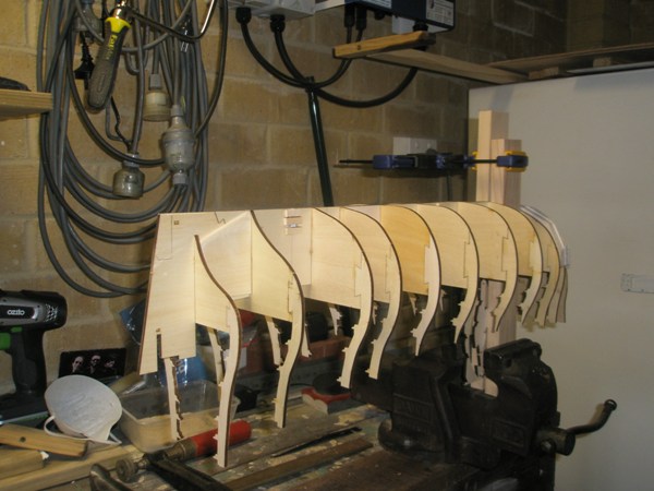

Meanwhile here's some pics of progress so far;
John Passmore attached the following image(s):
MichaelKan
