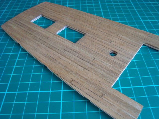

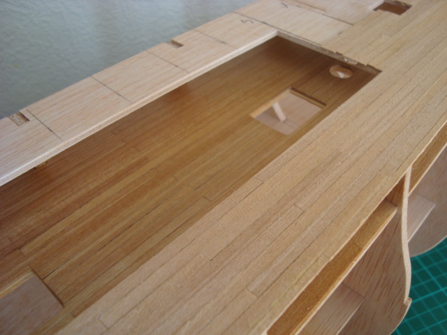

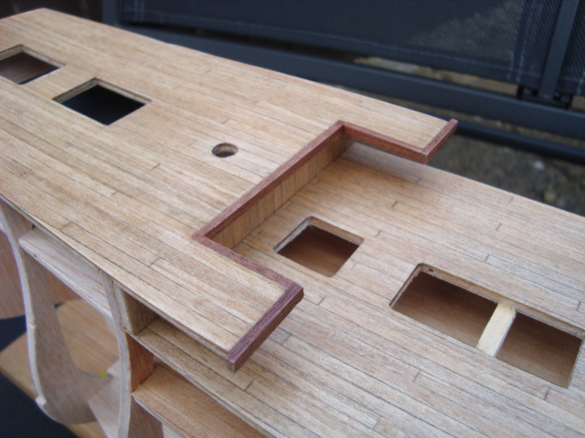

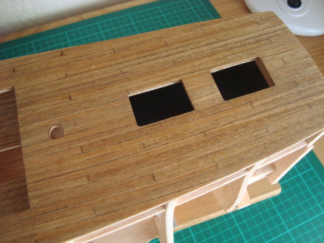

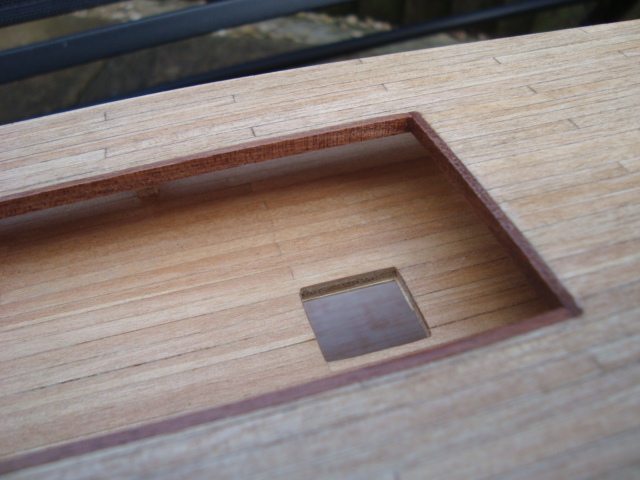

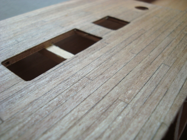

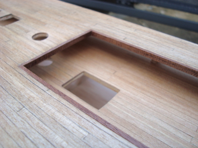

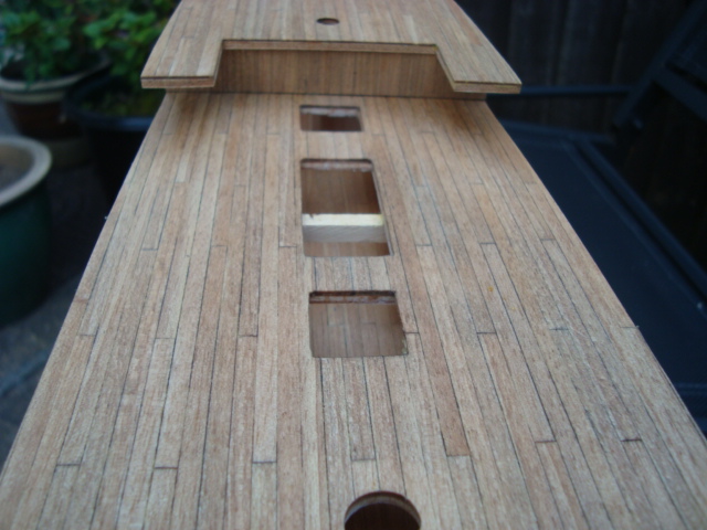

Nearly completed the 3rd pack now, just some trim around the poop deck edge and the deck cutout and Im done for this monthAngry
The deck is done with the "weather it"" solution but this time a much weaker mix, i used a ratio of 1 part of the solution to 7 parts water as I wanted it not as dark as the Victory deck. This was followed by a Danish oil and alcohol mix.
Another thing to note is that I have blacked out the 2 poop deck hatches as I didnt plank below them, I was getting low on my Tanganyka strips so just to be sure I saved as much as could. I think the black card will look fine once the hatches are on.
Cheers
Gibbo

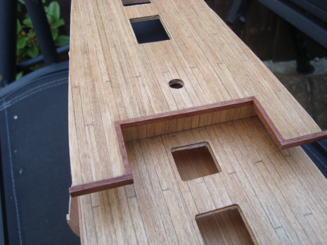

I have now completed the 3rd pack (stages 11-15) This only involved fitting the walnut trim around the cockpit and poop deck edges.
I have just received stages 16-20 but these are the start of the x-section build, this build is unlike the Victory in that the x-section is combined throughout the build and not tagged onto the end.

BigGrin Nice progress Steve, the hard wood horns on the stern deck are sanded flush with the deck sides. Otherwise the cannon port strips will not fit.
#30 Posted : 18 July 2014 21:07:06
#31 Posted : 18 July 2014 21:14:10
BigGrin Yes i thought the same i think its so there is plenty of meat to sand back to the correct angleCool

Nice work on the deck's good thinking about the type of wood.

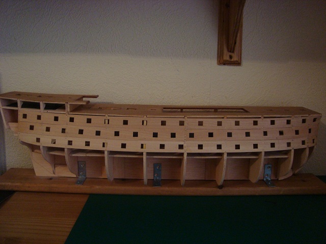

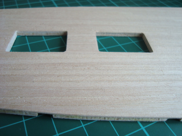

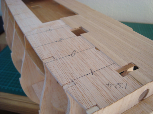

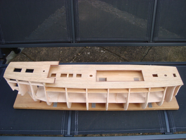

Managed to catch up with my parts now, just fitted all the gunport cutout / templates. Should be making some more progress with this now along with the Victory hopefully as I currently have no plastic kits on the go BigGrin
I havent fitted any of the dummy gun supports as these were just squares of wood glued to the back of the cutouts, I plan to have the gunport lids closed on this one anyway as I'm not sure how the dummy cannon will look as there is no depth to the ports.
More soon hopefully

Thanks Tony,
Yes, the gunport strips are just a template for the spacing, there are 2 layers of planking to go on top yet and these are obviously cut to fit around the ports. Still saved a bit of work on the marking out etc

Hi Stevie, coming along very nicely indeed..... Cool Cool You bring up a really good point that I hadn't really thought of relating to the dummy gun supports and their lack of depth... Think now you mention it the lack of depth would really look quite false on the finished build so the idea of closed gun ports would be preferable..... Am thinking more along the lines of removing the gun supports altogether and fitting full gun carriages, that would also get rid of the depth problem...... Cool Cool . Look forward to seeing more of your build....
#40 Posted : 28 August 2014 23:59:38
Thanks Andy, I reckon the dummy guns will come very late on in the build as per the VictoryBigGrin
Alan, I'm just guessing about the final look of the gunports but on the Victory there is actual depth, about a 2cm recess where the dummy supports are set back so looks ok.
Anyway, the decision is made now and I think will look fine with the lids closed, the top deck will be open as these are all full rigged guns.
