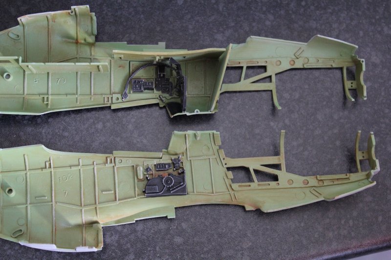

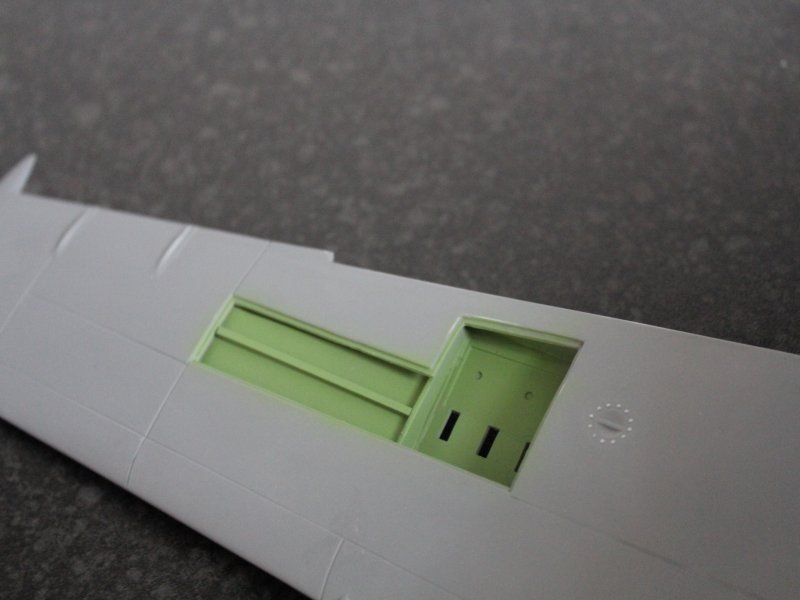

Only a small update but once again using plasticard to make up more detailing in the wheel wells and one of the wing gun ports.. Soon be time to start adding some plumbing! BigGrin

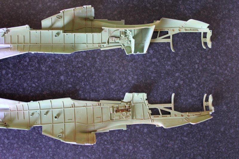

#22 Posted : 16 April 2014 22:12:01

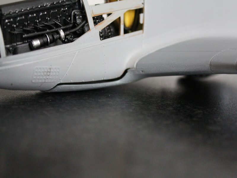

Another update and a little more done to the wheel wells and some interior work done. Small details need to be picked out and a lot of wiring work to the wells..
Spencer

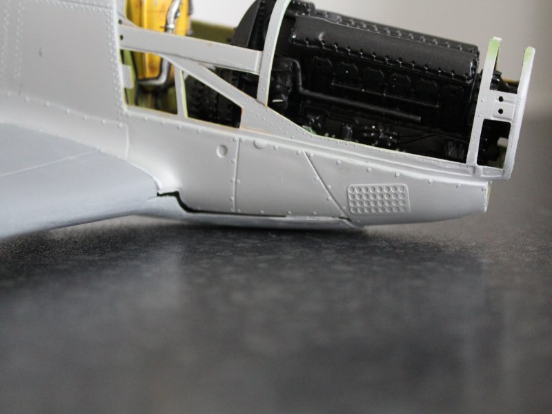

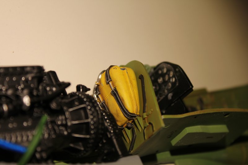

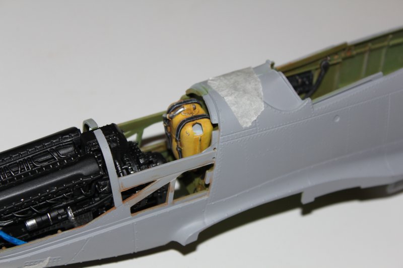

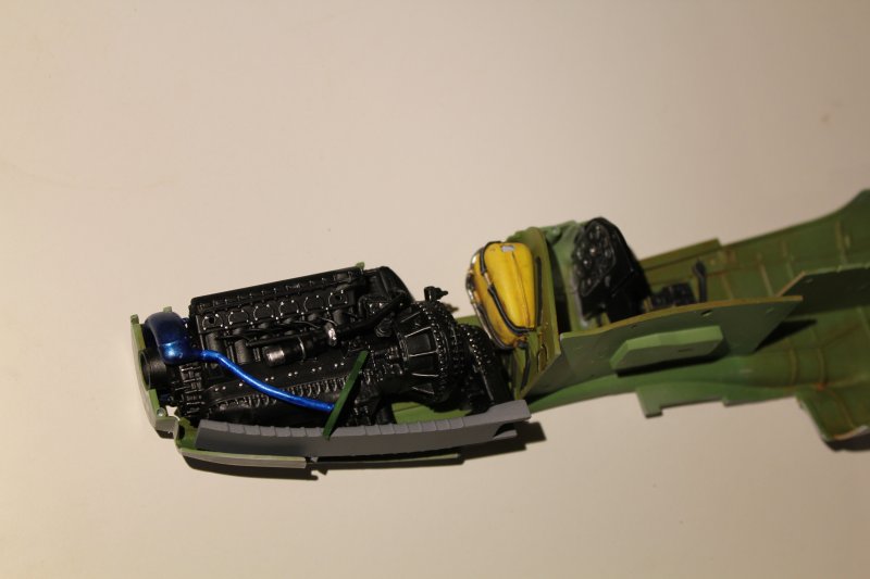

#27 Posted : 06 May 2014 21:14:34
Just a small update as I think i will have to competely rework everything that Airfix calls an engine support! after test fitting etc it's obvious that the kit supplied part will not be sufficient enough to hold the it in place so a bit more scratch building needed.. Anyway, pic below shows a bit more work done under the hood but everything is loose fitting for more work..
Spencer

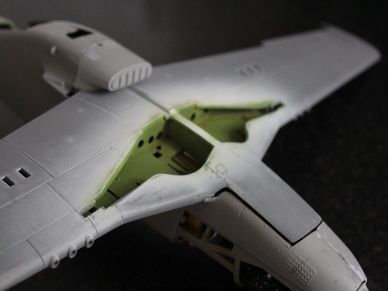

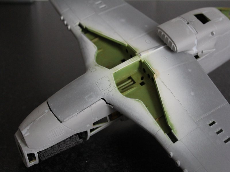

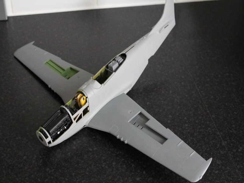

#32 Posted : 23 June 2014 22:17:26
Hi Chaps BigGrin another update and some more progress to report albiet not a lot but enough to see some progress. When I started this kit I was looking forward to what I can only say would be an easy straight forward build.... but there is no easy when it comes to the older Airfix kits and this one has proven to be no different. As you will see from the pictures there are a lot of gaps and before I can even think about starting to add more detail and fight with the parts when going together I decided that I would assemble the main parts and tackle the details later.. and i'm glad I did as you can see by the gaps that will need to be filled with styrene sheet and sanded down. Once this is done I will then turn my attention to the engine bay and start to cut things about until I'm happy with the results.. untill then enjoy BigGrin
Spencer
#33 Posted : 23 June 2014 23:46:09
You say old Airfix kits, the new ones are only a bit better when it comes to fit. nice job so far I feel another masterpiece coming along

#36 Posted : 24 June 2014 08:41:22
I hope the new Typhoon doesn't have similar gap problems Blink
Keep up the good work Cool
#37 Posted : 24 June 2014 10:03:23
The fit on this kit is horrible, one of the worst I've seen and I have done a few 70's and 80's Airfix kits. I'm sure you'll do a great job with this though, you may need to order some more fillerBigGrin
Thanks for the encouragement SteveBigGrin yes it is a bit of a dog but as I've said before about troublesome kits, it's something that makes the build more enjoyable having to find ways of a fix.. May not be the best fix mind!LOL
