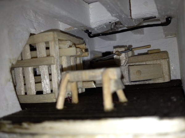

This one is my carpenters workshop with tools ,not quite to scale but just gives an idea what it was like
robbyrob60 attached the following image(s):

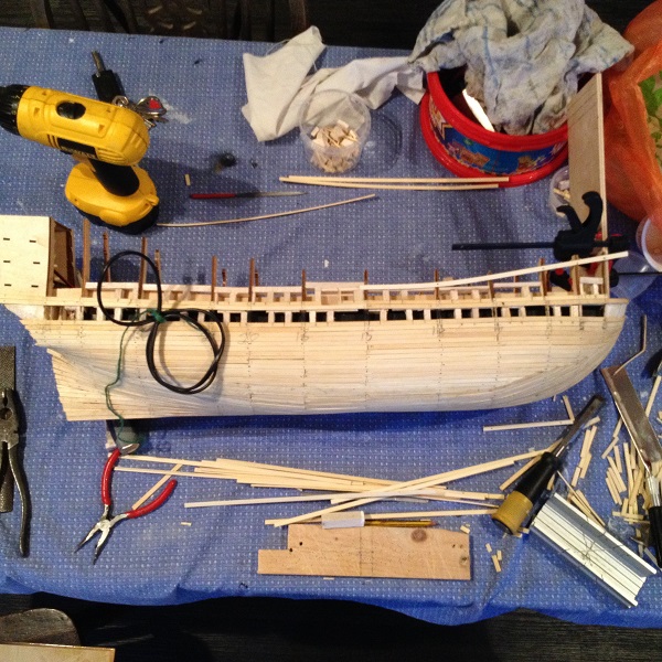

Halfway through the first layer of stakes

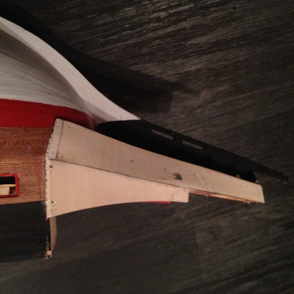

This is the part i dont know how it finishes.,does it fix to side of boat or does it go in at a angle to fix on the bulkhead ?
#27 Posted : 25 March 2014 00:06:43
Hi Robby, I fitted my panels so they rested ever so slightly on the side of the hull.... notice on yours you have added a small extension that shouldn't have been necessary but providing it is sanded down shouldn't be noticeable when painted..... I also had to resort to some strategic clamping to keep the panels in place until set.... a fiddly process..
Mr T's official diary probably shows the fitting of these prow panels better than anything else I've seen on other diaries. This is a link to the stage on his official diary..... hope it helps...
http://forum.model-space...aspx?g=posts&t=7031
Think you are doing a great job so keep posting...

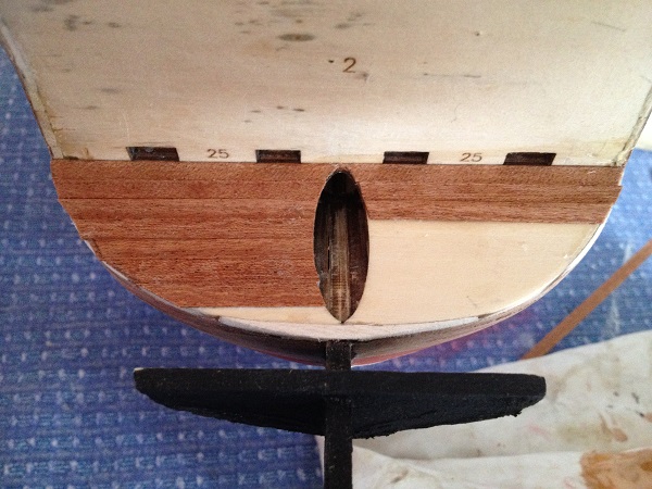

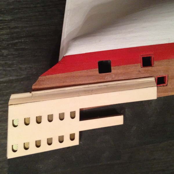

I decided to make my bulkhead removable then i can cut the holes of the ship easier for me .The bow i planked in sapele instead of stain and the platform for the beak i also planked in saple,

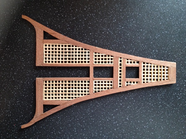

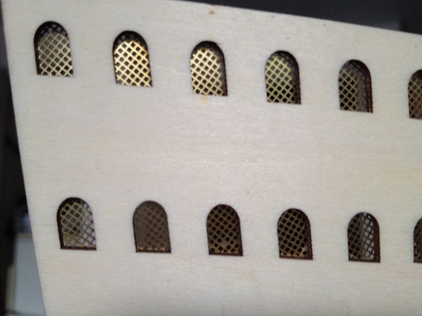

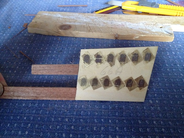

The walls of left and right gallery i used sapele instead of stain ,and the windows i cut the mesh in small peices and turned at an angle and got diamond instead of square mesh and also doing this i had a spare peice of mesh over

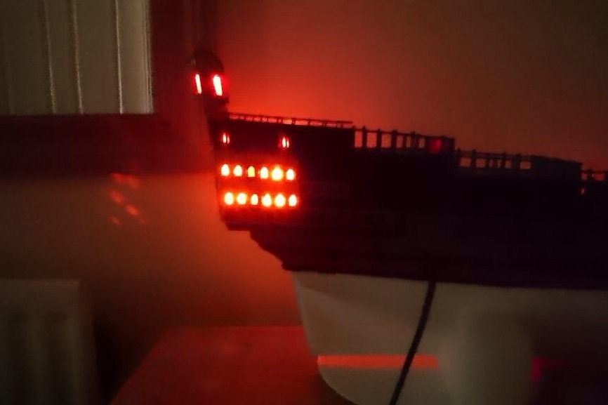

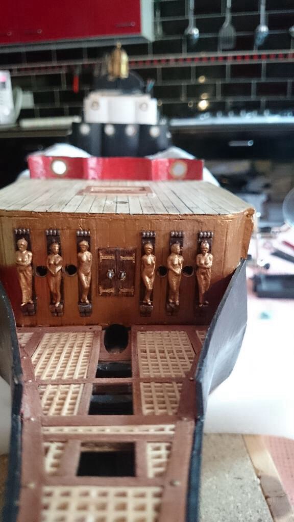

Hi all been a while, but lost all photos when changed phone but hey ho on we go, I've decided to paint the forward bulkhead gold as well as the side galleries
