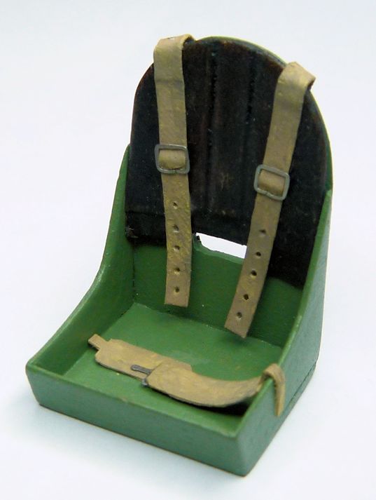

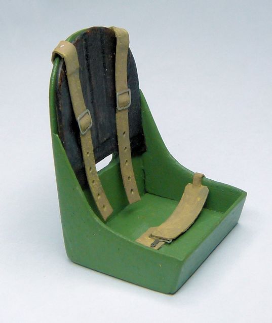

ok seems to be a few pondering on making a seat harness, Tomicks hands are tied with any alterations and must build the kit as is, so i had a go at this, see pics, will be doing a full tutorial
Hi Willz, BigGrin
WTG seat looks good, that was fast work.Cool
Only issue I can see is that the upper harness straps were not fitted to the seat, they were fitted over the protective plate behind the seat and through the main air frame.
I assume it`s the same as car seat belts today are fitted to the main car frame.
Hope this helps,
#38 Posted : 27 March 2014 08:40:16
Nice work Wilz and a vast improvement Cool
Just so you know. There are a few further panels to add to the supplied seat, a cockpit floor panel, back and front bottom edge panels which will be fitted later on in the build.

delboy271155 wrote:
Hi Willz, BigGrin
Hope this helps,
thats correct Derek, there`s also a Y section where the top fixes to the back of the buckles and the bottom goes through the hole in the seat, but sometimes too much makes it look too busy and messy, i`m not personally doing this model but i like to do these small projects, as for the tutorial i think i`ll do it on the tutorial site thingy.
cheers Willz
