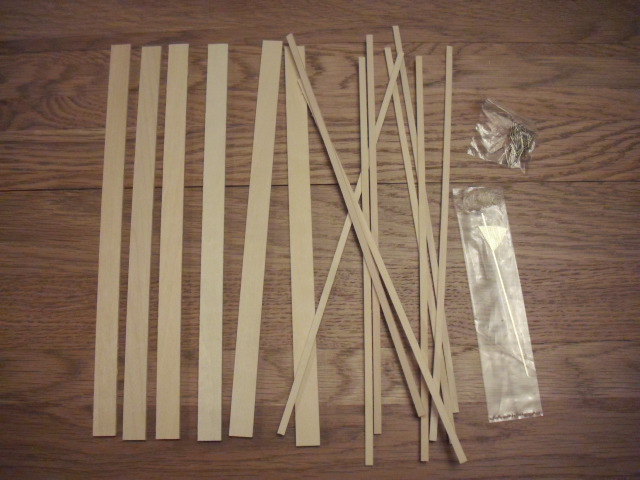

ISSUE 12 BUILD
Hi Team well it is onward and upward.
I have incorperated a couple of enhancements this week, but first this is what we received:-

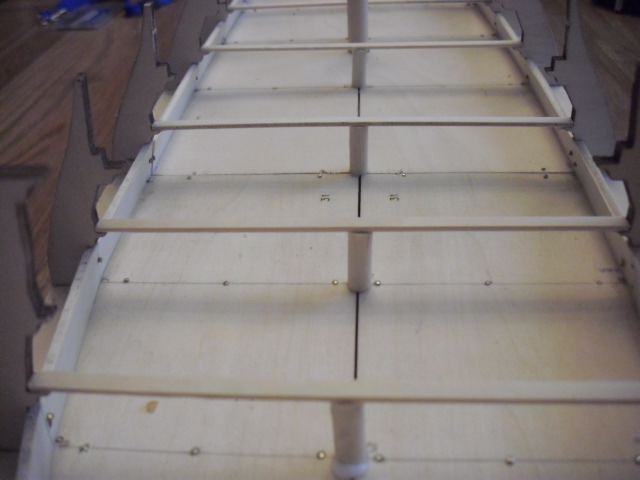

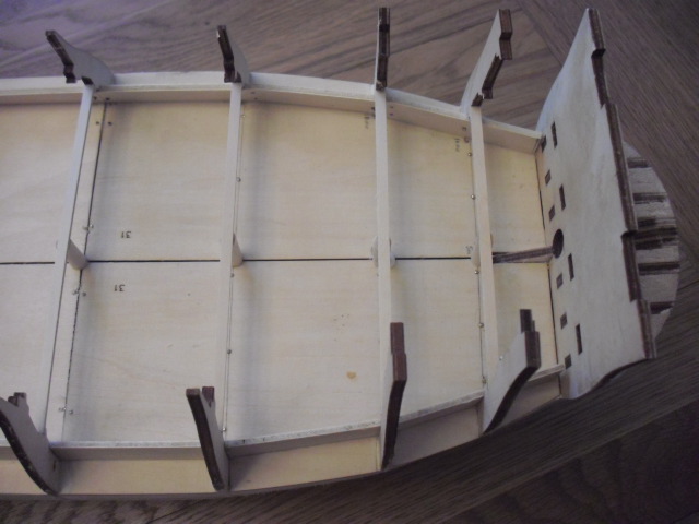

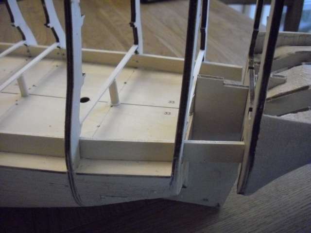

ISSUE 12 BUILD

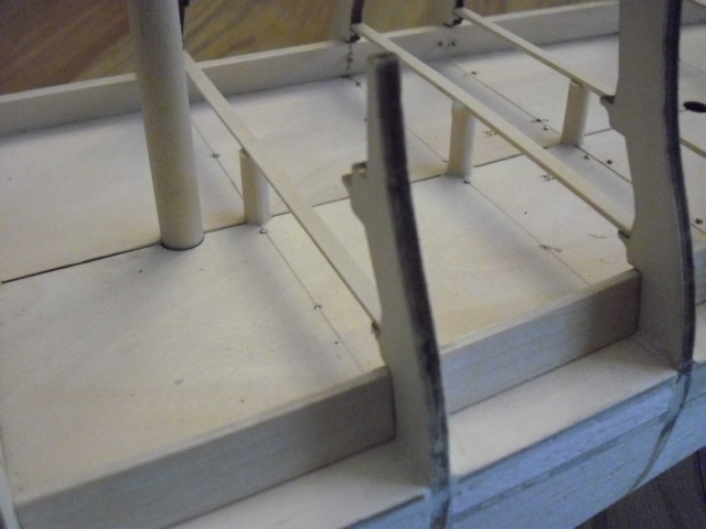

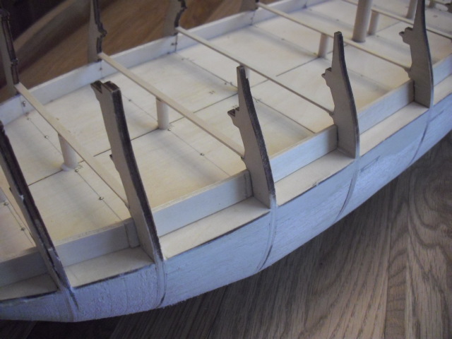

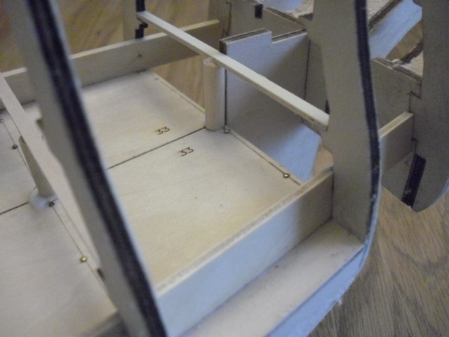

The object this week is to fit the Dummy cannon beams, and deck supports between the ribs, to support the next deck, wether it be another ply deck or deck planks, as yet we do not know.
I followed the instructions, no problems there, but I did add the two enhancements ---- the first was to also pin the beams to the inside of the rib with a pin punch, this gave a much better fix.
The second enhancement was the inclusion of a piece of 1/4inch dowel underneath the deck supports (Placed in the middle) the reason for this? well what ever deck we put on next we are going to apply pressure to the beams, this could result in breakages in the centre of the deck supports, its just an extra precaution:-

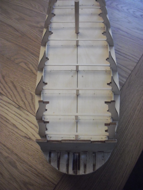

ISSUE 12 BUILD

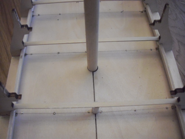

Please make sure the mast hole is free and in line by using a piece of dowel of the correct size:-

#374 Posted : 22 November 2012 15:31:52
Hi Mike, nice idea with the bits of dowel. I take it there are no openings in the next deck to make them visible.
#375 Posted : 22 November 2012 15:48:22
Hi Greame,
MR T has alredy posted the next deck to be fitted will be the same ply as this one we have just fitted, plus there will be no deck openings, and so the dowel will not be seenBigGrin I hope that helps, kind regards Mike

Hi Mike
Not up to this point yet but I can see the wisdom in the dowel supports. I would not deem to teach an expert how to suck eggs, but my thought is that if we are fitting the same sort of deck as last time, then may be 3 dowel supports across each cross beam (evenly spaced) may give more pinning points ,or would that be classed as overkill.
