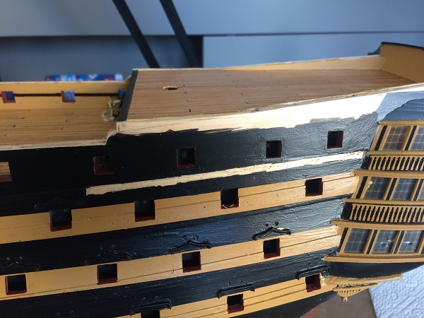

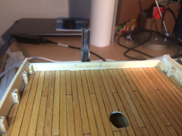

Next up was the skid beams and lining of the waist:

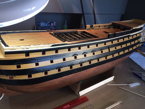

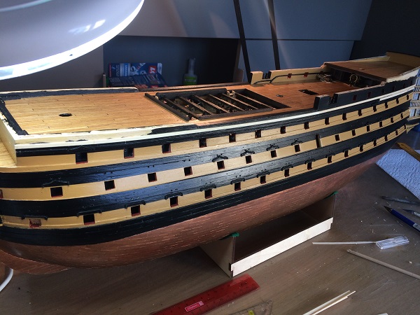

Next task was the forecastle. Again studying Pictures and my books i somewhat deviated from the instructions.
I made the forward bulwarks less high (6mm).
Also they go further back to the front opening of the waist.
There is next to no decline in height of the bulwark.
Also what i could see from pics - the forecastle bulwarks were painted black - not yellow ochre:
I used a 5x5mm strip as cattail:
Finally i attached the cap strips at the waist:
I spent quite some time thinking about those cap strips. In my opinion they don`t look right. 2mm strips would mean about 17cm on the real ship - i think that`s too thick. Also there was next to no overhang to the inside - so i think the 10mm strips are too wide.
Next thing is i want my cap strips to follow the curve at the bow (if possible) - in the instructions they just run straight to the forward bulwark - which doesn`t look right.
So i decided to use 1x8mm strips for the rest of the cap strips - which means i have to wait about a week for delivery of those strips.
I hope this will give the ship a more "slim" and elegant look.
What do you guys think about my thoughts? Your advice is always welcome!

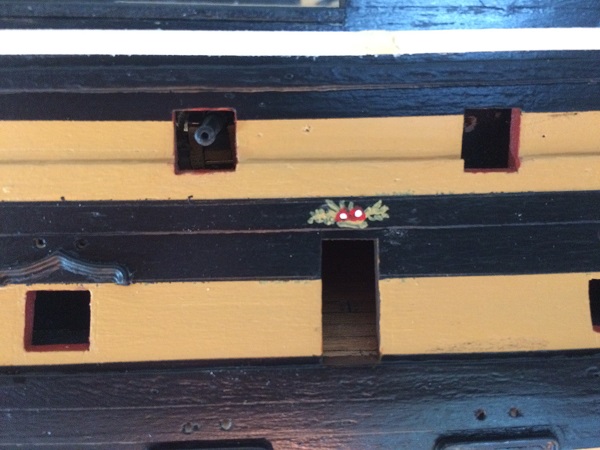

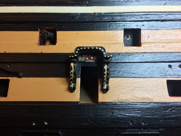

#370 Posted : 22 June 2017 11:15:37
Entry ports are done!
I must admit this is not my best work - but i somewhat lost the patience. The paintwork is not very satisfying.
Also it wasn`t until everything was attached and dry that i realised that one of the roofs is not completely horizontal.
Thanks for looking in!
