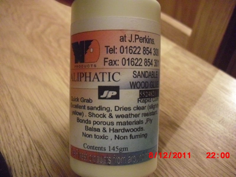

Hi Karl, I will put photos of the one I use, its also weather resistant, I have never found it water soluble when fully hardened.
when you have just applied it, you can wipe it off with a damp cloth,but after about 24 hours when its cured, I have never been able to free it with water or steam.BigGrin

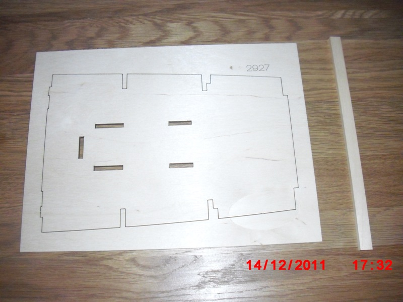

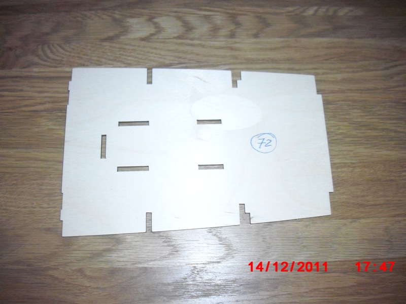

ISSUE 16 FORE DECK
Hi Team this week we received, this part:-

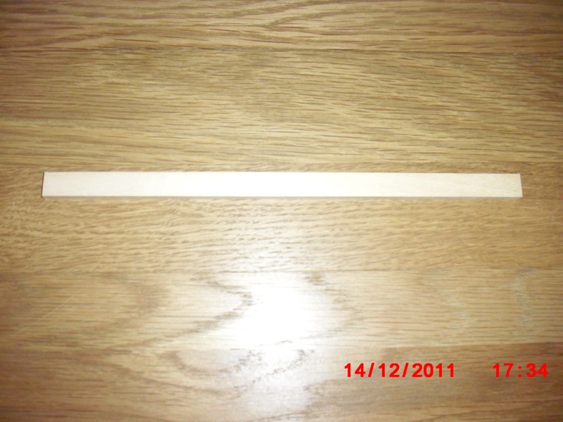

ISSUE 16 FORE DECK
I put this part (Deck Beam) away as instructed:-

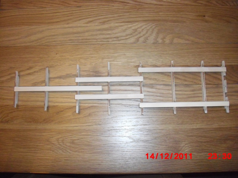

ISSUE 16 FORE DECK
I then numbered the part that was left, and then cut it out from both sides as usual:-

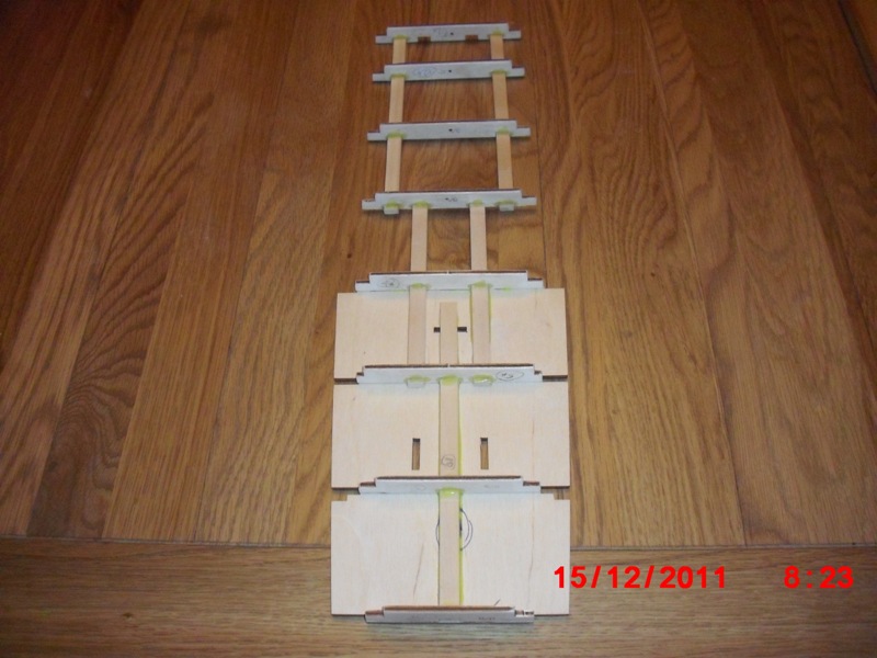

ISSUE 16 DECKING BEAMS
I then sanded the frames very well, as per the instructions, but I also sanded the deck beams flush with rib tops which they are attached too.
I spent alot of time on this area in order to fit the Deck flush, and the frames to come in and out freely.
I feel this is one of the most important parts to get right, so please do not rush this stageBigGrin

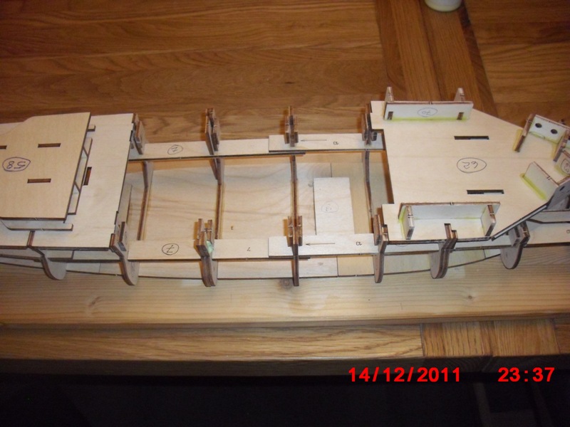

#369 Posted : 15 December 2011 00:11:57

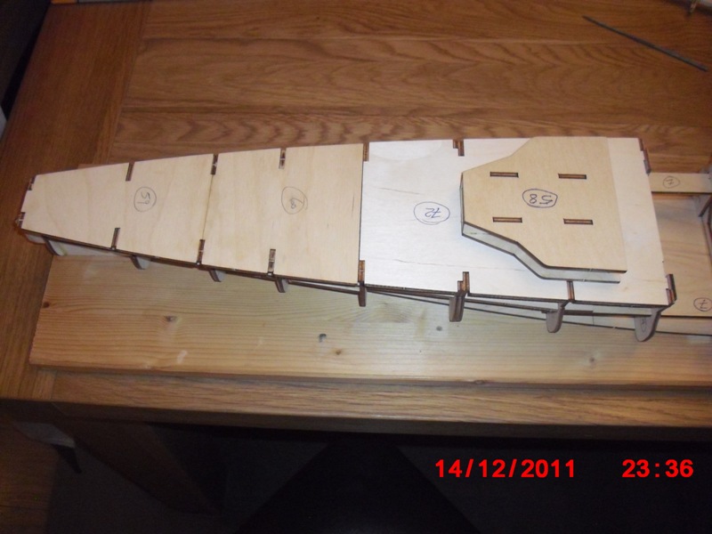

ISSUE 16 FORE DECK
I then dry fitted the piece of deck, I need to spend alittle more time on some of the rib tops particularly 3a and 2a before I will add adhesive.
The deck fits flush, and I have placed part 58 in position where it will be attached to this section of Deck.
This is how she is now, more tomorrow comments welcomeBigGrin :-

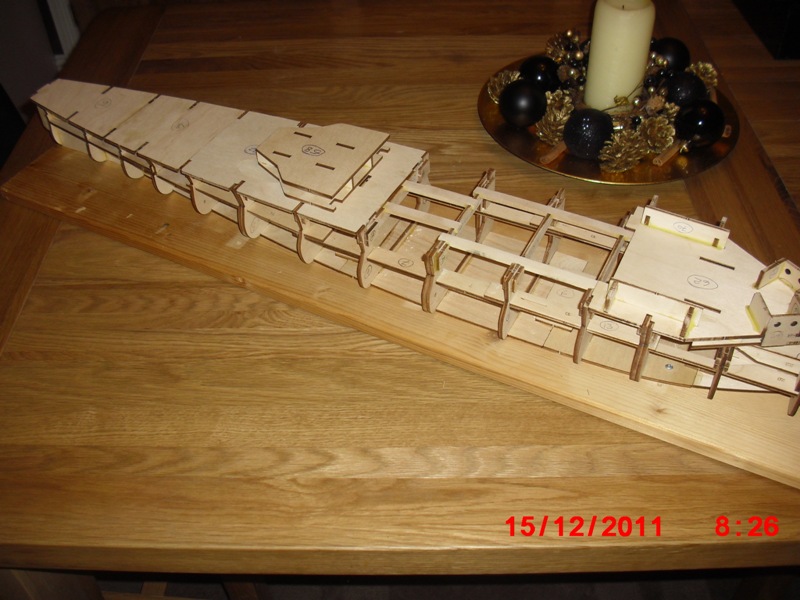

ISSUE 16 DECK PLANKING
I have finished sanding and adjusting and I am now happy with the end result, the deck is now fitted to the deck beams:-
#374 Posted : 15 December 2011 21:21:36
Again I put extra adhesive in plases where it can not be seen, for strength, next week we will receive the Decking for the middle part of the Hull as in this photo.
And here is how she looks at the end of this session:-
