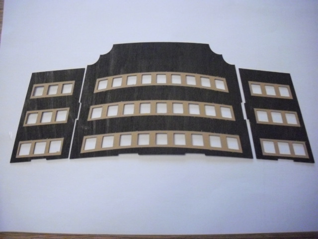

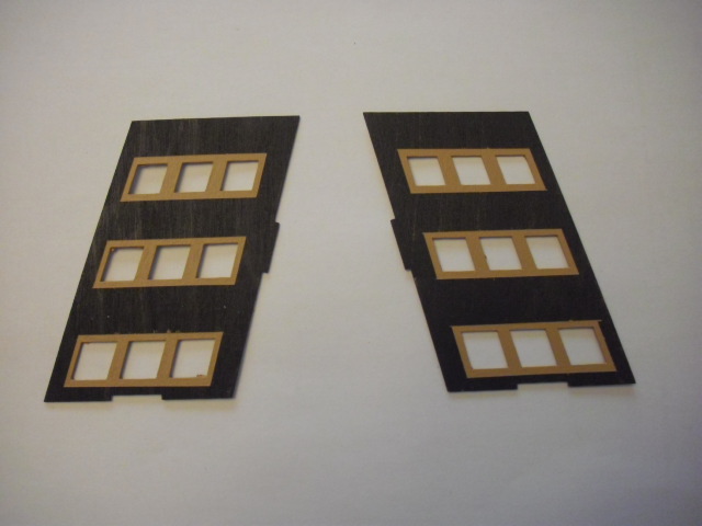

Hi Team how did you get on with the painting so far? 4 thin coats later when you remove the masking tape phase one should look like this:-

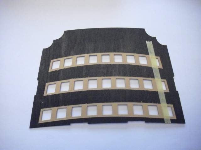

Now we mask the Ply 1 first fit the tape down the way 1mm from the edge of the window sides:-

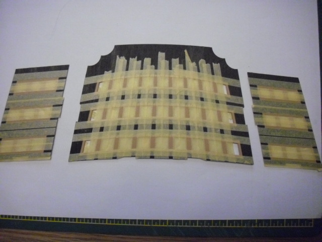

When you have finished all the down tapes, you will then need to place masking tape across ply 1 covering the yellow ochre top and bottem of the windows, like so:-
IF YOU ARE NOT SURE WERE TO FIT THE TAPE PLEASE ASK!!BigGrin
#370 Posted : 16 November 2012 14:49:12
FITTING THE GALLERY ENHANCEMENT
PAINTING

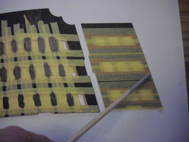

Having completed the masking as per the photos, please use the end of a paint brush and rub all the areas where the tape meets the parts so we make sure it is well fixed before painting:-

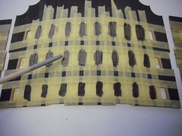

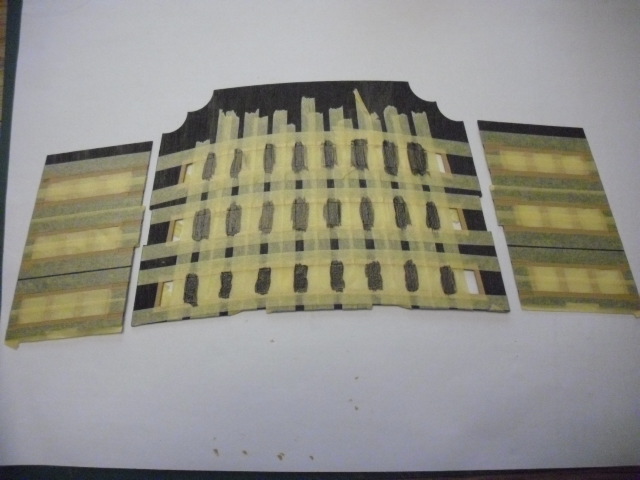

Just for clarity these are the areas we are going to paint, with 3 to 4 coats of the relevant colour:-

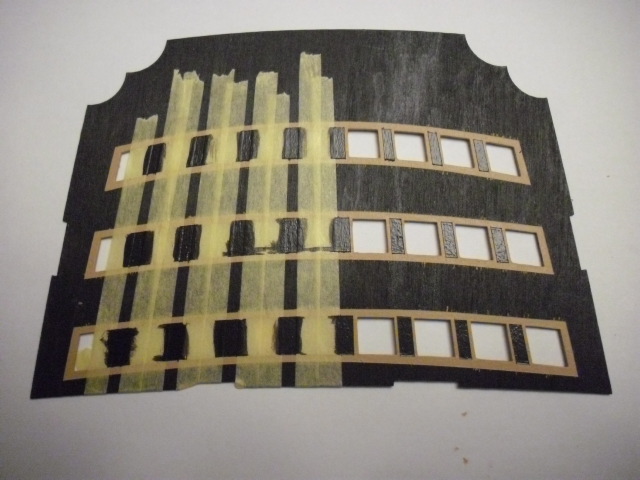

Thank you for watching, thats all for this session, please remember questions and comments are welcome.
You will realise while you are building this Enhancement you have something very special and uniqueBigGrin Kind regards Mike
PS I will leave you with a photo of where we are at the moment (one coat of paint completed.)

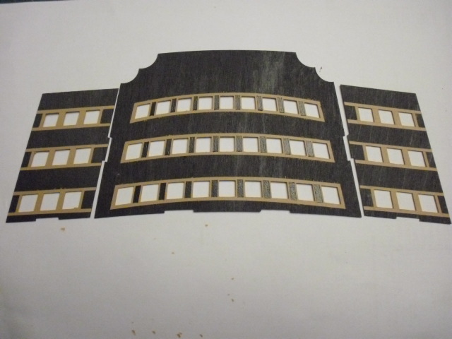

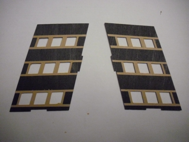

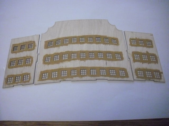

Hi Team, here we are again with a further part of this rewarding buildBigGrin Lets have look at our results of last time:-
#380 Posted : 19 November 2012 21:07:41
PAINTING
The photos tell the story, you can see the new painted areas, from the black squares on ply 1, to the extra lines on ply 1a and 1b, I have again put the painted parts over the windows so you can see the effect I HAVE NOT USED ADHESVIVE, just dry fit:-
