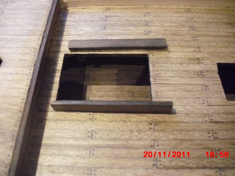

I decided to build this piece of Deck furniture,I intend to make sure it is not glued to the deck untill the Hull is second planked.
I stained to 300mm x 7mm x 2mm and started to cut into lengths, the deck opening on my ship is 56mm x 43mm, I cut all pieces 10mm longer because I am mitering the corners, not straight like the instructions.
Here are the first photos of the long side pieces, under construction:-
#362 Posted : 20 November 2011 19:10:33
In the last photo two strips have been stuck together to form the lip to fit over the Deck, and the lip to take all the cover planks, for both sides.
Questions and comments welcomeBigGrin Cool

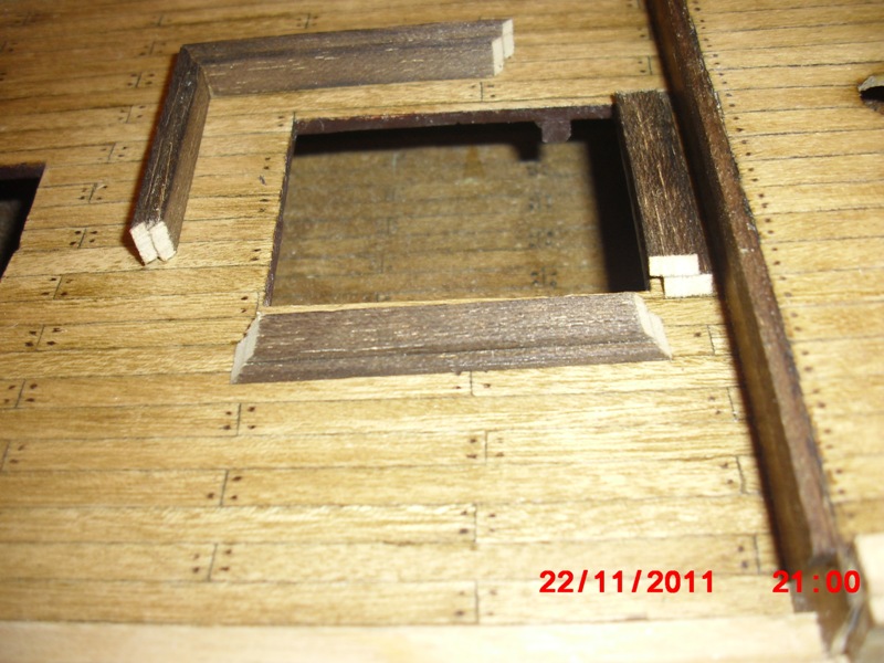

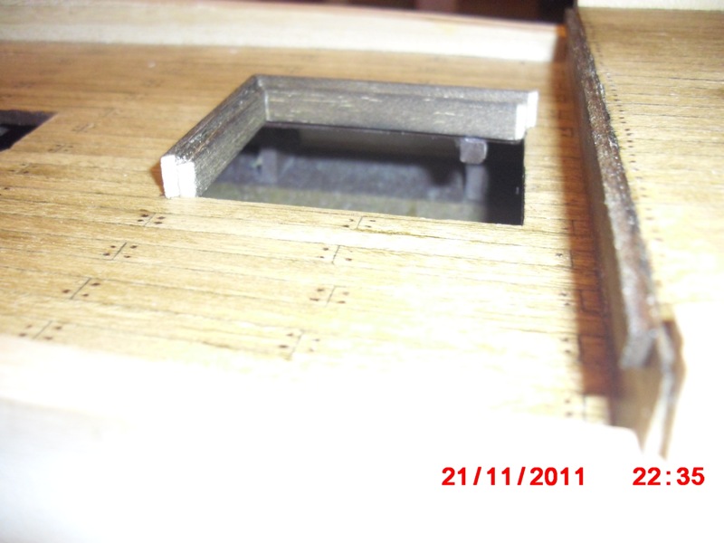

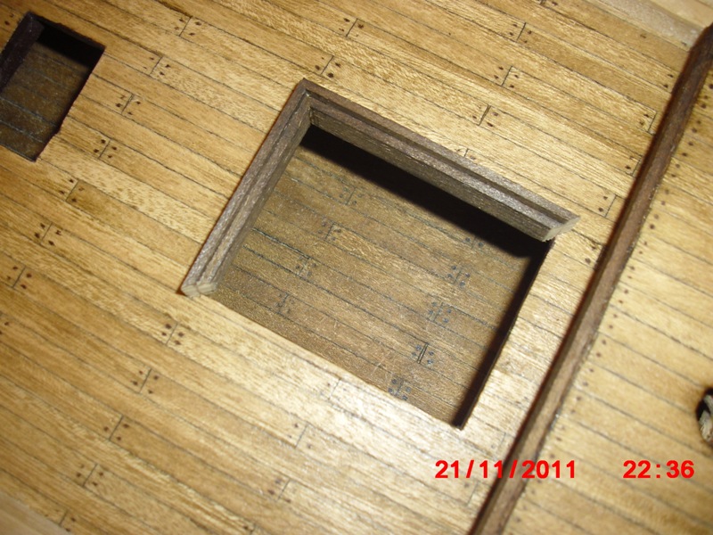

#363 Posted : 21 November 2011 23:15:19
ISSUE 38 MAIN HATCHWAY COVER
Continuing what I started I cut the Mitres as planned, and the result I was happy with, the pieces are glued at the mitre only so when it is made I will be able to remove it from the ship and store it safely
Now to do the the second half of the Hatchway.I did exactly the same s the first half:-

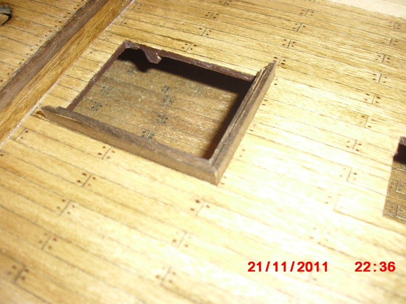

#366 Posted : 22 November 2011 22:05:54
And so its complete only the 2mm x 2mm to fit around the edge, and then the planks on the top:-

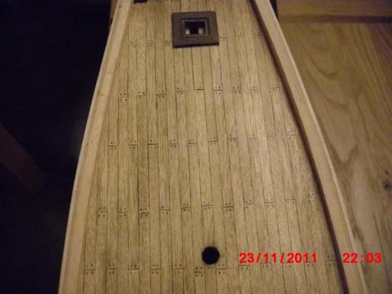

#368 Posted : 23 November 2011 22:15:32
ISSUE 40 THE HELMPORT

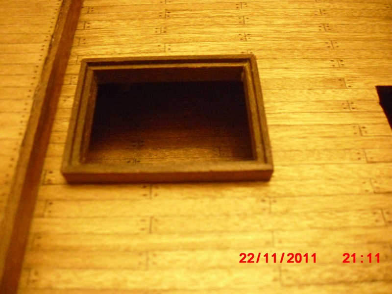

I have researched the wooden surround of the Helmport, I decided to enhance this area, first off I lined the helmport with 5mm x 2mm planking end on, I mitred it and made sure it protruded above the deck by 2mm:-

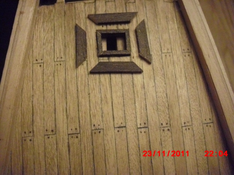

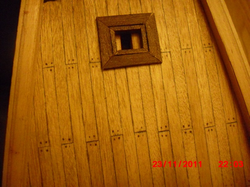

#369 Posted : 23 November 2011 22:45:25
Next I mitred more 5mm x 2mm and fitted it as per the previous photo, giving a more robust wood finish.
Your comments are welcome about this enhancementBigGrin Cool

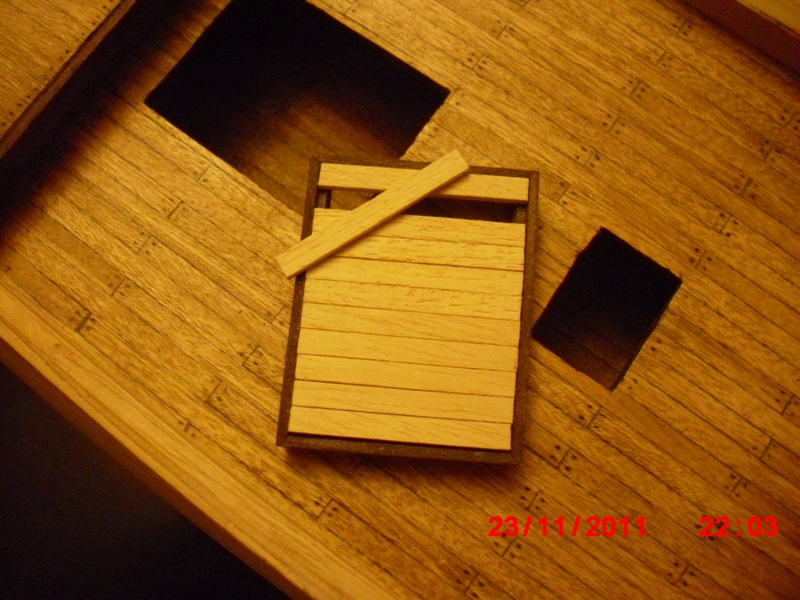

#370 Posted : 23 November 2011 23:02:39

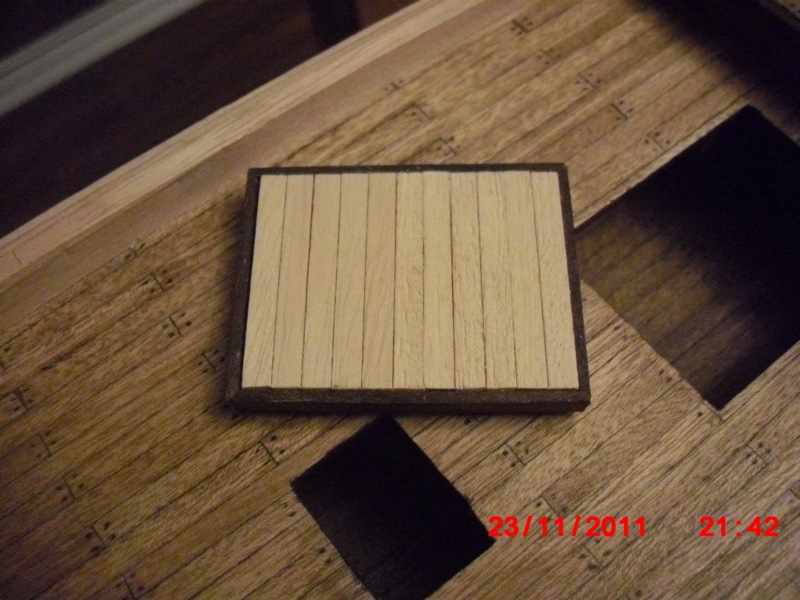

The frame was not stuck to the deck at this stage prefering to put it safe in a draw while second planking the Hull.
Again after research instead of fitting 7mm x 2mm I fitted 11 planks 5mm x 2mm I felt this was more in line with the scale of the ship, have a look at the photos, the wood has got to be stained, and give me your comments:-
#371 Posted : 24 November 2011 11:40:16
Not sure what the kit supplied version's looked like but your enhancements look good and at least they are closer to the real thing Cool

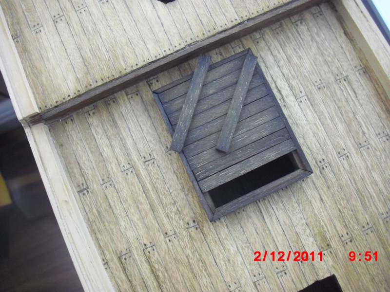

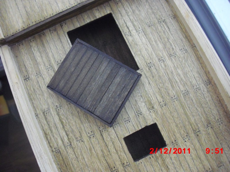

#379 Posted : 02 December 2011 10:27:50
Well the parts are stained now, all I have to do is fit the brass handles, the rings that come with the build I feel are out of scale, I will photo a few ideas.BigGrin
The Hatchway will not be fitted permanently untill after the second planking, and varnished at the same timeBigGrin
