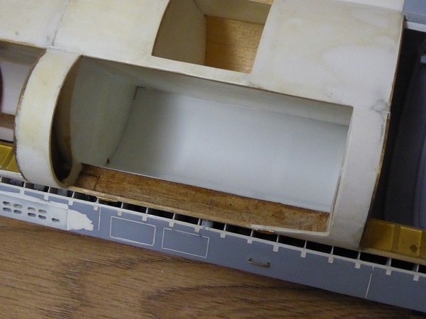

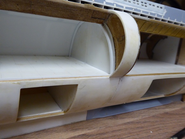

This image shows a closer view. At this stage I had begun to clean up the MDF supports

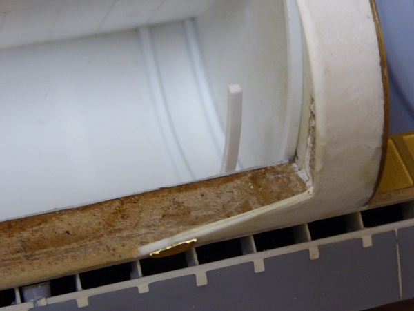

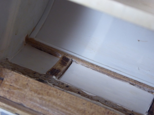

This photo shows the MDF support being sanded down so that it would run parallel. These part-works supplied supports came with a slight taper so this had to be reduced, especially on this section, as it was wider than the supports for the Control Room and Engine Room and I wanted it to match them.
#363 Posted : 21 March 2017 21:25:30

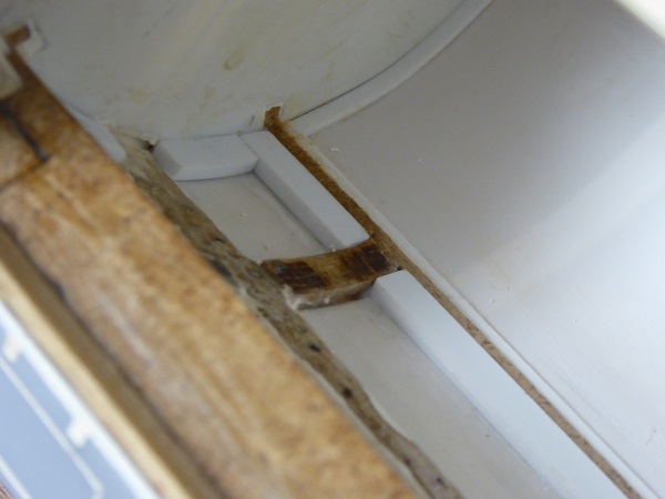

This image shows the furthermost support being given the same treatment as in the previous photo. For this fiddly work I had to wrap a piece of 100 grit sandpaper around a cut-down sanding stick to get sufficient access.
#364 Posted : 21 March 2017 21:26:49
This photo shows the furthermost support sanded down to the correct height.

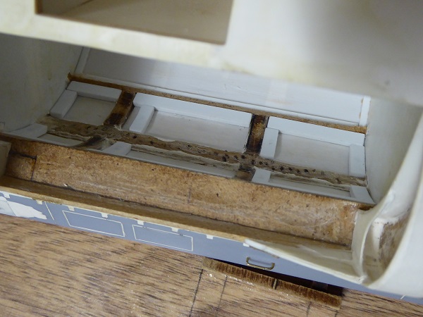

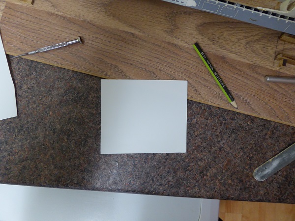

For the inner pressure hull to maintain it's curve it had to be supported so that it formed a strong bond.
I used 4.5mm wide by 2.5mm thick plastic strip. The attached photo shows a close up of one of these pieces.

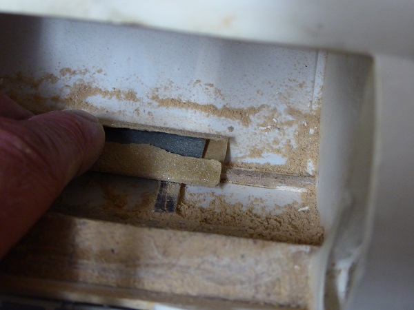

This photo shows how I started to build up extra supports for the inner pressure hull using the plastic strip mentioned previously.

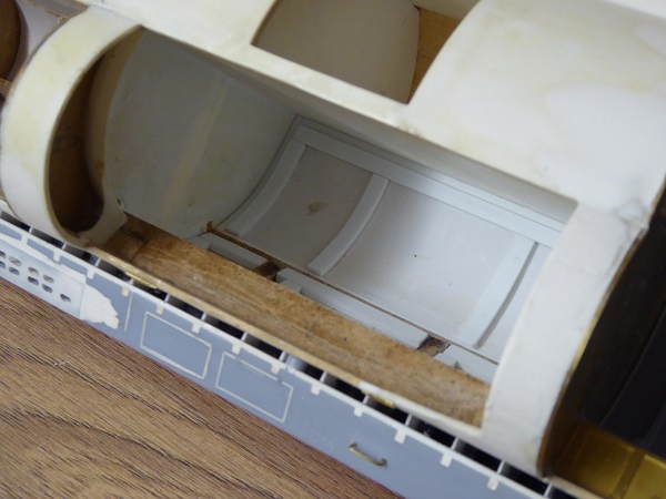

This image shows further plastic strip being fixed to act as inner pressure hull supports.

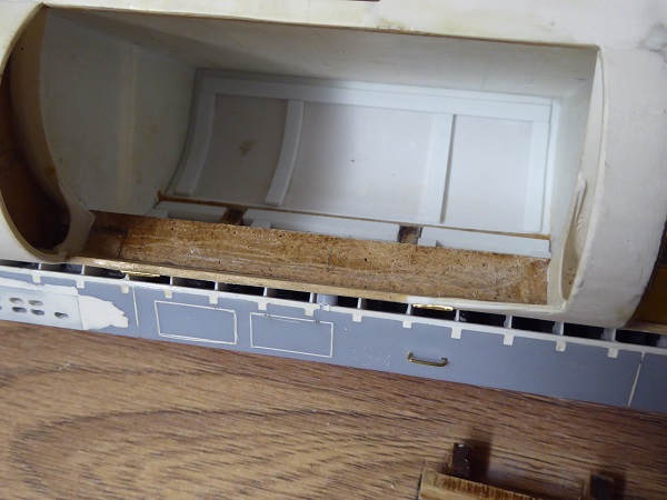

#375 Posted : 21 March 2017 21:56:15
This photo shows the U-boat now back up the right way with first of many 2mm by 2mm square plastic strips glued in place. By careful cutting I could spring it into place so that it formed it's own natural curve to match the inside of the pressure hull.
I chose 2mm square strip as this matched the dimensions of the t-frames [ribs] on the Engine Room and Control Room supplied with the part-works. You can just make out in this photo the ribs in the Engine Room.
