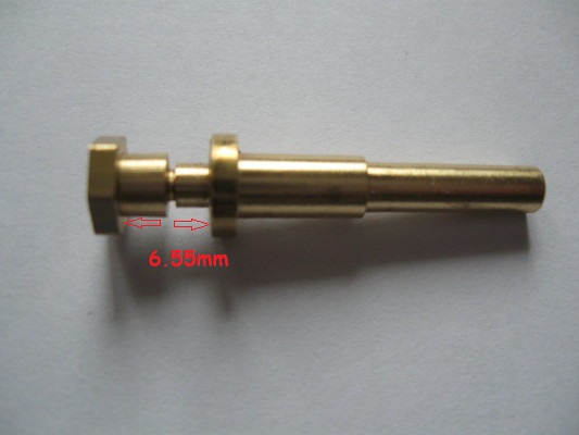

The prop shaft should not be loose at all, should be tight against the back plate, which should leave the crown loose, having rotational movement and approx 1mm back and forth movement.
When the screw and shaft are screwed together, the gap between the two inner faces should be approx 6.55mm as per the photo below.
It appears the screw you have maybe slightly too long, you could try reducing its length by the length of the gap you have, otherwise request replacement.
Once you have installed the prop's in the next stage you'll be able to check the gear movement and that the prop shaft should not have any movement upon the backplate (no washer needed).

Thanks for the information a great help, I have measured the gap with the screw tight and it measured 6.73 so I need to reduce the thread by 0.8 to obtain the correct gap. (cannot open pictures on your build)

On assembly of the Propeller Shaft to the back plate I found it impossible to get a tight fit as per instruction's, with the help of Mr T, it was pointed out that the gap between the two inner faces should be approx. 6.55mm mine was 6.73 which meant I had to reduce the thread by 0.18.
So my next task was to remove brass from the screw, which I did, but I could see that the thread was disappearing fast and unfortunately not resolving the problem, so I then decided to remove brass from the end of the Propeller shaft and this allowed the back plate to fit tight against the shaft, which has left the crown loose with movement as it should be.
Gap between two inner faces should be 6.55mm
Removing Brass from Prop-Shaft.
Prop-Shaft tight against back plate as instructions.
